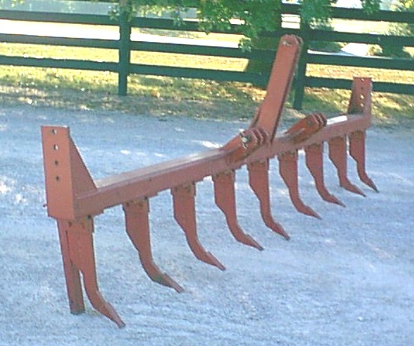

Here are 2 tools needed for good pasture management. A chain Harrow to spread manure and eliminate a breeding place for parasites and invigorate the existing grass stand and a Pasture renovator to aerate and incorperate new seeds into existing grass stands. Ken Sweet

Ken, the teeth on the renovator look the same as the front of my box blade. So could you just drop the teeth on the front of the boxblade, raise the back to tilt it forward and get the same results?

The renovator is designed to go up to 15 inches deep. You could do something shallow with a box blade tooth setup. Ken Sweet
