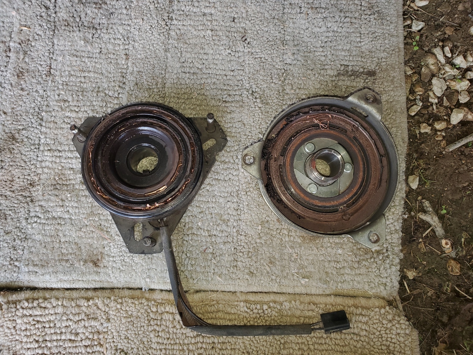

All,
Is there an online parts look up that I might be able to search for parts on for a 185 hydro? I believe it is a 1987 model.
The electric PTO clutch is out. I've done some initial diagnostics and have narrowed it down to the clutch. I have not removed it, so it is conceivable there is a wiring issue from the connector back to the coil that I haven't discovered yet (I did not check the resistance/ohms of the connector on the clutch side, just voltage at the tractor end of the harness).
If it means anything SN is M00185B450271
If I can see the assembly down there in a diagram that will help before I proceed. It looks like the bearings are replaceable also - it might be advantageous to replace them, unless a new clutch comes with them (another reason a diagram/break down would help).

Before you throw money at it you should test a few things first.
Measure the resistance of the clutch coil while it is disconnected from the tractor. should be between 3.5 and 4 ohms.
Measure the voltage going to the clutch with the clutch disconnected and pto switch on. should be battery voltage.
Measure the clutch air gap. this is explained on page 40-05-1 of the service manual posted above.
If the air gap is to large the clutch will not work. magnetic force cannot overcome the large air gap.
hope this helps some.

A couple more tidbits - the clutch quit mid-cut. I mowed about 1.5 out of 2 acres and the blades shut off. I reset the PTO switch and the clutch engaged for about 10 more seconds, then quit and has never come back.
Of the checks mentioned - I have not checked resistance or air gap. However, since it was running fine, came back briefly, then died for good - Id say the air gap is fine.
The issue is more than likely electrical. The question is where - wire or part of the coil itself?
When I get a chance to be home with some time to do so I will dig in to it deeper. In the mean time I have a new/aftermarket unit coming. Better to have on the way and possibly stick in a shelf to have on hand for later than to need it now and not have it.

I had my Jd do the same thing I adjusted the air gap and it works fine

Windings desintegrated. Id say its toast and Ill need the new assembly.
   / Parts look-up, 185 hydro PTO clutch #10
That clutch is toast. It looks like it might have been slipping for awhile and ground away the friction disc.
