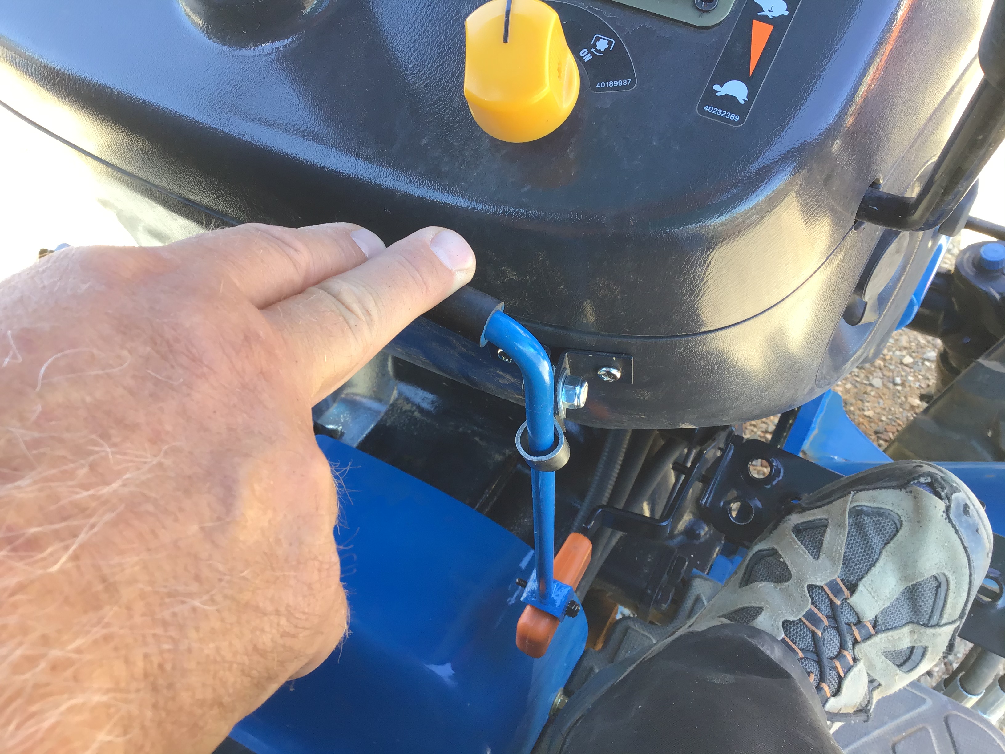

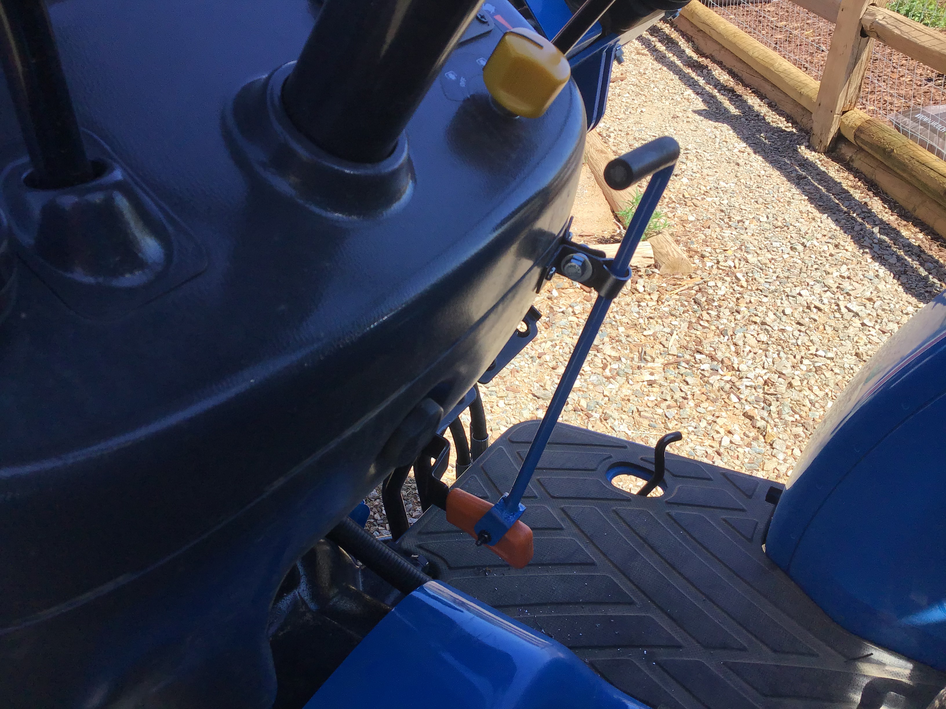

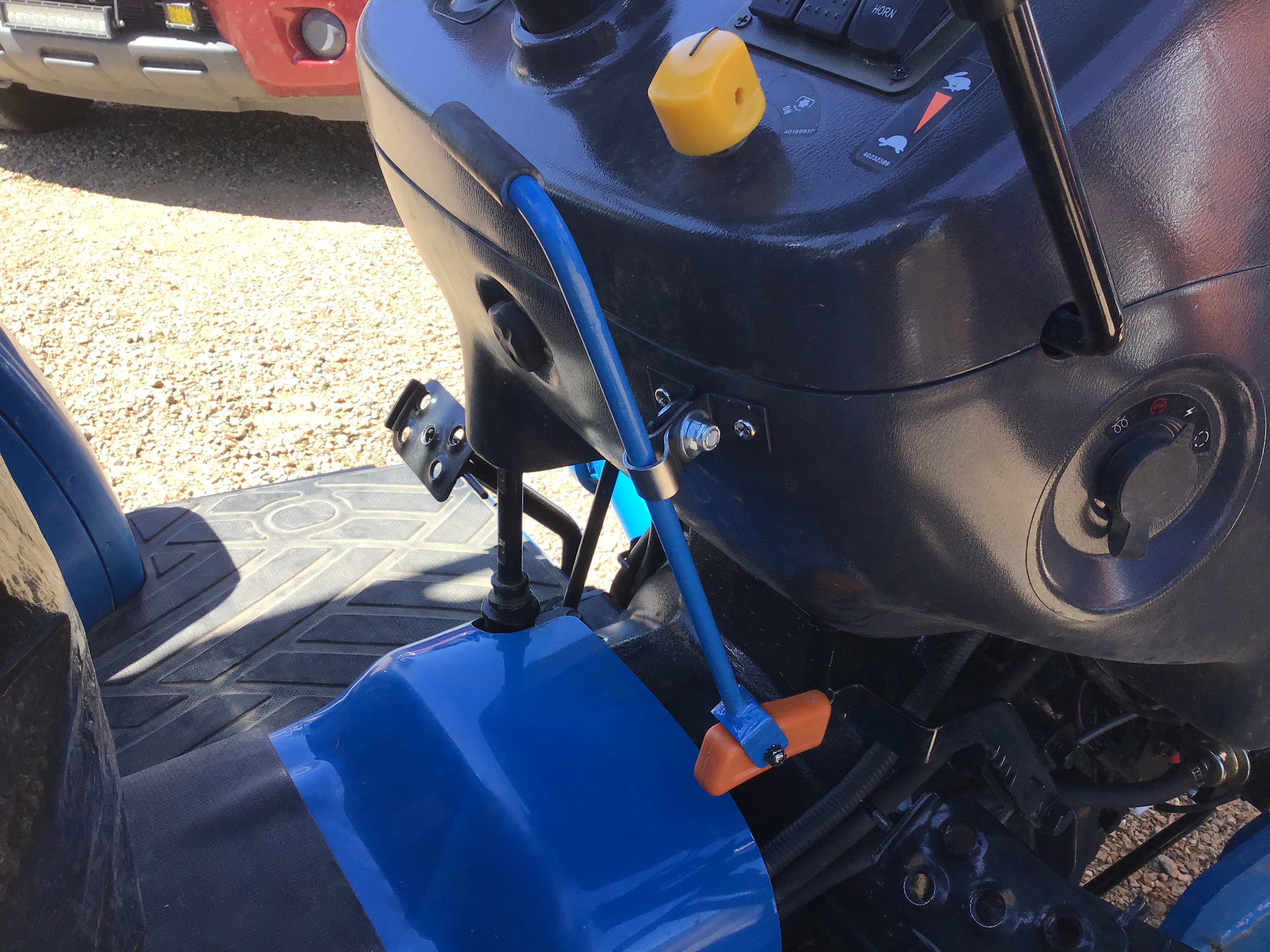

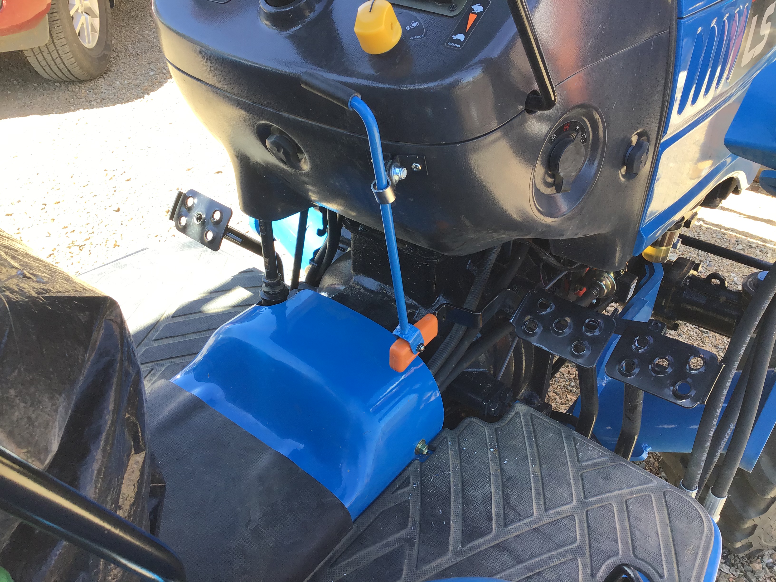

The parking brake lever was always a pain to reach down and set, especially after I put on an aftermarket seat that is 4" higher.
So, with material found laying around the shop, made up an extension. Now I can set it from just reaching to the dash.
It works much, much easier!

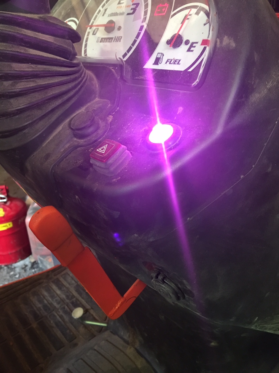

One of the best modifications I did to the Kubota B26. Brake on warning light too. Helps keep the peace between my wife and I using the tractor.

Good job on the extension, looks factory almost. I'd like to know how difficult/complicated it was to add the light...I have a brake light on the Kioti dash, but guess they deemed that a luxury item...
   / Parking brake lever extension #9
Brake light for B26 was easy. Kubota already had a bracket with hole perfect for a universal motorcycle rear spring switch under the dash. Had to drill a small hole for the spring on the lever to link to the switch. Then find a key “on”hot wire for power. Lamp was LED trailer marker light.
   / Parking brake lever extension #10
Thank you.. I'm assuming you mean the rear switch that activates a motorcycle rear brake light?
