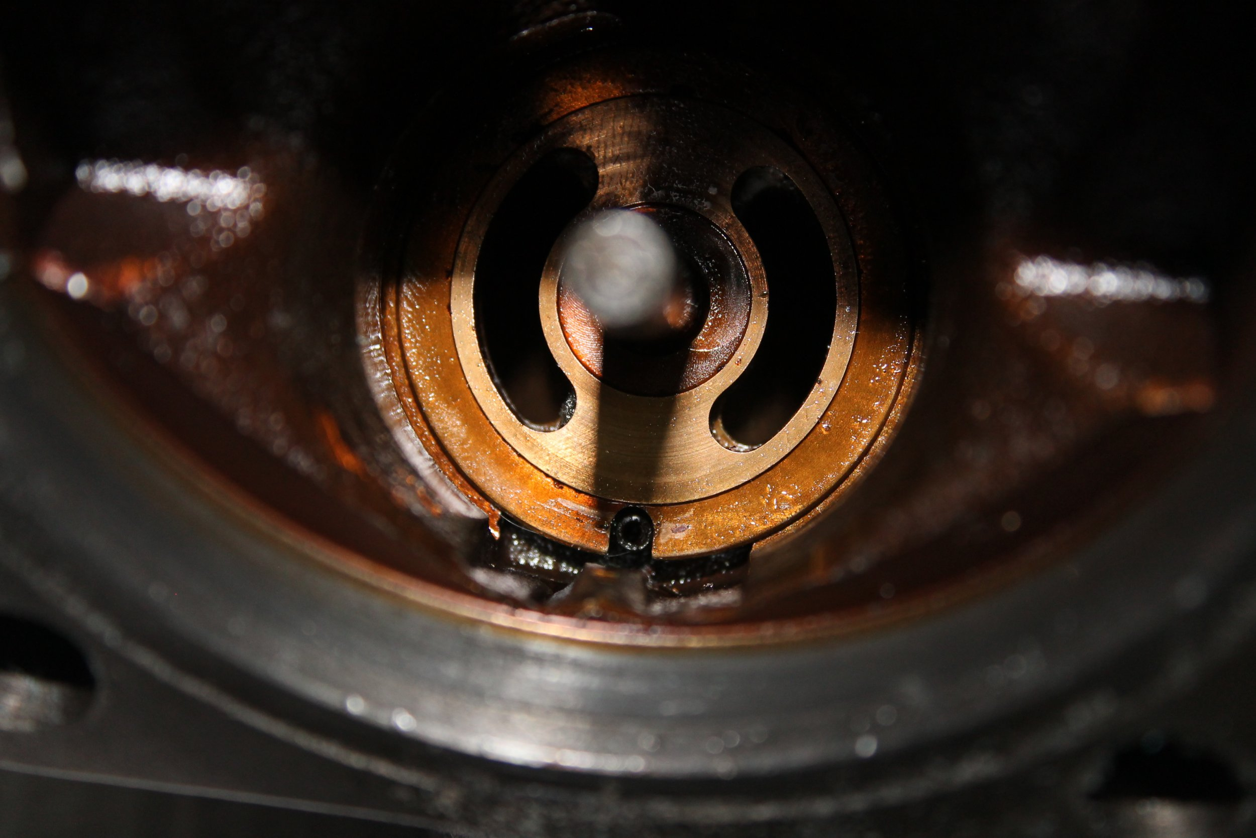

I have two F11 motors too. I'm using one as a pump and another as a motor on an homemade flail mower.
The motors are fairly simple piston motors. The tricky part is putting it all together while aligning the pistons on the bores at the same time. Don't force it. I've broken one of the pistons doing so, luckily I had some spares.
Another key thing is that there is a brass thrust washer at the bottom of the housing where the hydraulic lines connect too. This washer has a slot that needs to align with a spring pin.
I had another F11 brought to me to take a look because it was jammed and would turn at all. I took it apart and found out that someone didn't paid attention to the washer and it was sitting on top of the pin, so everything was just getting pressed and jammed together. Don't even understand how everything still went together somewhat ok. I guess impact guns do wonders.
I think this is a good view of the washer, slot and pin.
