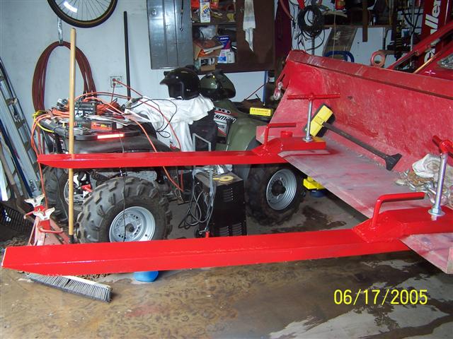

There have been numerous post about forks...Here is a LINK showing pictures of the set I made.

I made my own for cost of materials (30$ or 40$) and my time

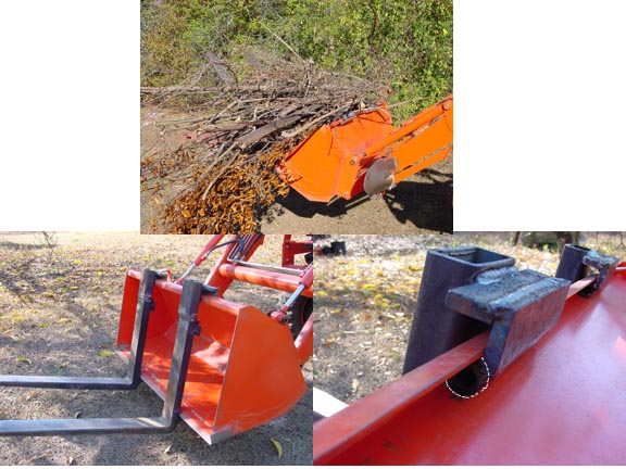

I did not have a frame for my forks. They are from regular lift truck. We just added to the top and I curl my bucket to catch the round pipe then "un-curl" and my forks are ready for use.
I am able to vary spacing with this setup.

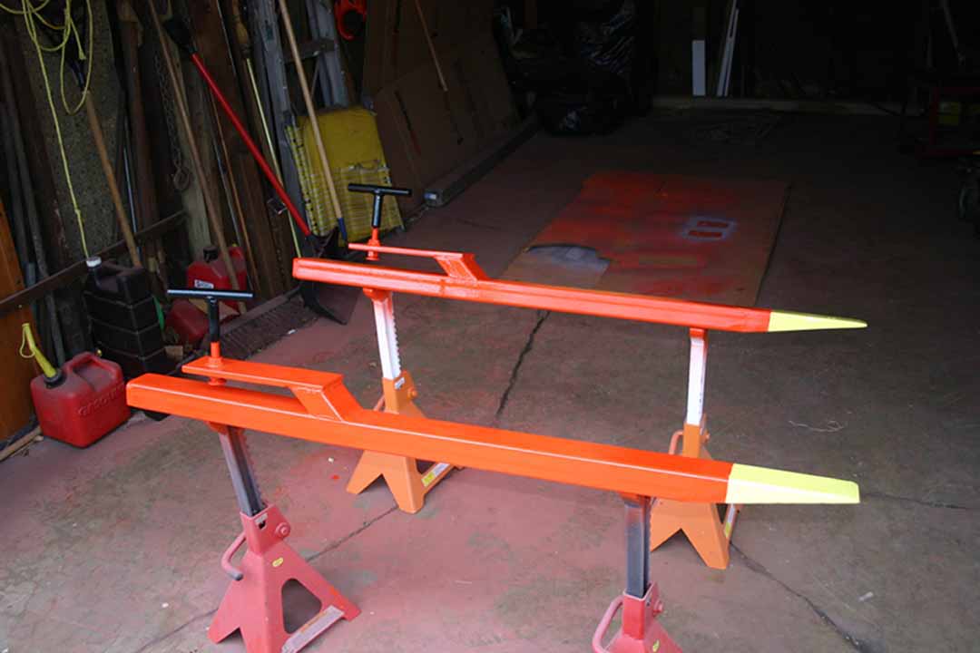

I built mine from C channel I obtained at the local scrap yard and misc. threaded rod from TSC. Total cost about $40. They will habdle more weight than my bucket can lift so I'm satisfied with that. I would have used regular forks from a forklift and used a pipe along the top then welded hooks on top of the bucket to hook into but couldn't find any in my area.
George

That's a VERY nice design, gotrocks. I haven't seen this done before.
Good job! /forums/images/graemlins/cool.gif
