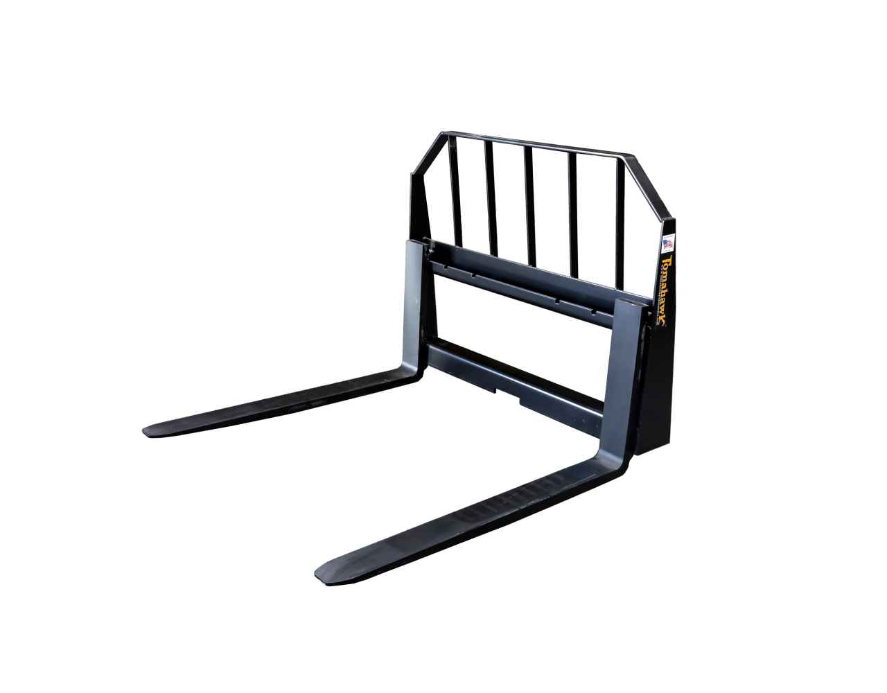

Kicking around investing in a set of pallet forks for my B3200.... Looks like there are droves of them to consider so I was hoping for some hands on advice about quality.... 1,500 lb capacity would probably suffice... Who has purchased these & would you recommend them?

I'm one of those who won't use the bolt-on type. They put the load too far out beyond your loader forks so that it bounces easily and also reduces your lift capacity. Also, depending on what you are picking up it can roll up your bucket and into your lap... of course you could always build a backstop to prevent that.
I have the lowest priced Titans, which I have destroyed through abuse. :( A member in another thread suggested these; https://s3.us-east-2.amazonaws.com/...-Forks-4_1049d7329a87b88b49ec13ec6b64037a.jpg
I've been looking around for a while, and they seem to be the most reasonably priced that I can find. Plus they're Made in USA...
