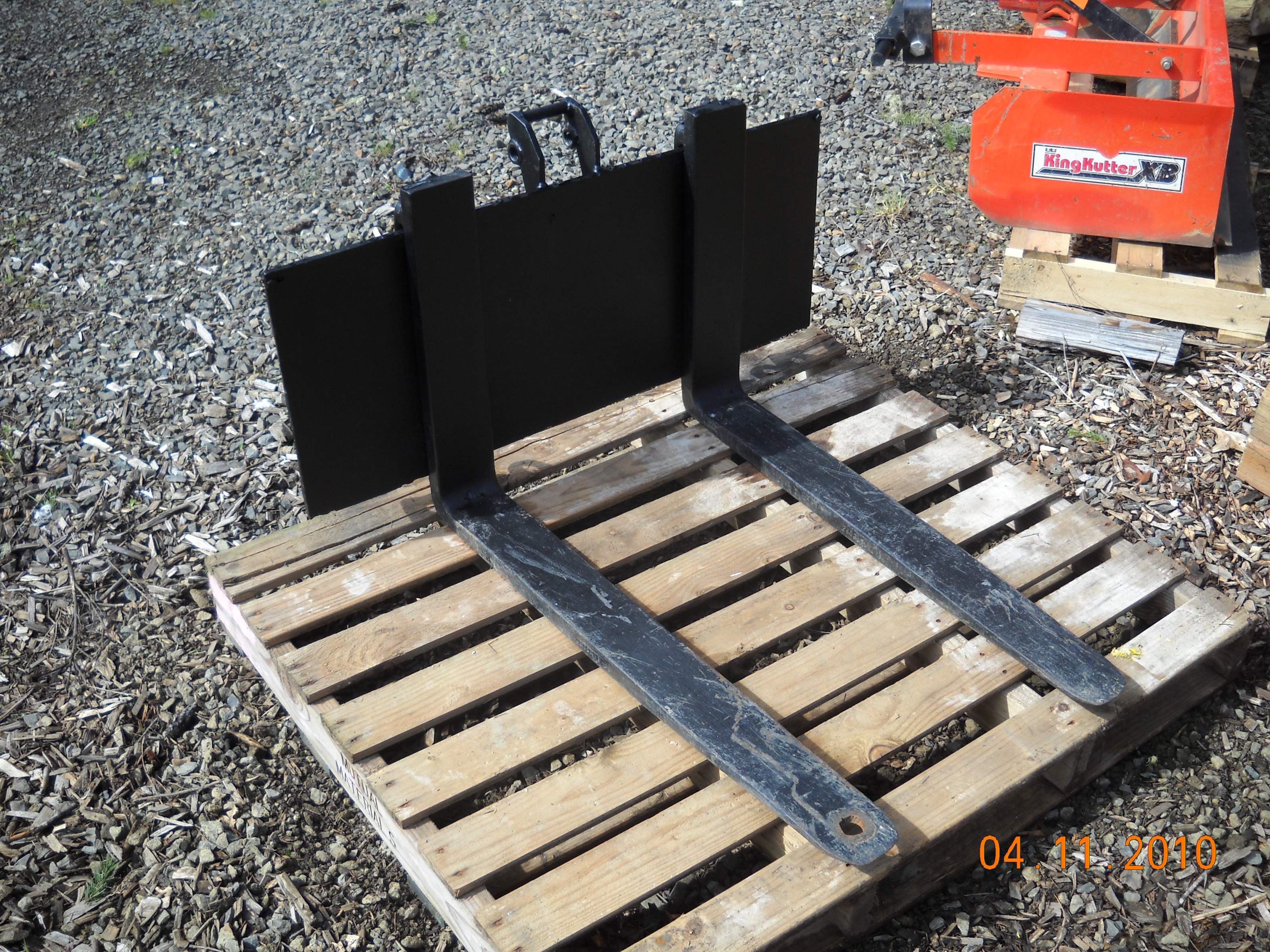

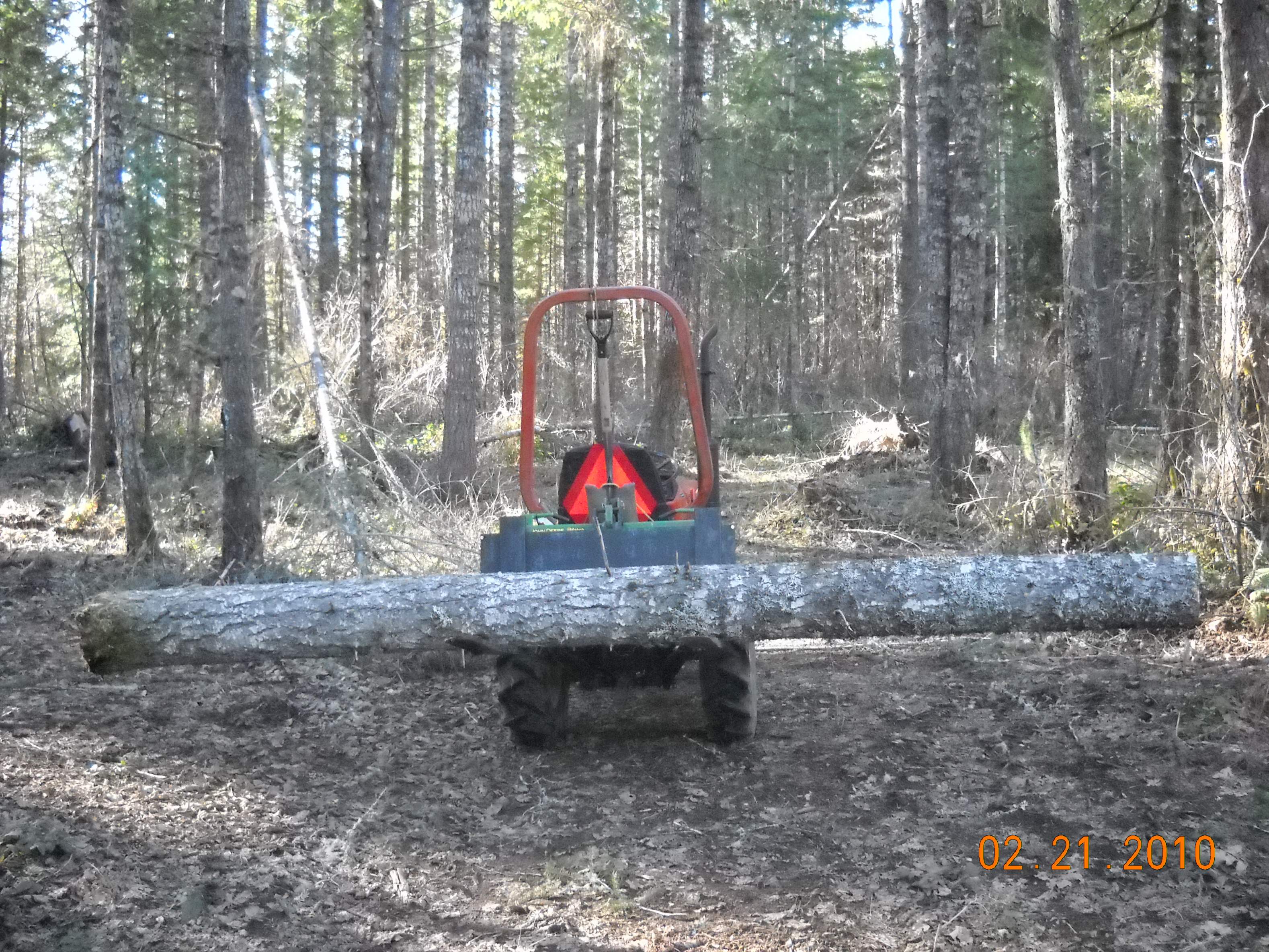

Amazingly enough, these forks i refurbished can handel up to 4000 pounds easily. How? I had them on the back of my Dad's 3720 and moved trailers and pallets around with them. One trailer i moved had atleast 3500 pounds or more of weight on it. The trailer was full of trash, concrete, and masonry stuff. I was suprised at how strong they were. They originally were used on my Step Mom's Bobcat skidsteer and when she moved out here from utah, sold the Bobcat and ended up bringing the forks with her. Last summer, She decided it was time to get rid of them by scraping them but instead I got them and now they fit on my Yanmar tractor. Long story short, I may never bend these forks when working with my Yanmar.
