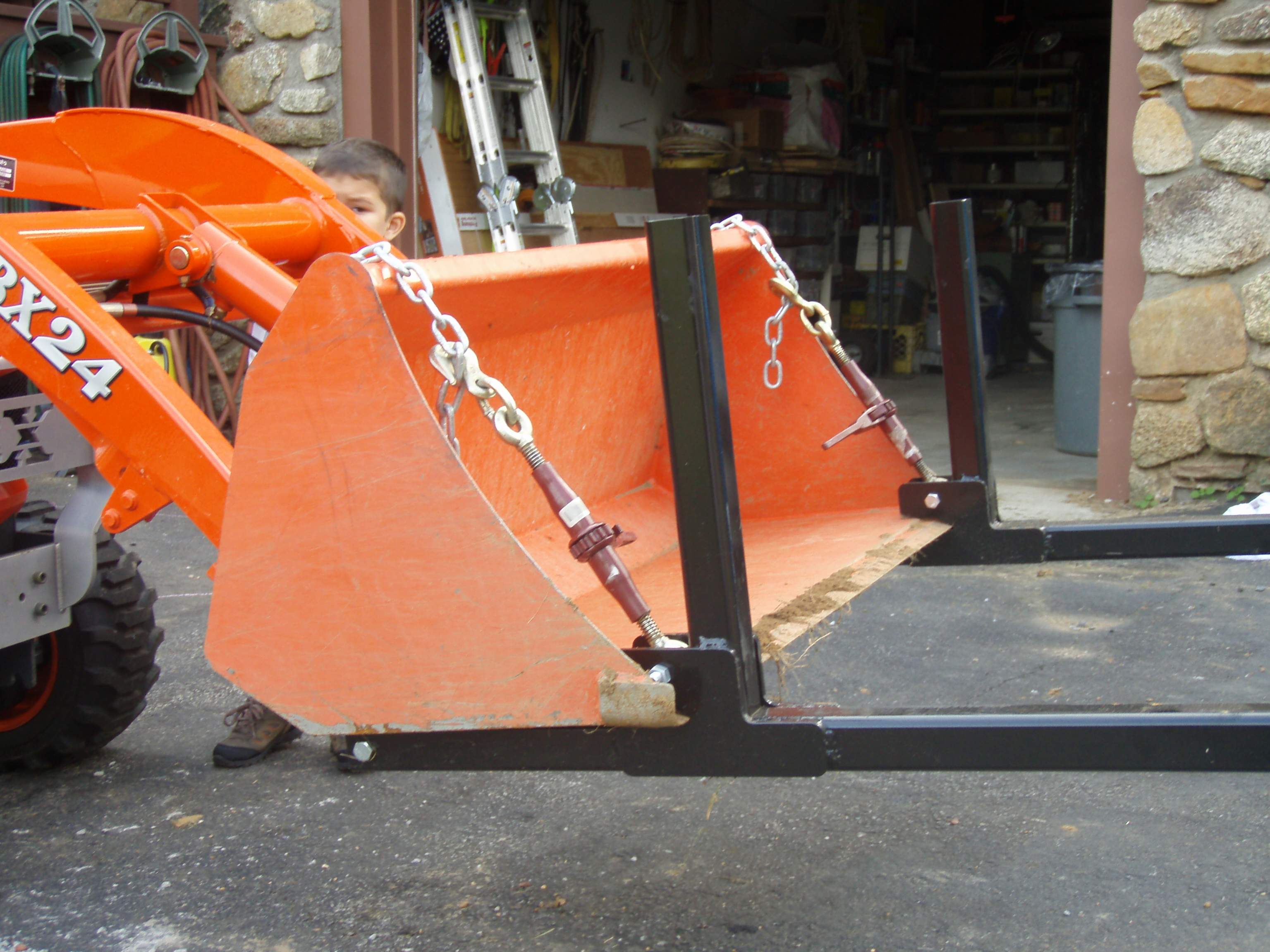

I'm thinking of making my own L-shaped pallet forks from square tubing (vertical part of the "L" clamping at the top of the bucket and the horizontal part resting on the bottom of the bucket). Do folks here have suggestions about what size and thickness of tubing to use? I'm thinking 2" A36 mild steel square tubing 0.12" thick. Does that sound reasonable?

My home-built clamp on forks are made from 2x4x1/4 rectangular tubing. Mine are straight and extend from the cutting edge (with a pocket for the edge to slip into) under the bucket to the 'heel' then are chained & bound over the bucket. No weld joint in the fork.

2" x 2" square tubing with a .120" wall will not make for much of a fork. It would probably be good (safe) for 200 lbs or so about 18 inches beyond the front edge of the bucket.
If you want forks that can handle roughly 800 lbs (per two forks) use 2" x 2" x 3/16" wall.
For 1200 lbs use 2" x 2" x 1/4" wall, for 1600 lbs use 2" x 3" x 1/4" wall, and for up to 2000 lbs cpacity use 2" x 4" x 1/4" wall steel tube.
Thes numbers mean nothing if the rest of your design is not done correctly, or if you have bad welds! Attached are some pics of a few forks I have built in the last few years. I had one set of 2000 lb forks come back.....they had been modified to fit a John Deere comercial backhoe/loader, and they lifted a 4500 lb pallet of lanscape blocks. These forks were 2" x 4" x 1/4" wall, and they did not break with this load, but the clamp mechanism bent. I repaired the forks and explaining what the rated capacity meant....and sent him on his way. (I have good insurance!)

You are correct for the most part as the sidewalls of the tubing are the primary strength for thr vertical load on the forks. The thicker wall (in tension on the top and compression on the bottom does add a small amount of strength. The thicker sections provide for better strength in the areas where the clamp asssembly is welded as well.
All of my forks will easily exceed the ratings, and are periodically tested with weights suspended from the center of the usable length of the fork tine......so you could say that the ratings were developed by trial and error, which included some bent and broken forks!
I would have no issues with lifting approximately 30% more than each set of forks are rated at. Fortunately, most compact tractors can not exceed the cpacity of the forks. The design is not perfect, however it makes for a very cost effective fork for the occasional user. I would not recommend them for anyone that has a lot of forklift work to do.
Jim

The reference is my trial and error testing, and the 80 or so sets that I have produced over the last 3 years! If you need further details to determine proper sizing and strength to build forks, I suggest talking with an engineer that can calculate the load and the stress. There are many factors to consider in building forks....the load bouncing, the load centerline, the fork length, the strength of the FEL and the bucket, the strength of the clamp design, the integrity of the welds, etc. If you are building forks for your own use, just be careful with them....especially if you are not 100% sure of your welding skills!

The clamp on a clamp on fork should not be taking the load....rather, the shape of the clamp assembly ahead of the clamp should be load bearing. On my design, the forks will lift the full rated load without tightening the clamps.....the clamp bolts are only there to hold the forks on the bucket.
