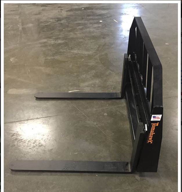

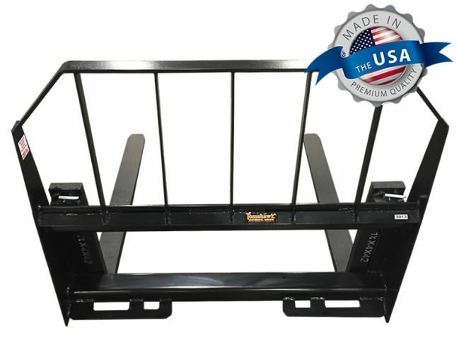

Can't tell from their pictures, but doesn't look like they have much, if any extra rollback built into the frame: Tomahawk Attachments :: Tomahawk Fork Frames

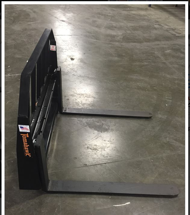

Look comparable to EA compact pallet forks. EA list $617 and are 60 something pounds lighter and includes shipping.
Tomahawks are $407 + shipping and 60 pounds heavier.
I can't really tell if either have built in rollback. Is it necessary to have it built in rollback. I would think that the builders of pallet forks would include it in there design. It is after all the business they're in.
I am in the market for pallet forks too. I have a little over 1400# lift capacity so the weight of the forks matters. I ran across the Tomahawks in my search, although the price is appealing I think I will go ahead with the lighter EA forks.
Haven't seen the Tomahawks mentioned before so I just thought I'd toss it out there.

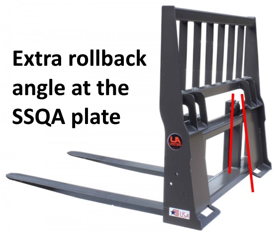

Looks like the EA light forks do not have extra rollback:

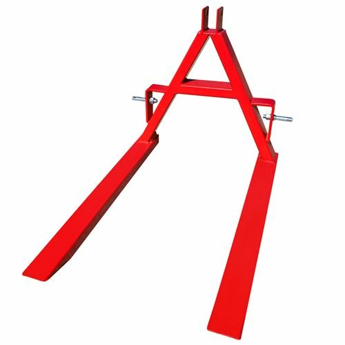

Agri supply 3 point pallet forks 2000 lbs capacity $199. Pretty good price72511.jpg

Rollback is how far back towards the tractor you can tilt your bucket/forks/etc. Some forks have a little rollback built in, so basically when the forks are level with the ground, the SSQA plate is tilted forward. You have the same total range of motion with the implement, but a greater amount of that range is pointing up, rather than down.
On my MX, with the fork tips a foot or so off the ground,i can tilt the forks back further than vertical. Mine do have built in rollback. I've never wished them to have less rollback, and I'm very happy that they have the built in rollback that they do.

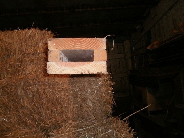

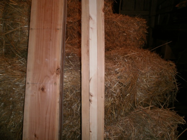

P2080012.jpgP2080013.jpgP2080014.jpgIf you have shorter pallet forks and you want to haul bales, you might try some wooden extensions
