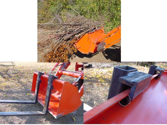

Here is how I have mine set up.
Got a set of regular forks, weld 2x4 steel tube to the top then weld the "brackets". Cut 2x4 stud to stick into top of tubes.
Set forks on the ground, curl the bucket all the way down, ease up to the forks, set the top/curl of bucket under the brackets, "un curl" the bucket and the forks are ready to use.
This arrangement allows me to change the space between the forks as needed.

Gotrocks,
Nice setup! I think I am going to take a welding class this winter so I can begin making "stuff". I will have to check out my bucket, but I don't think I have the same lip on the top that you do, so I would have to figure out another "bracket" to create. I love it though.
