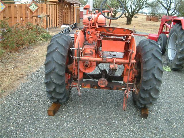

Scott_VT - If I'm not mistaken, isn't that a picture of a Farmall Super A? My dad had both the cub and Super A and the picture you show is from the rear of a Super A, if my memory is correct.
Great looking tractor. I miss the one my dad had. It was so easy to service, etc...
Thanks for posting the pic.
Roger

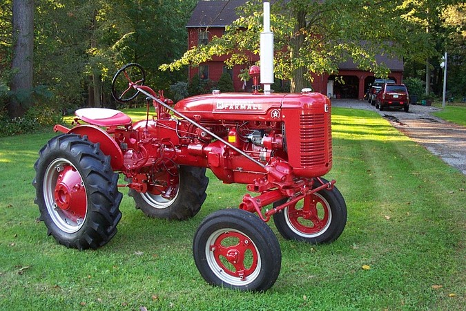

Here's my 1951 Farmall Super A with it's 3pt hitch
And my 1948 Farmall Cub
Roger
Good Evenin Roger,
Yep it is and thanks ! :)
Wrong on that one! nice looking super A , I'm corrected!
Good Evenin tcreeley,
No problem, if you had a picture of those two tractors side by side, the Super A looks like its on steriods compared to the Cub ! ;)

Good Evenin Roger,
Scotty, I love that side view of the Super "A". Did you restore it? If yes, you did wonderful job.
If I'm not mistaken the only difference between the "A" and Super "A" is the hydraulics. The "A" did not have hydraulics, correct? Roger
   / Painting and working on old tractor #30
Good Afternoon Roger,
Yes I did and thanks so much on the compliment ! ;)
Yes the only real difference is the touch control hydraulic unit under the fuel tank. I also rebuilt that unit durring the restore, it was about $100 for the rebuild kit from Case IH dealer...
