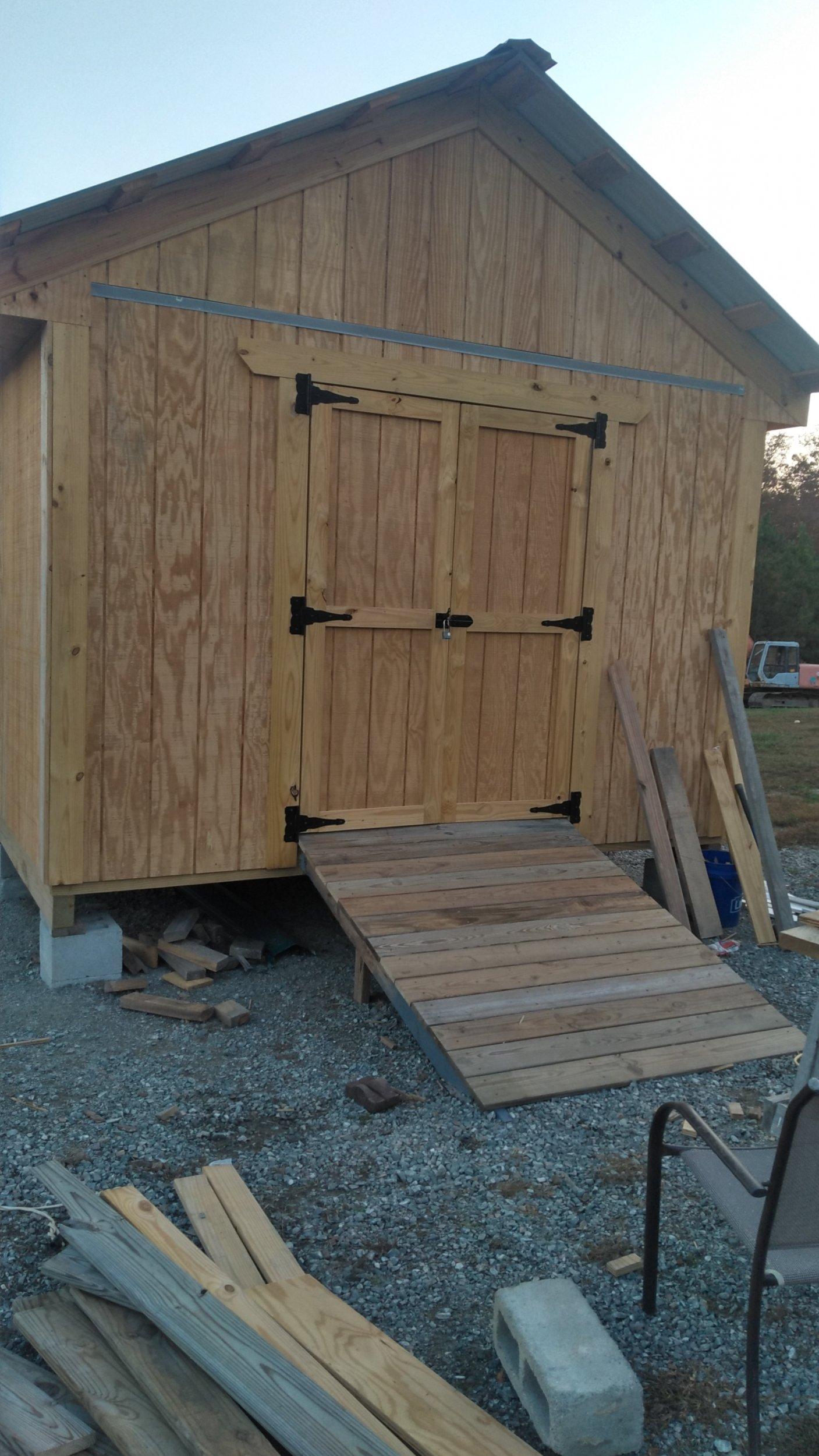

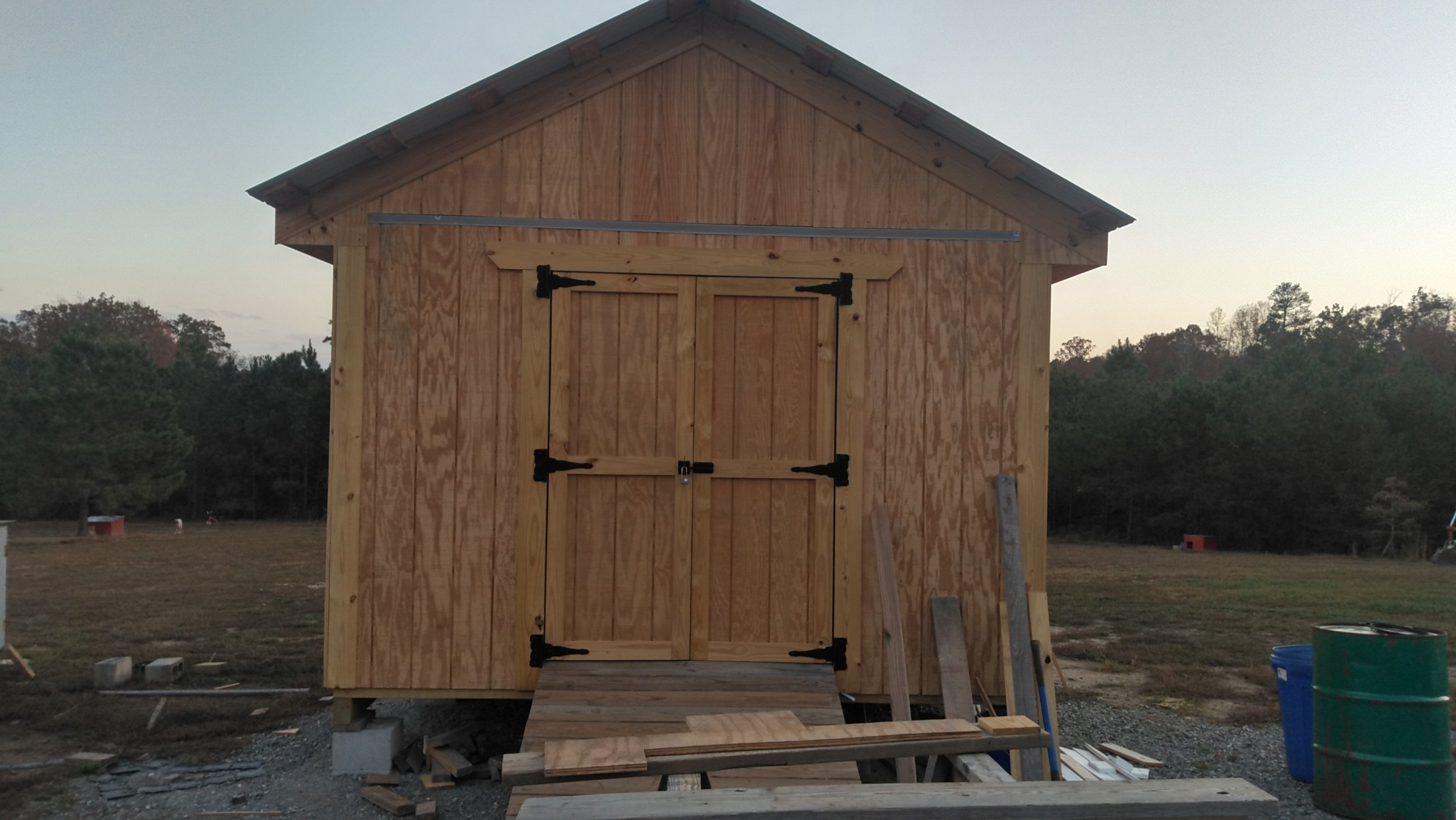

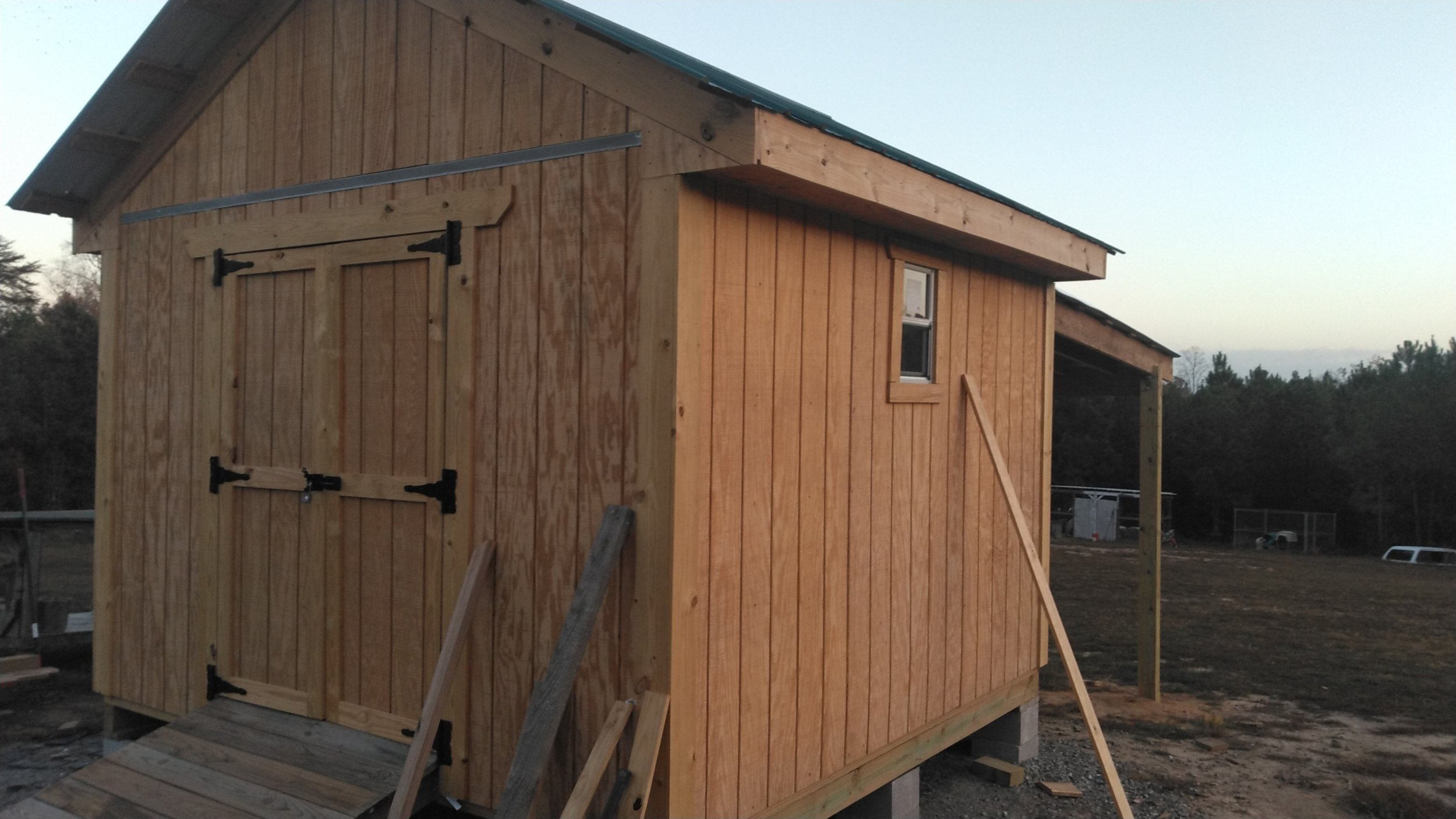

So, I finally finished the actual building of my shed. It was way more involved than I ever thought. This is the FIRST shed I have ever built. I made mistakes but overall I am happy with what I did. It is solid and not going anywhere. I am also glad I built the lean-to off the back of it now rather than later. If I had not done it now, it would probably be another year before I got around to it. I definitely learned a LOT and the next one I build should take only half the time. I used screws on the whole thing and SPENT a ton on screws.
I am going to share some pics of it and sure I will get some "why did you do that?". My answer is "because I didn't know any better". :ROFLMAO: Now I have to figure out what to paint it with. I appreciate all the responses in here and will go back and re-read everything.
