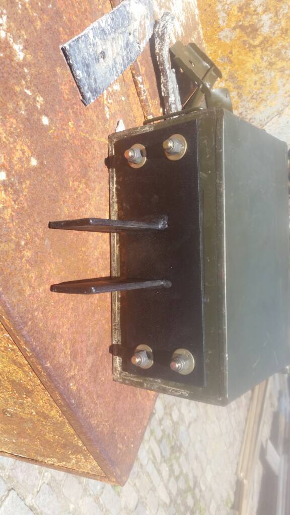

This was several coats of the bedliner.
If you want to paint, get the Eastwood 2 part epoxy primer. $20 a can, but you need a grinder to get it off if you prep right.
