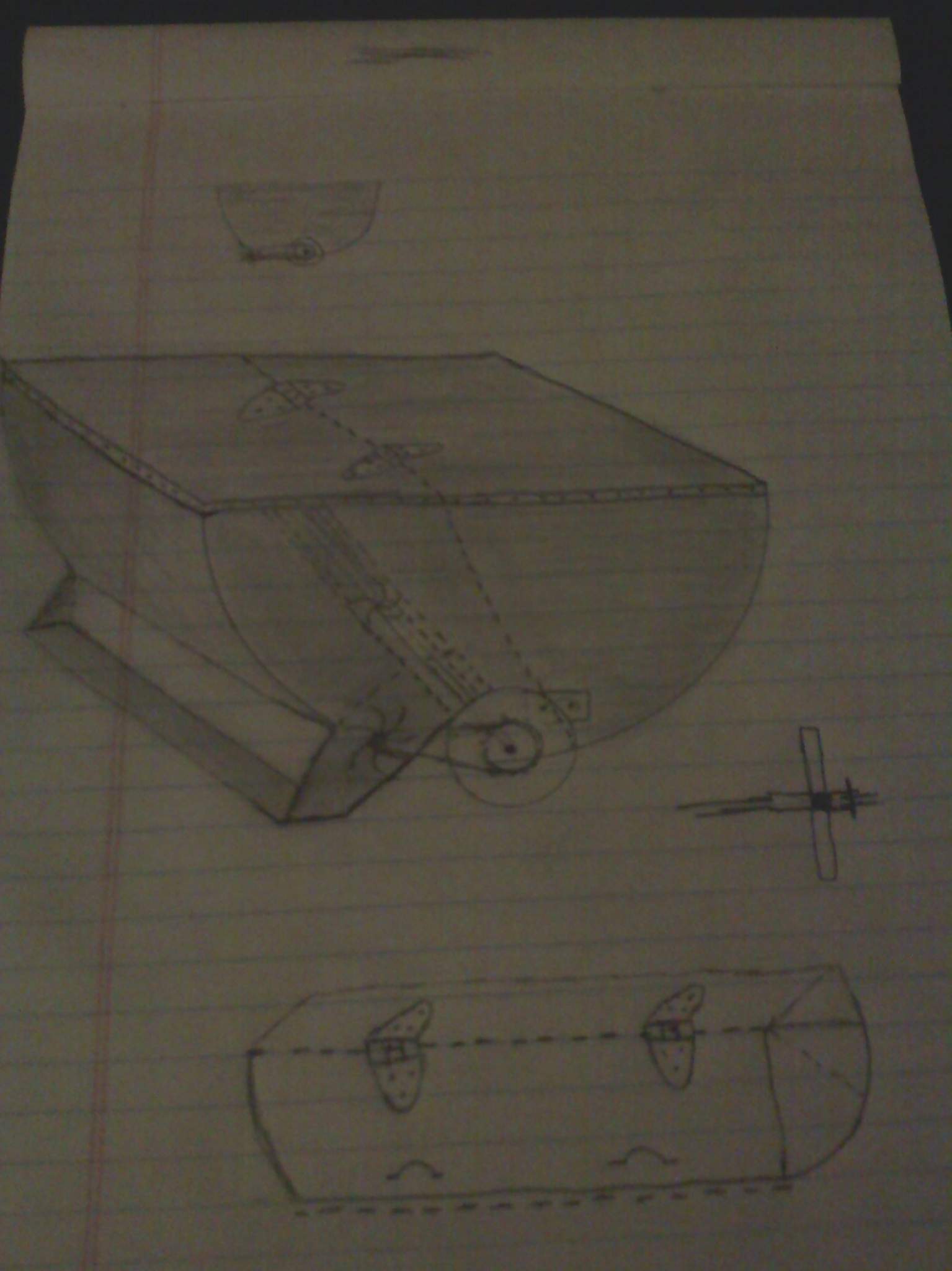

Hello all,
Here is a pic of what i have drawn and should work???
Looks good anyways LOL.
BE SAFE Carl

I've never seen such a thing. I'm guessing it works like a lawn sweeper? In your design what keeps the manure swept into the barrel from falling back out the bottom?

hello Johninct,
I have been mulling this over few weeks now and have thought about many ways to keep manure in barrel.
One way is to make sure rubber sweep and a rubber flap line up at center of sweep.
Other is to use a piece of metal as a trap door it will stay open when rubber sweep is turning and close by weight when gear is not engaged.
I have no sure plan for this and may redo parts of it as we build it but. I already have all Materials to build it so why not try.
