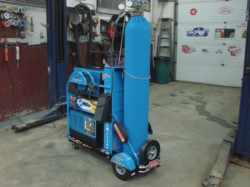

Man I got to tell you that you got one nice slick looking cart. I never thought one could take an old hand cart and turn it into something cool plus functional like that. As for the color of the bottles. When I built my "Crazy Cart" I made a sock to cover the Argon bottle.
Great job there buddy. Love the outcome. Oh. I have orange paint left over from a job if you would like to have it :D;)
