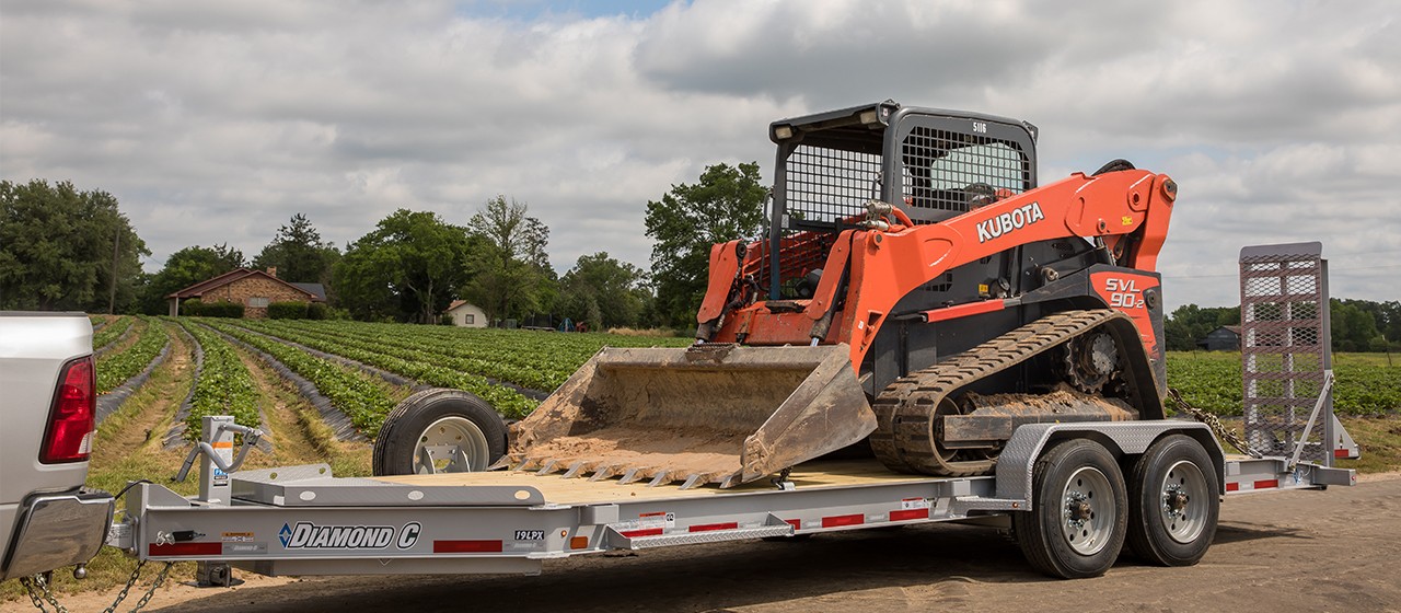

May or may not be a concern for most on this forum. Low profile between the fender style trailers are typically 81-82 between the fenders. A lot of equipment like my skid steer is 84 wide leaving your only option as a deck over to haul it which means steep ramps. Legal load width is 102” A couple manufacturers are making low profile trailers that are 106 inches wide and give you 86 between the fenders to load this type of stuff. Technically they are illegal without overwidth permits but a lot of guys run them under the radar. What are the odds the DOT is going to think a trailer is 4 overwidth or even think to measure it or notice it just by looking? Curious everyoneç—´ thoughts on this. I have no idea what the overwidth finds are but have been thinking of buying one.

Eh, I'd run it. But I'd take the name off the trailer just in case the dot has gotten wise. They do make drive over fenders although I don't know how it would work with a heavy skidsteer. Maybe one of those with some 4x4 dunnage secured down would be a good option?

Bear in mind that the 102" is the federal limit for interstate highways. In other words, you can travel anywhere with that 8-1/2 foot wide thing, if you stay on (and likely near) the interstate. But as soon as you are off of the federal highway, you may be in for a surprise—twenty minutes south of me, across the Kentucky border, 96" is the law, except on federal highways. It's that way in several states. I know we picked up a car in KY with a trailer that was a full 102". Nobody looked at us. So it's likely not used as a primary offense. But YMMV.

DOT truck inspector here in NY, here an inch is an inch. Your parked until u fix it.
