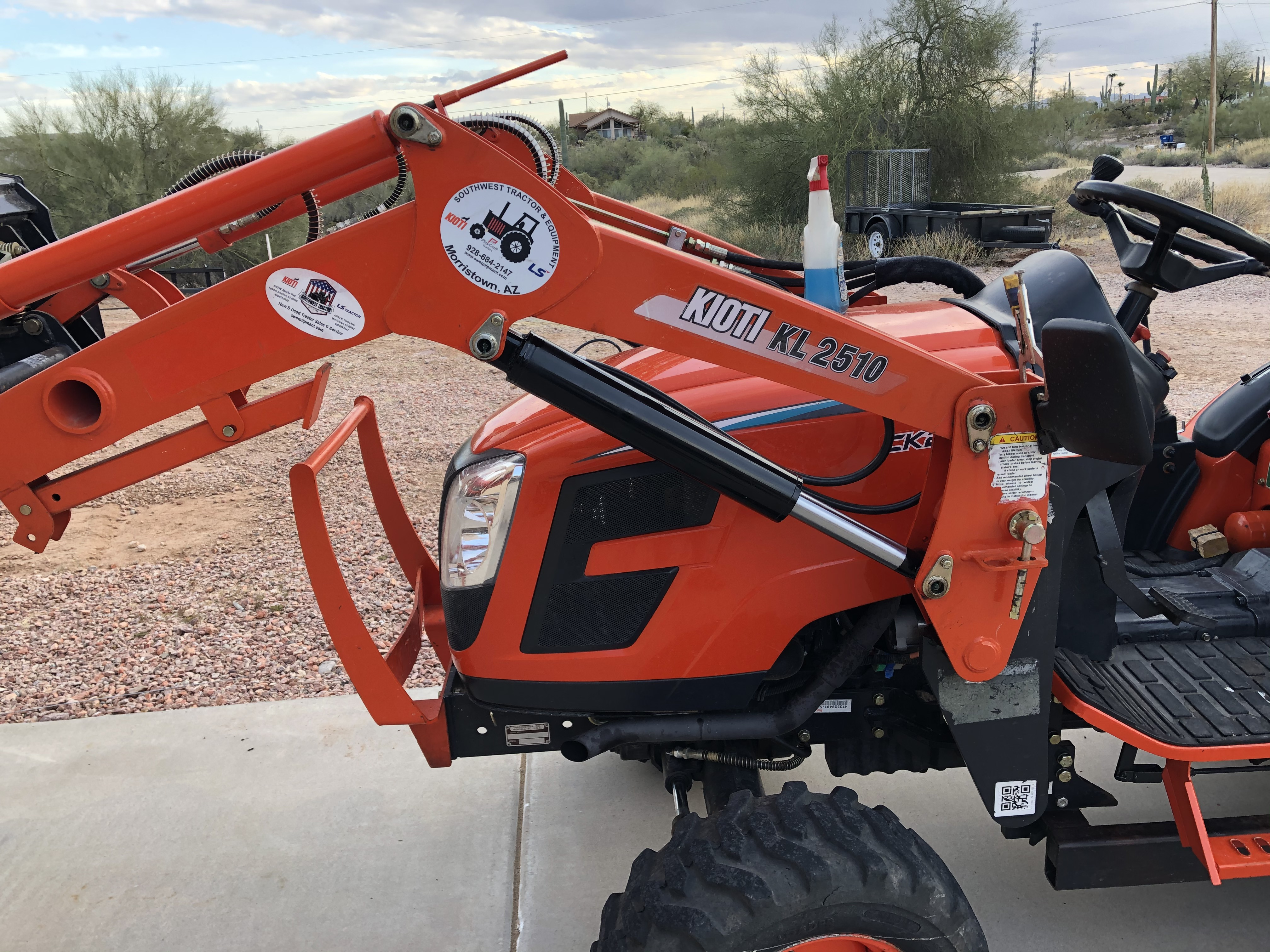

I really had no use for the larger ck2610 and while researching I had thought the ck2510 would handle a heavier pallet than it actually could
hydraulic wise not counterbalance since having a backhoe makes that a non issue
the only reason I needed a little more FEL lift is once in a while I can rent my tractor out to my company instead of renting a forklift
but after trying a few things around the house like loading a 600 lbs safe into a 2' high trailer and just barely getting it up high enough
and then trying a few pallets with 400-500-550 lbs to see how high i could go I realized that this was not going to work for unloading pallets from a semi
I did bump the hyd psi by 250 psi but no help so I started looking around and found some Magister ready to ship 2.5 cylinders with a 12" stroke that were close to what I needed , I had to cut off and reclock/space the end tube and the worst part was the sae to british threads I had to get new lines made to do the transition
anyway when I was done there was not one of those pallets I could not lift to 50" with ease and even lifted the front of a vehicle off the ground that I had tried before and couldn't budge
we should all know this kind of modification is at your own risk, and you really need to pay attention to ballast and front tip potential not to mention you may be exceeding other structural limitations as well and the whole FEL assembly could collapse and impale you.
lift speed and lower speed was reduced minutely , but I always thought it was too fast anyway and this is more controlled
my tractor has 340 hours and I just bought it so I do not know if lift capacity has diminished since new but the hyd psi is just over spec
the FEL would bleed down overnight when i tested it and one cylinder had a slight drip but no damage.
now the FEL will maintain height overnight ,, if that even means anything ?

The original cylinders were 45mm cylinders. So a pair of them at 2500psi has a push force of ~12,300 pounds.
You went to 2.5" bore cylinders and a pair of them have a push force of ~24500#
You have doubled the force the cylinders "can" exert on the loader...
That doesnt mean you now have double the lift capacity. If means you have MORE than double the lift capacity due to the static weight of the loader not also doubling.
In other words....you say that you could lift a 600# safe 2' high with the old cylinders. Lets say that those cylinders were reall capable of 900# and that 300# is what it takes to lift just the empty loader and pallet forks. SO you had to have 900# capacity to actually lift 600#.
You doubled that 900# and now have 1800# of capacity.....but the empty loader still only takes 300# to lift. So the result is yoy can now ACTUALLY lift 1500#.
So by doubling the force of the cylinders....you actually yield about 2.5x's more usable capacity.
For what its worth....most manufactures dont start using 2.5" bore cylinders until 50-60 horsepower utility tractors that weigh twice what your tractor weighs. I hope this is just a case of going overkill and you never actually plan on using the full capacity of the cylinders. You backhoe is no longer sufficient ballast to keep the @$$ on the ground. And when it comes off the ground, the entire weight of the loader and load as well as the entire weight of the tractor and backhoe is all all on the grossly undersized front axle and tires.
If you just need a few hundred pounds more capacity, and respect that, you should be fine. but even the 4010 loader kept it modest at just under 2" cylinders (50mm) which would have been about 24% more power from the cylinders and about 50% more usable capacity as opposed to the 250% more capacity you gave it.

You have to first understand flow and pressure and how those are created and how they effect a cylinder.
Hydraulic pumps don't make pressure. They make flow. Your tractor spec is 11.3gpm. I'd guess some of that is power steering flow....on a tractor your size it's usually around 7.5gpm for implement flow (loader, 3ph, etc).
That flow would be at PTO speed. These are positive displacement gear pumps so each revolution of the engine moves a given amount of oil each time. Barring any inefficiency, 1000rpm is gonna flow half the oil that 2000 rpm gets you.
With the tractor running at at PTO speed, you are flowing 7.5gpm no matter what you are doing. If you are doing nothing, you have no pressure. 7.5gpm is simply coming out of the pump and going back to the tank.
If you are doing something like raising the loader....7.5 gpm gets diverted to the loader cylinders and they fill up causing the loader to lift. A 12" stroke, 1.77" bore cylinder like your stock ones takes 0.127 gallons of oil to extend. There is two of them, so the time it takes your tractor to pump 0.254 gallons of oil is the time it takes to fully raise. Or about 2 seconds.
The new cylinders at 2.5x12 take double the oil to do the same thing....thus twice as long. In other words, the cylinders...to get double the power, move at half the speed.
That's the effect of flow on cylinders. Flow = speed. More flow is faster. Less flow is slower. That's why idling down make things move slower.
Now pressure. Remember the pump only makes flow. Attempt to stop that flow and you build pressure. Trying to raise something with the loader is an attempt to stop the flow...so pressure builds. One of two things happen ...either it builds enough pressure to lift, or the relief valve opens to protect the system.
Without a relief valve, there is no limit to the pressure it will build. Remember...every revolution of the pump HAS to move that given amount of fluid at a rate of 7.5gpm. without the relief, pressure will build until something can no longer contain the pressure and let's go to allow fluid to move. Maybe a blown hose, crack the pump, etc. The relief valve is the intentional weak link in the system....usually set somewhere around 2500psi so bad things don't happen.
So with that said, you have a contained system capable of 2500psi. A hydraulic cylinder has a round piston that 2500psi pushes on. Figure the area of the piston....(pi x r-squared) and now you have the max capable force the cylinder can push with.
By going bigger, you have doubled the area of the piston, this doubling is capable force. The pump and relief have no idea what size the cylinders it's supplying are. It simply moves fluid at a given rate, and the system relief won't let pressure exceed 2500,psi. Do there is no other protection for your machine to prevent you from trying to lift way more than intended.
Let's say your max with the old cylinders was 600 pounds on the forks. That weight cause the system to need all 2500 psi to lift.
With the new cylinders, you can lift that SAME load with only half the pressure. Which means you have 1250 psi to spare to lift even heavier stuff. Which isn't a bad thing, and not a huge concern if you are only lifting pallets of known weight because you can know to be cautious. The issue would be doing something where you have no idea how much force you are exerting....like digging in the dirt, or trying to dig out a stump.
