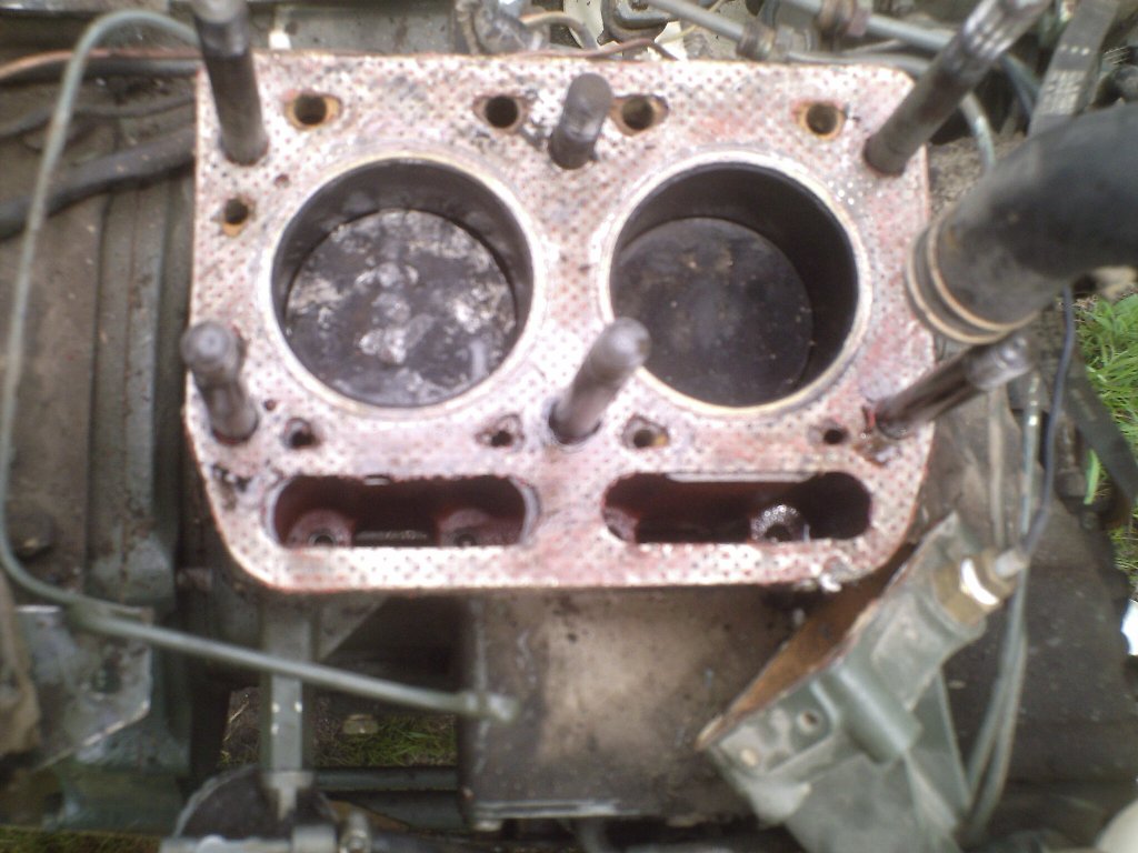

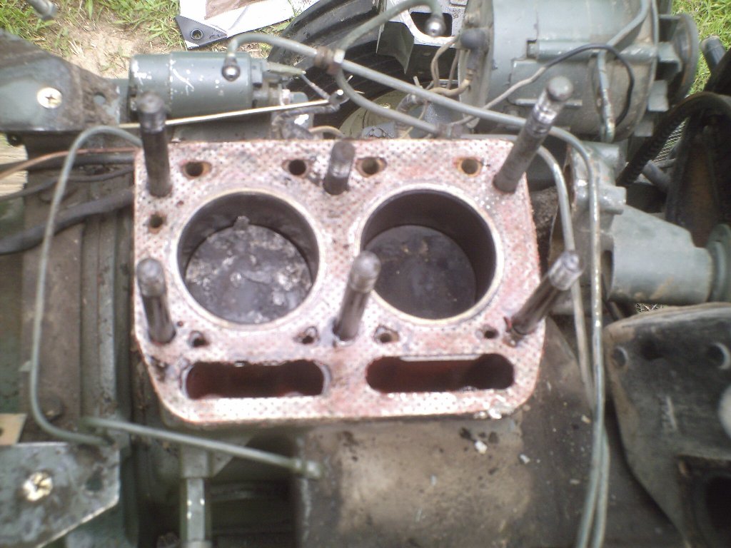

I finally got around to opening up the engine. I pulled the head and dropped the oil pan. That was quite a job! Anyway, The head looks okay. I did not find anything apparently broken or bent. I am going to take it to a machine shop to be tested. If there is no major damage I will have the valves and seats done too. The number 2 piston is a diffent story. It looks like the piston may have melted on the upper edges. I found pieces of metal sitting on top of the piston. (see pics) Also, I can't really even see the rings. I am sure they are cooked. Hopefully, if the head is okay i can get away with replacing the rod bearings, #2 piston, and rings on both.
Hopefully, the crank and mains are okay. There was plenty of oil in there and it looks like most of the heat was in the pistons.
Does anyone have any suggestions?

Bob, I'm sorry to see what happened there. I don't have any suggestions, just couple of comments:
That's #1 cylinder by Yanmar's definition. They number the cylinders starting from the flywheel. (This can be a source of confusion when you rotate the engine to adjust the valves at TDC.)
Is there any chance that the loose metal in the cylinder is from a foreign object that was sucked into the cylinder and then dented the piston? That would be a less serious scenario compared to a melted piston.
Also, the original warning light will come on when there is no water in the upper hose connector, at least on my similar YM240 (YM2000.) One of several problems caused by the previous owner was that the new genuine Yanmar lower radiator hose (previous owner's repairs) developed a leak where the sloppy-loose new fan belt (installed by that previous owner), chewed a pinhole leak in it. I lost enough water to trigger the warning light a couple of times in the first couple of days, before I fixed it.
I guess I do have one suggestion: since the pistons are coming out, have you considered replacing the pistons and sleeves as a matched set?

OK! Now I see your goods pics . I think you MUST remove Pistons for check Wall cylinders FOR CRACKS (AT the top cylinders walls If any Very bad Need new block. FOR DEEP SCRATCHS) ( We can remove lights smalls scratchs in honing process). If any deeps scratchs you can change sleeve (if your motor have) or rebore cylinders and put news pistons and rings. We can change one sleeve and piston but we must rebore the two cylinders and put news pistons and rings (expensive). You must evaluate the cost before begin. Good luck! Oldmech

California,
Thanks for clarifying the cylinder numbers. I replaced the overheat light with a temp gauge. The temp sensor was bad. Looks like the temp gauge does not work without being in contact with water either.
I have moved the pistons up and down and the liners appear to be in good shape. I could not see or feel any scratches. I know that I can replace the cylinders and pistons as a set. I just hate to keep putting money in this old tractor. The sleeves are nearly $200 each plus $90 each for the pistons. You get the idea. If the block is cracked I may just junk it.
I just don't know where the metal came from. I did discover an interesting thing while removing the head. There is supposed to be a gasket around the bottom of the breather where it is clamped to the flange. Well, there was. A homemade piece of inner tube that did not wrap completely around the flange. There was about a 1/2 inch gap. It had it had to have let a lot of debris into the intake. The intake was very dirty . The shade tree's that so called reconditioned this tractor did a fine job.
The metal is very soft. Looks a feels kind of like solder.

Sailor,
You may have sucked some solder in. The ahem - mechanics- ahem that did the work on your machine may have soldered a gap or done some other goofy thing.
I couldn't really see the pictures very well. Focus is out too much. You may try and use a nylon bristle brush to clean the top of the piston and see how it really looks. There is also some spray you can use to remove carbon. Can't hurt nothing at this point and you may find that you don't need a new piston.
