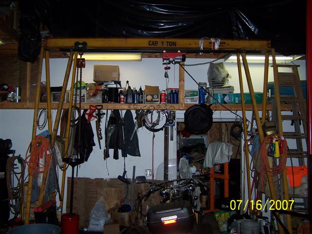

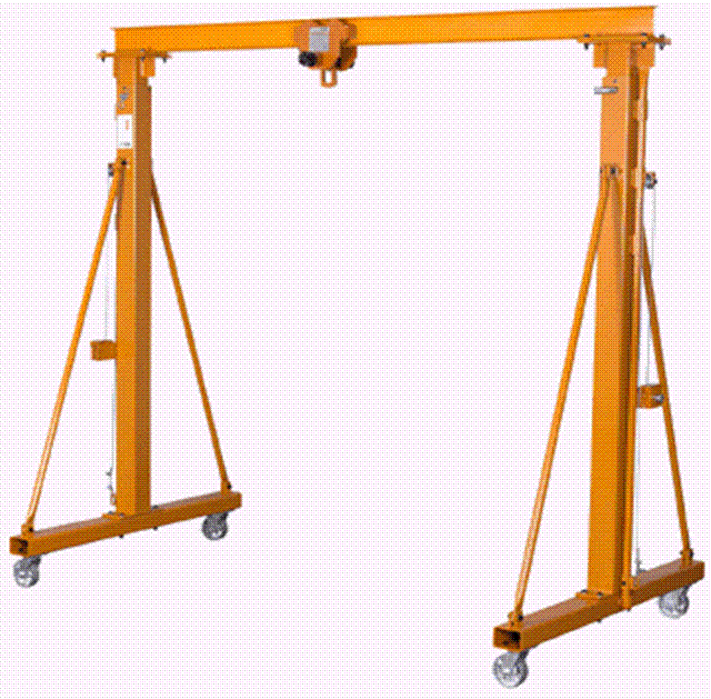

Doug's answer coincides with mine. I have a Hercules 1 Ton Gantry. It uses a 6" high I-beam x 3 1/4" wide. It is a little over 10'wide at the bottom and rolls around my garage on HD steel wheels. It has 10' clearance from the floor to the bottom of the beam. I have a 1 ton chain fall on the beam and added an electric winch on an 1 1/4" pipe that is sleeved with another pipe inside it. At 10'6" to the top I can roll it under my lift and outside if needed. I bought it at a garage sale about 25 years ago. The first pic is the one I have, the second is one I found on the net.
