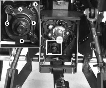

I over tightened one the cap screws (D) when changing the transmission fluid. I removed the
Suction screen cleaned and reinstalled. I have since lost the cap screw, it must have vibrated off. Is there an inexpensive repair that I can tackle my self or is this a dealer issue? Any help will be appreciated.
MX12150, MX12314
5. After oil is drained, remove two cap screws (D), two lock washers (E) and suction screen cover (F).

???? Did you over-tighten and break it off or did it get loose and fall off?
   / Over tightened Cap Screw!
Over-tighten and got loose and fell off?
   / Over tightened Cap Screw! #4
Are you saying that you overtightened the bolt and damaged the threads in the case? If so, it's time for a heli-coil insert. If you have a power drill you can do this repair yourself. No expensive dealer visit required. Check with your local auto parts or tool store a kit that includes the drill bit, tap, inserts and insertion tool. All you need to know is the bolt diameter and thread pitch. If the tap will not pass through the cover you will need to remove it and then refill your gearcase. Please let us know what happens.

What he said. If the case is stripped then a helicoil is the best solution-and I would do both just to be safe.

Exactly, I damaged the threads in the case. Thank you I will go this route for sure. I appreciate everyones feed back

Sometimes it might be easier to tap the hole for the next size bolt... all depends on what you have to work with...

I'm just starting to do my reasearch. Would I want to use the free running type or the screw lock type? Also which finish? dry film lube or no finish? The bolt is M8X20, how do I determine if it is a fine thread or a coarse?

I wouldnt reccomend that...in the future this "could" happen again.... HeliCoil is the way to go...same size bolt, AND a HeliCoiled insert is usally STRONGER then a plain tapped hole in aluminum. Thats why most hi-perfomance heads like Edelbrock come FACTORY with helicoiled inserts.
In the racing community I've also seen people helicoil the valve cover bolt holes on aluminum heads because the aluminum just doesnt stand up the repeated removal/reinstallation...with helicoils they last forever...
Because this is a "commonly" removed part, I'd probably go ahead and helicoil both of them and be done with it...
