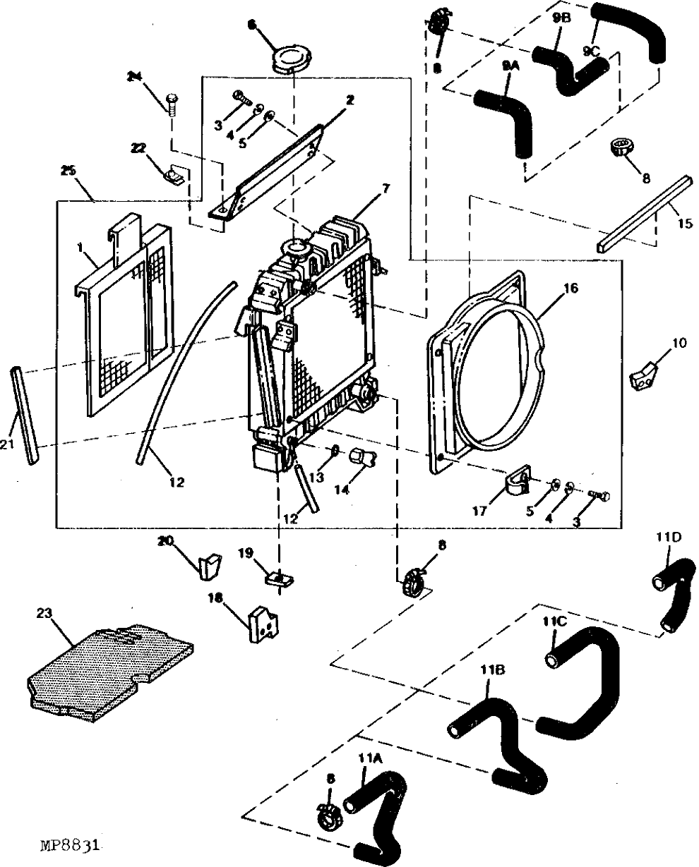

Does anyone else have problems with the radiator getting plugged up on their 55 series. I washed out my radiator real good, front grill, oil cooler and cleaned the screen out. In 3 hours time of mowing tall fescue I was over heating. Radiator looked like it had not been cleaned in days. Today was a very hot day heat index was around 105. I came back home got the 4700 out and mowed all day. The heat gage never moved over about of the 1/4 of the way off the cold mark. The grill was covered when I got in with it. My 755 has a new radiator, fan and belt. Any ideas on how to keep the radiator clean. If I can keep the radiator clean it will run cool.

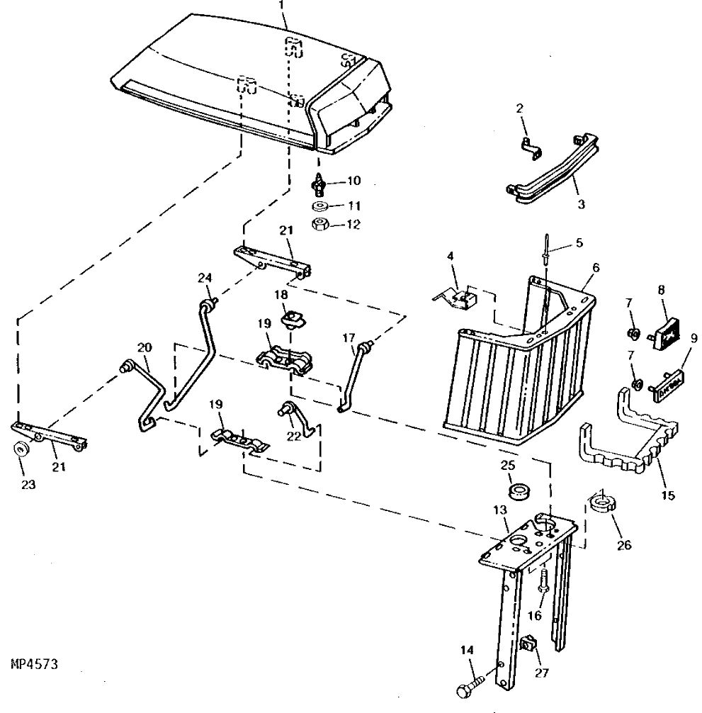

The parts illustrations shows a pre-screen and a bunch of seals and pads. Are all of yours in place?

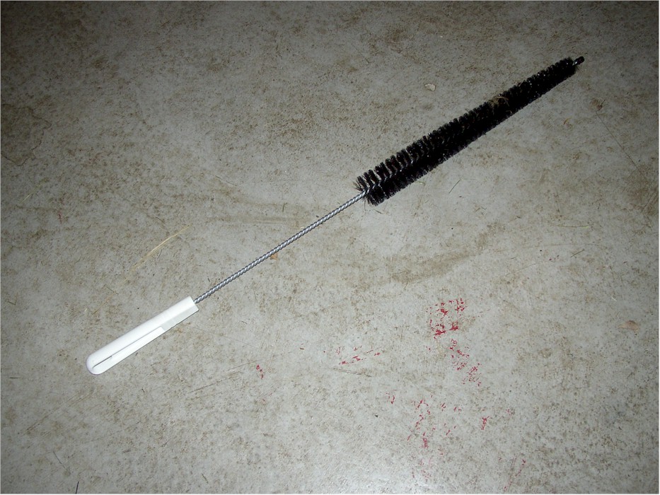

Agree to check all the seals and pads to insure correct airflow. Most debris is caught in the external grill screen on mine. As an aside, I had previously mentioned a Fuller Brush dryer vent cleaning tool available at Lowes that makes cleaning what does get to the radiator a bit easier.
