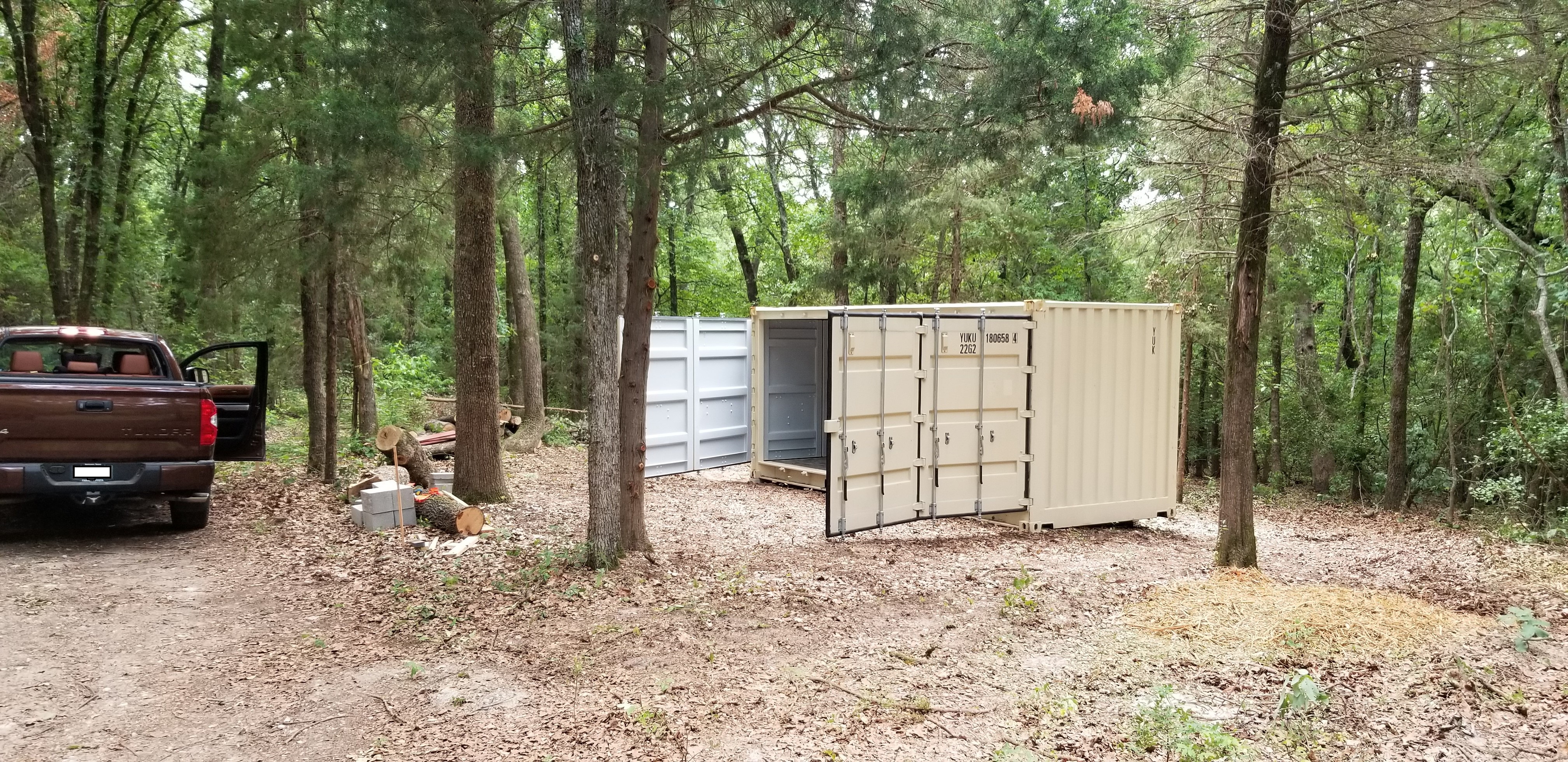

If you're going to start attaching a bunch of crap to the container, you might as well build in traditional fashion. It is easier and cheaper than modifying containers. The only reason I am using a container for my cabin is because it is a little more secure. But I ordered a container that allows me to build a wall behind the doors so I will not be fabricating holes into the box either. See pic. 1.jpg

If you're going to start attaching a bunch of crap to the container, you might as well build in traditional fashion. It is easier and cheaper than modifying containers. The only reason I am using a container for my cabin is because it is a little more secure. But I ordered a container that allows me to build a wall behind the doors so I will not be fabricating holes into the box either. See pic.View attachment 564985
Wow. What did a side opening with end door 20 ft one tripper cost? I bet I can buy six HC 40 ft delivered for what two of those cost.
Welding "H" brackets from strap steel or 1/4 HR slick rod to hold PT wood to a WWT HC 40 footer is the poster child for inexpensive, attractive storage. I think a single lift of 1.5" closed cell would be adequate. The darn things are almost tornado proof from debris. Tough to break into. Strong enough to support a light weight bridge crane.
You should be feeling some love.
It was $5900 delivered. So, you can buy about 1.3 40 foot HCs rather than 6 for that price. Prices vary on geography and will likely go up with the new tariff wars... I don't know how to weld nor own welding equipment. It was about $1500 more than a standard single tripper and I am not interested in buying one that needs repaired. For me it is worth spending $1500 vs cutting holes in a standard container, buying welding equipment, learning how to weld, getting good at welding, then fabricating the container, doing a bunch of janky adaptations, etc. etc. etc. Or pay someone else more money to do it (probably wrong).
Nonetheless, even if I did own welding equipment and knew how to use it; it would still be more expensive and/or time consuming to correctly modify a shipping container than to do traditional construction. Built properly, wood construction won't rot. Standard metal buildings do not rot.
There is also more to cost than the material. I work a full time job and my property is 1.5 hours from where I live. A big benefit of the shipping container for me is that it is a place to store my tools while I am building it out rather than load and unload my tools and haul them back and forth. It's an instant shell. So for me, it is a time and security consideration. I does not pan out cheaper in raw dollars compared to traditional construction no matter how you toss it and dice it. You're basically paying for very expensive siding that needs most all of the other stuff that a traditional built structure needs, plus some other things that you don't normally need for the A-typical adaptations.
But I digress - this thread is about storing implements outside. I know plenty about construction methods and techniques, being an engineer in the industry. I don't know diddly squat about tractors as I am still shopping.
