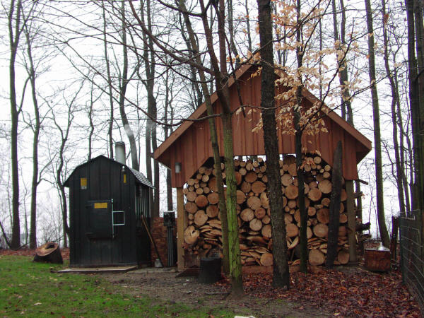

I am on my fourth season with a central boiler brand outdoor furnace and I am very pleased and would recommend it to anyone. I will try to post some pics later
Kevin
   / Outdoor wood furnace #4
Here it is with the shed I built to store wood in. Like I said, I am very happy with it. I add wood to it in the morning and again in the evening and will cut my consumption down even more when I get some stuff buttoned up on the house.Check the other thread and you will find a lot of info/oppinions to help you
Kevin
