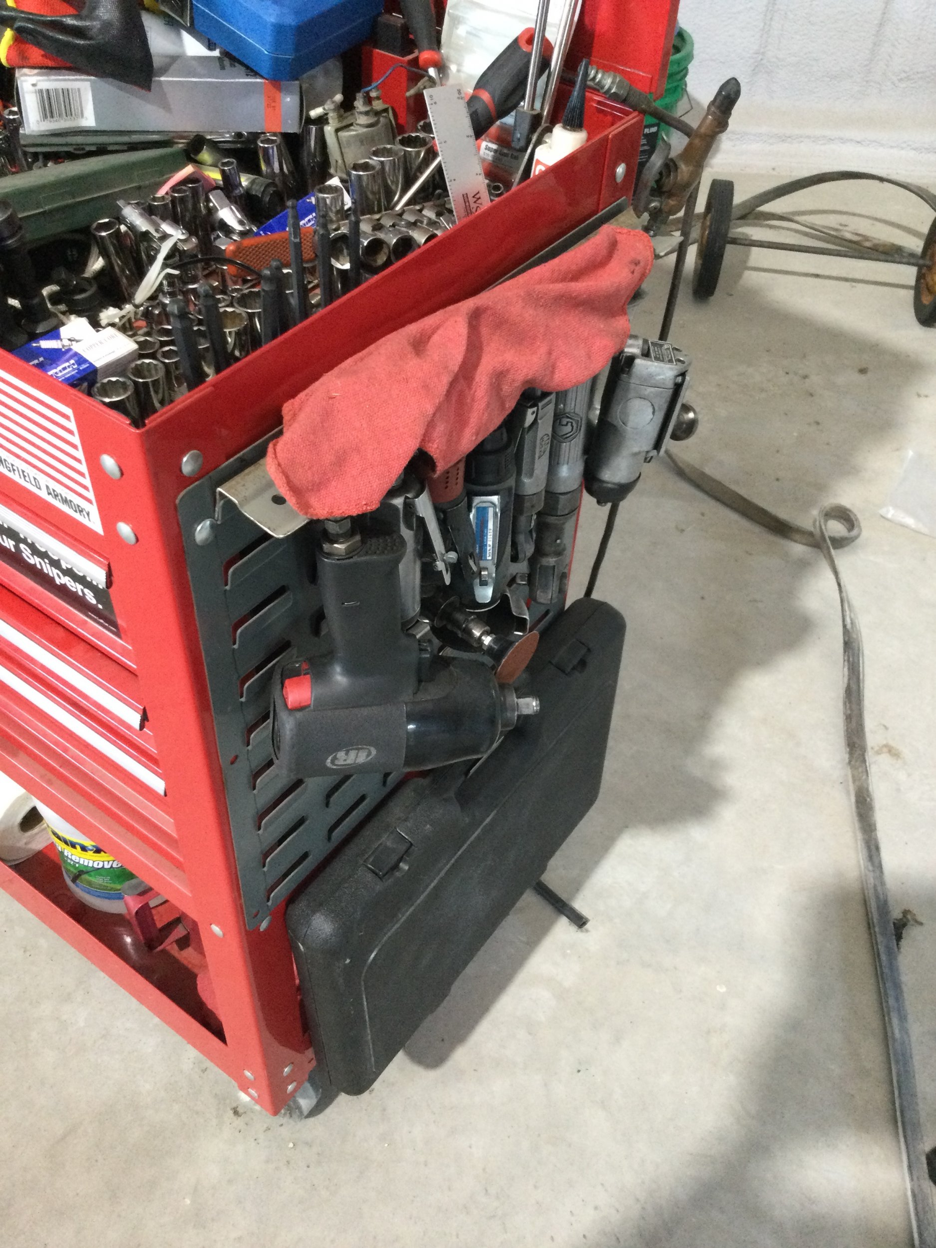

It doesn’t even have to be a hole around here, but they do get them.
The tools I don’t keep secured, I just cover with a, dirty but not done yet, rag. I don’t think they even go near the little cart anymore.

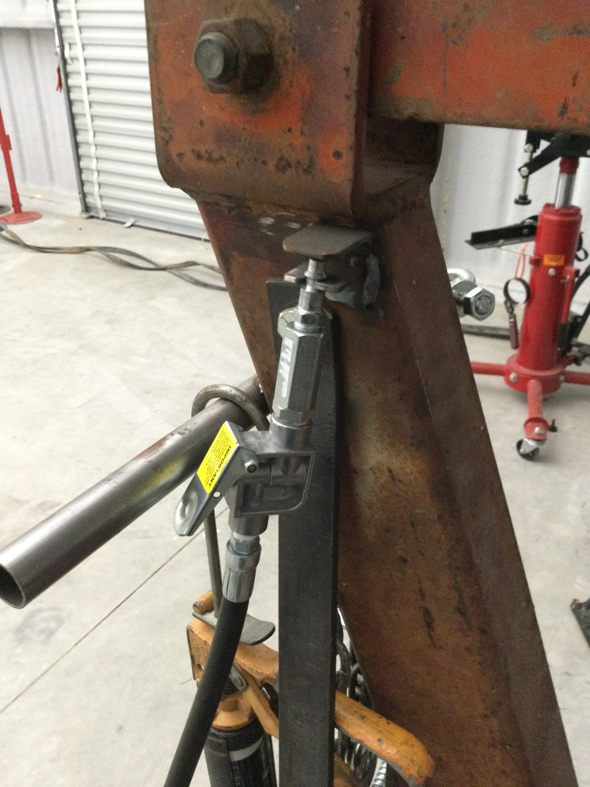

Another method I’ve used to keep debris out of couplers when not in use.

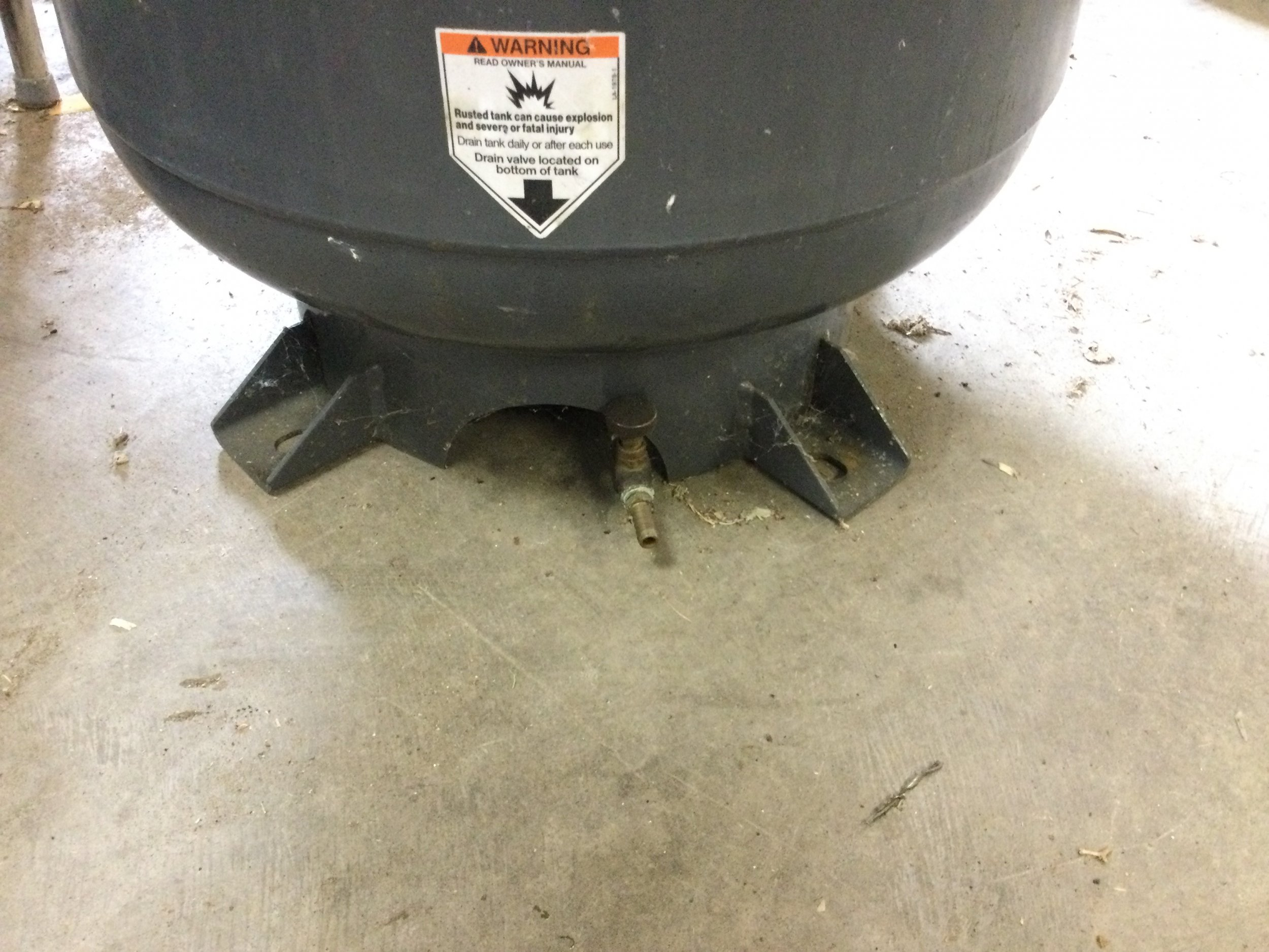

Some of my tanks don’t get used enough for an automatic drain, one can still make it easier to do if they trash the normal radiator drains and put a 90 & straight section of pipe off the bottom of the tank so you can put a good valve in an easy to get to place.
