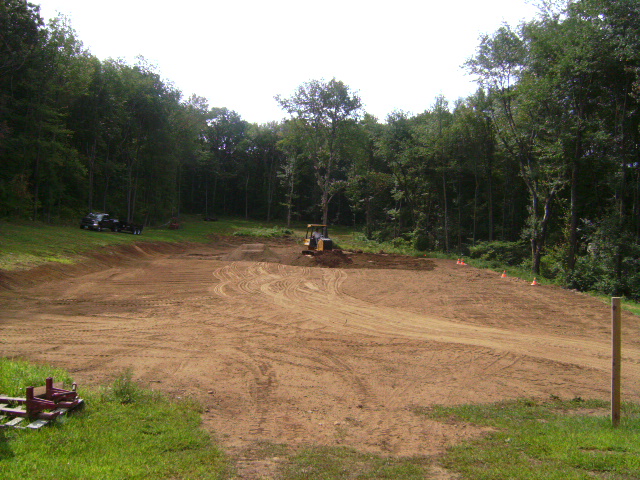

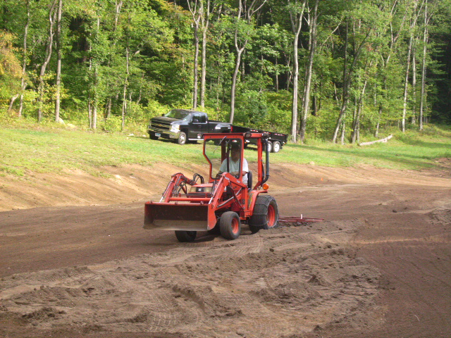

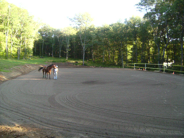

Yes having the right equipment to do the job is key. In our backyard arena (its about 80 x 200 ft), I had to cut down a hillside and build up the low side by a few feet. Having only real small machines at the time (Magnatrac loader/BH and Kubota B1750) I rented a Bobcat. It dug OK, but progress was going too slow, so I rented a small JD 450 dozer and that did a great job and was fun to operate. :) I rented a Bobcat with a rockhound power rake for a couple of days to get all the rocks picked up and get things smoothed out. Then I had 10 triaxles of sand dumped and I pushed it out with the dozer. The Kubota helped with final sand smoothing with the york rake and drag mat.

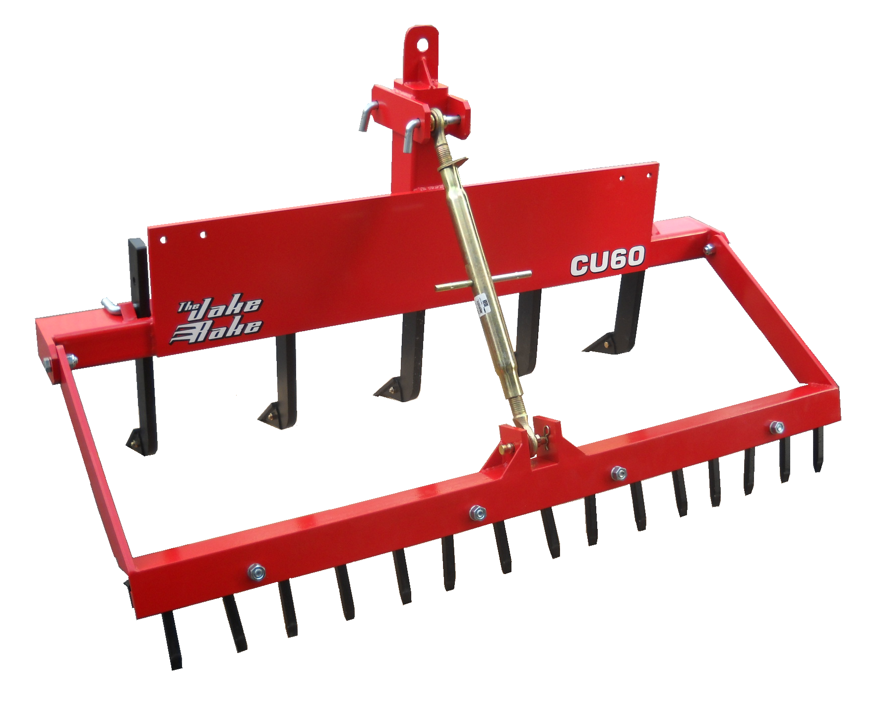

For creating an arena, Start with a good level cleared area, would be easy with the common box blade and FEL. For arena maintenance, there is the Jake Rake. It is my personal invention specifically designed to cultivate, level, and groom horse arenas. There is virtually no maintenance to do with this product, no grease zerks or bearings. It is easy to adjust and the rake bar is fully adjustable. It is imatch compatible and available in 4', 5', and 6' models and in most any color you desire. Send me a PM if your interested and I can personally give you a quote. These can be used in a lot of different ground conditions including sand, dirt, wood chips, and many more footings. I have had a lot of people comment on how well my product grooms the arenas at my grandpa's horse stables which has 3 arenas and a large round pen. Check out my website for additional information as well
Jakes Implements - Home

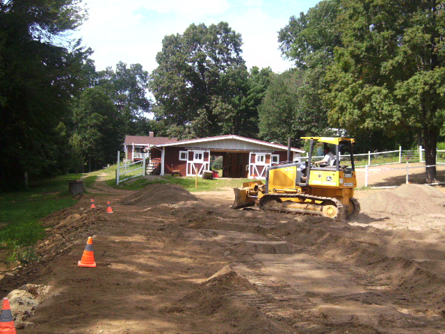

we toyed with the same questions about 2 years ago. we built a 80 x 220 outdoor arena for driving horses. i was going to do the work myself, but after checking on equipment rental costs, etc. i found out i could hire someone with a huge front end loader who can do the work in 1 day, as opposed to my renting smaller dozer for 3 days. I had trees, so hired a logger to cut and haul trees (money made from logs paid for his time). then the loader operator pulled all roots from ground and reshaped the arena in 1 day. he dug pit to bury roots in a few swipes. Next year well import a sand/wood chip base to add to it. i wanted to give it a few years to self compact/level off. one side was 4' lower than the other when we started. now its all level. I also added 4 light posts and a speaker system.
