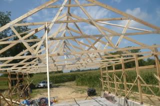

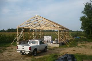

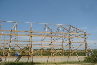

Here is how mine is built, not the best picture but there is a 2' wall on top of a footing that is below the frost line. All the posts sit on 1/4" steel brackets that are bolted to the concrete, grade will be 1' below the top of that wall and the concrete floor inside is 1' below the top of that wall (at grade). There are openings in the concrete wall for the doors on the front and back. The reason I did this is because all of the wood (except the trusses) are milled from Poplar, Locust and Ash that are from the timber 50' away from the building. I also did this because I cannot stand when water finds it's way in when grade is near the floor height and I don't like wood rotting.
I also have a good friend who is owns a large concrete business, hence the concrete overkill on it.
Here is a better picture of the design:
