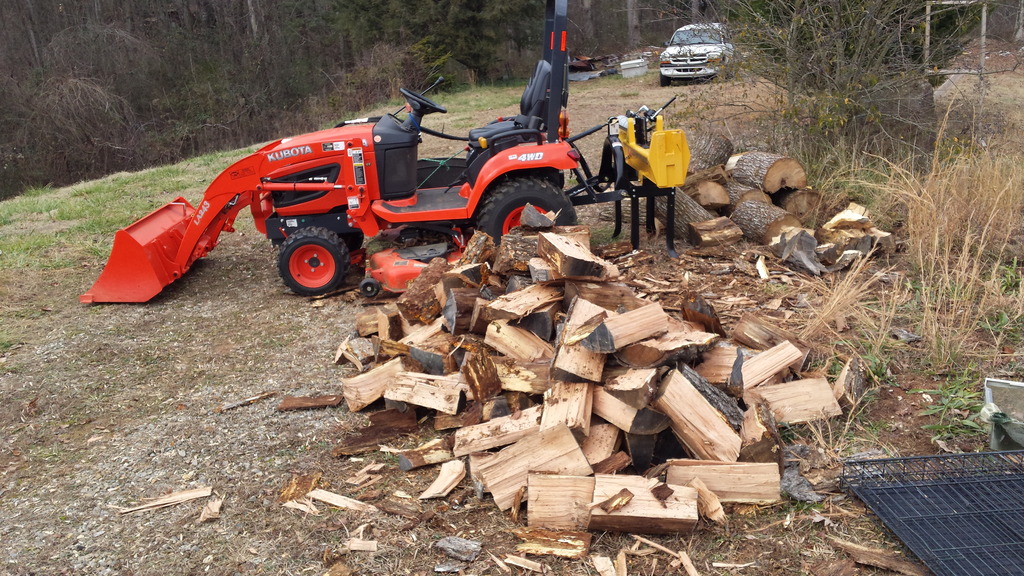

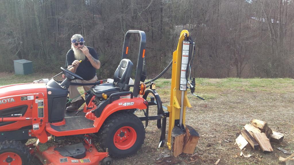

2 years ago I bought a Orange BX2660 with FEL, and MMM.
- This is a fair mower - blade speed at 2700 rpm is still lower than a commercial walk behind mower
- The deck is from pressed metal and has a lip that runs across the front and just fills with grass, and junk on every mowing - real PITA to keep clean
- The parts under the floor/top of deck trap debris, so you can not simply blow the grass clippings and leaves out in a single direction, it is a PITA to get clean
I put 97 hours on this tractor in 2 years and here are some more observations:
- The Hydro pump is very small - about 4gpm - barley runs a log splitter
- The FEL lift capacity is @ 500lbs
- The FEL controls are extremly jerky - there is no percision
- The weight of the tractor is only 1300lbs - so any plow pretty much stops the tractor dead in compacted soil
- The 3 point is very low to the ground, so using standard size implements are tricky
- Very unstable with a FEL full of soil, feel of tipping on a 8 degree hill (this might just be me)
- Very loud engine and exhaust
Now the good about the Orange
- every time I put the key in it - it started
- In 97 hours I never had to repair anything
- Held it's value very well
I selected the incorrect size for my needs - I have 5 acres, with fruit trees, large garden, animal cages, and poultry.
The FEL lift capacity was a real let down, however being my first tractor - I had no idea I would need more than I had bought.

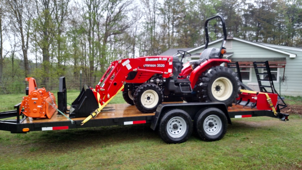

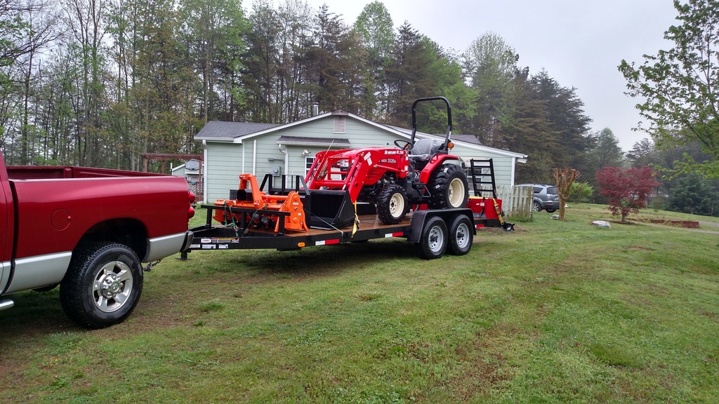

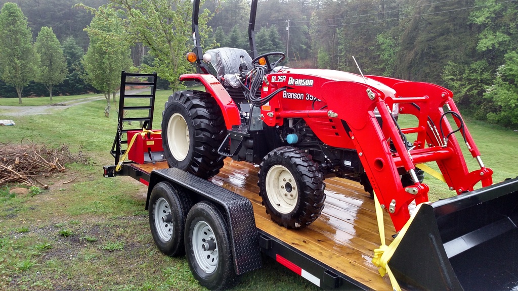

So last week the little Orange was sold and today I picked up a Branson 3520h.
The specs on this tractor speak for themselves, and the price was right.
I will try to catalog this tractor as I did the Orange.
I will answer any questions about it that I can.
I hope this information help someone - always buy more tractor than you need - I learned the hard way.
