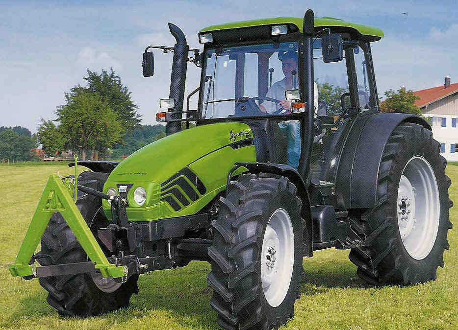

/ Out front mower #13
I dont have one of these, but I think I'd like one...
Thought it would be very cool and efficient to have a 15' batwing on the back, and maybe a 5, 7' cutter on the front for "trimming" under the Rosebushes
/forums/images/graemlins/crazy.gif /forums/images/graemlins/grin.gif
