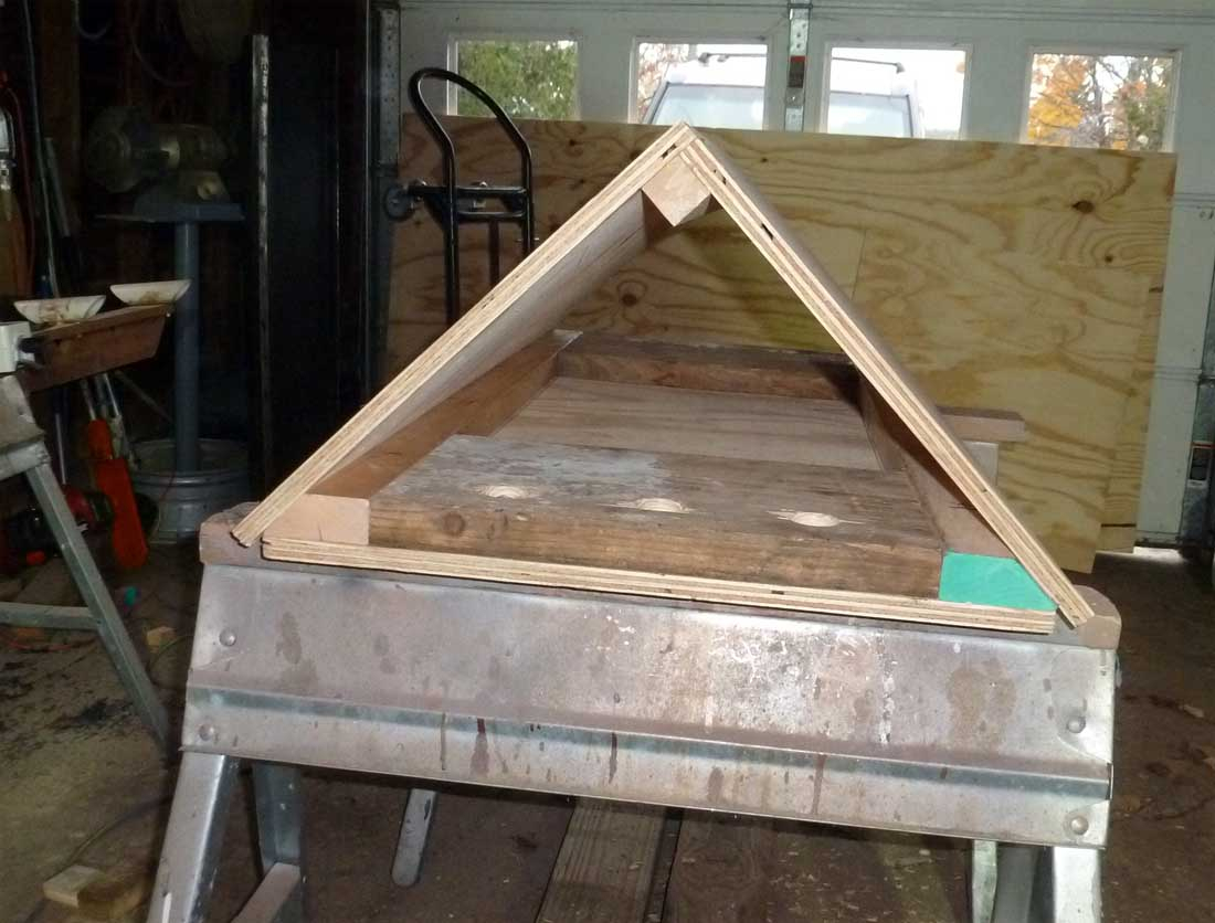

Here is the roof under construction. That is a 2x2 at the top and 2x4's at the bottom corners with a 45 degree trimmed off. All these are glued and screwed on. The material is 3/4 plywood which as cheaper than the 1/2 and 5/8 was. Go figure! The idea was to make it tough enough to take some serious limb strikes. The pieces are 4ft long, so as to reduce cuts.

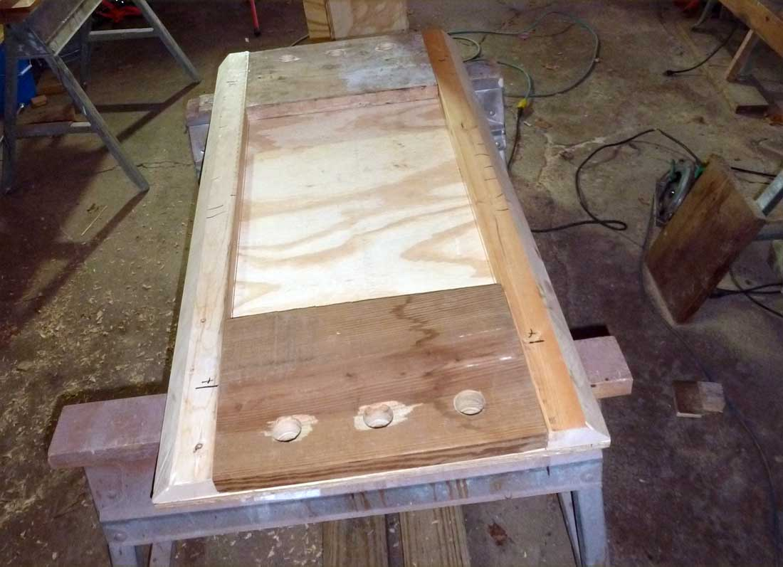

This is the base of the roof with some vent holes already cut into it. That's a 2x10's at each end so there is something to attach it on with.
Its bottom after it was done. The ends were caped with 3/4 plywood triangular pieces.
The reason in looks wet was because I coated the whole thing with some good deck preservative before the tin was added.
Side view. This is all 10" fascia, its covered with. This worked so well, I'd use it again! (y)

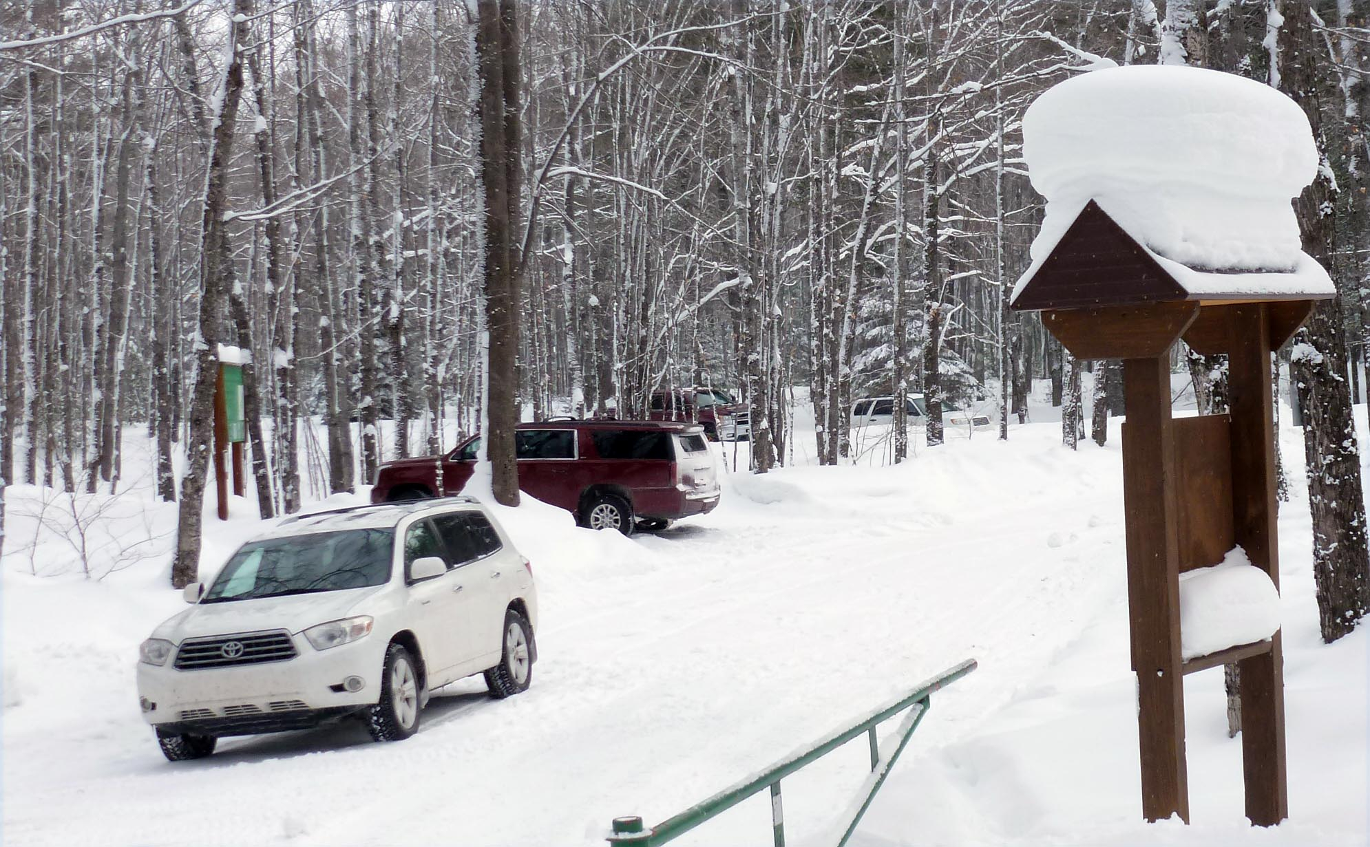

So when your trails are groomed and at their peak, how deep is the snow on that compacted base?
(I noticed that your kiosk has very tall legs - but if the information was 4' off the ground in the summer, I'm guessing you would have to be on your knees to read it in the winter 🙃 )

More shots from today. I'd now say the roof could have been a tad closer to the sign board
