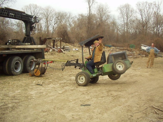

Many years ago this forum had an official test pilot!
I miss Mr. Bubenberg.
