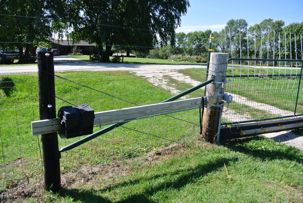

I was expecting the motor today but it didn't show up yet.

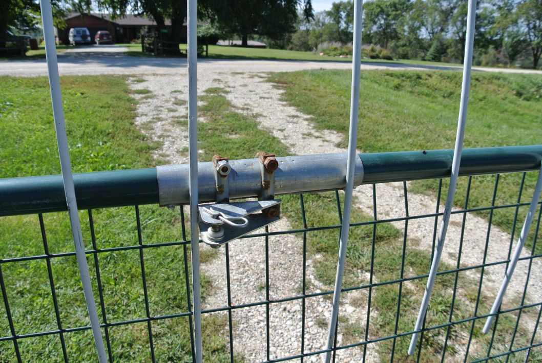

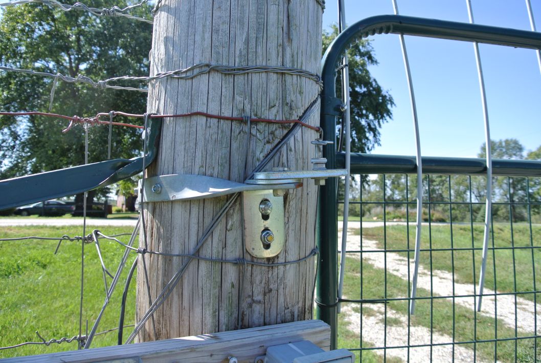

The pics show the post brace, the bracket brace and pivot pin mod and the sleeve I added to strengthen the pipe after damage.

ahh... a 2-3 tube gate.. and looks like 1.5" tubes. makes more sense now.

Nice job on the hinges... often the weak link in my experience.
Thanks. That's what I figured as well
