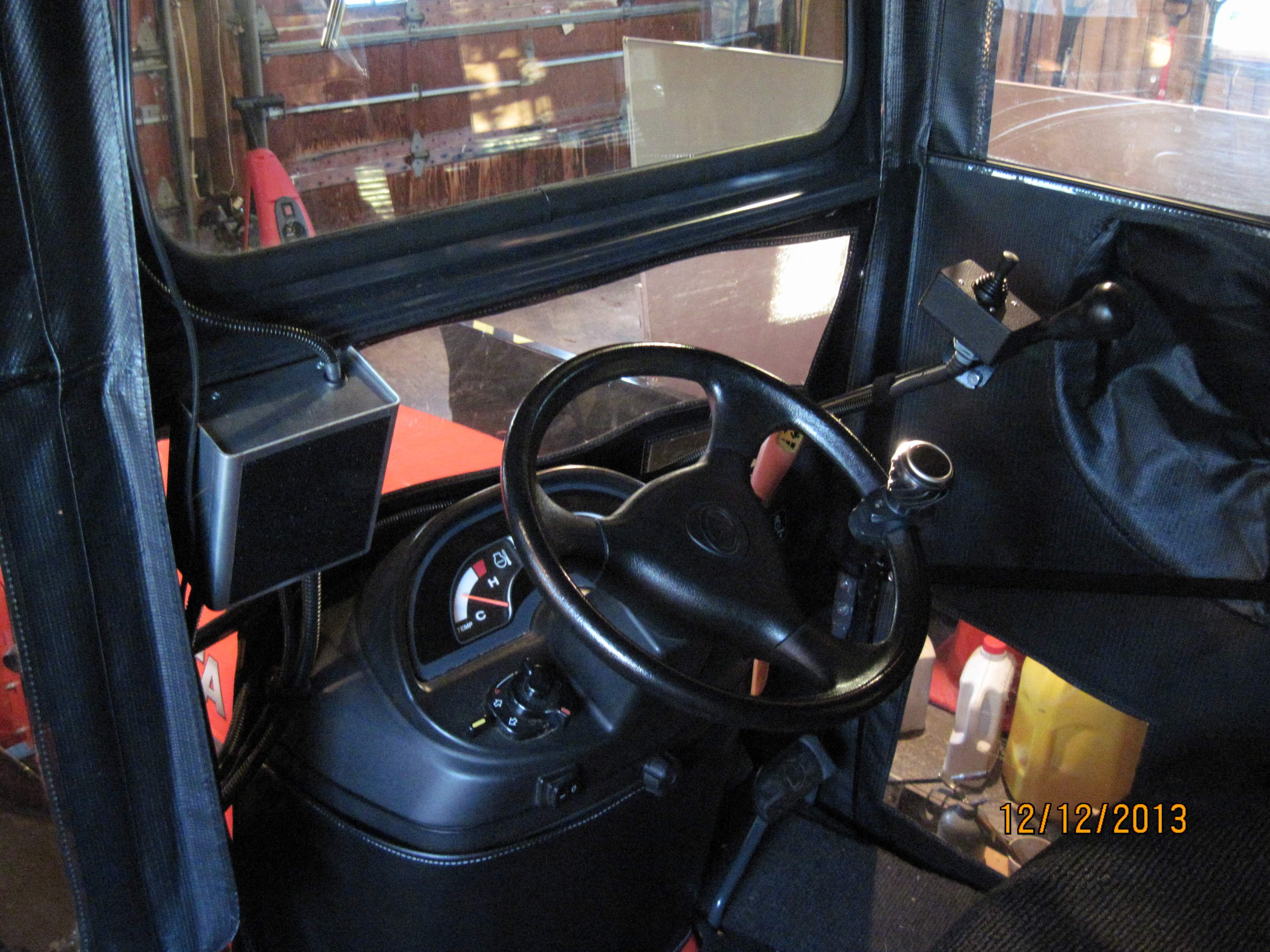

Here's a couple of shots of my BX24 with OriginalCab hardtop cab with glass windshield. I built a joystick controller for the electric rotator (window motor) and deflector (12V linear actuator.)
In the photo you can see the joystick mounted in a plastic project box that I sprayed with bedliner. The box is attached with a liquid-tite nipple which also provides a conduit for the wiring. The 5x5 aluminum box on the left houses 4 automotive relays and all the wiring. This setup uses the joystick to switch ground to one of the four relay coils. Details if you're interested. btw - my old setup was two dpdt rocker switches. They worked fine but not at my finger tips and harder to press.

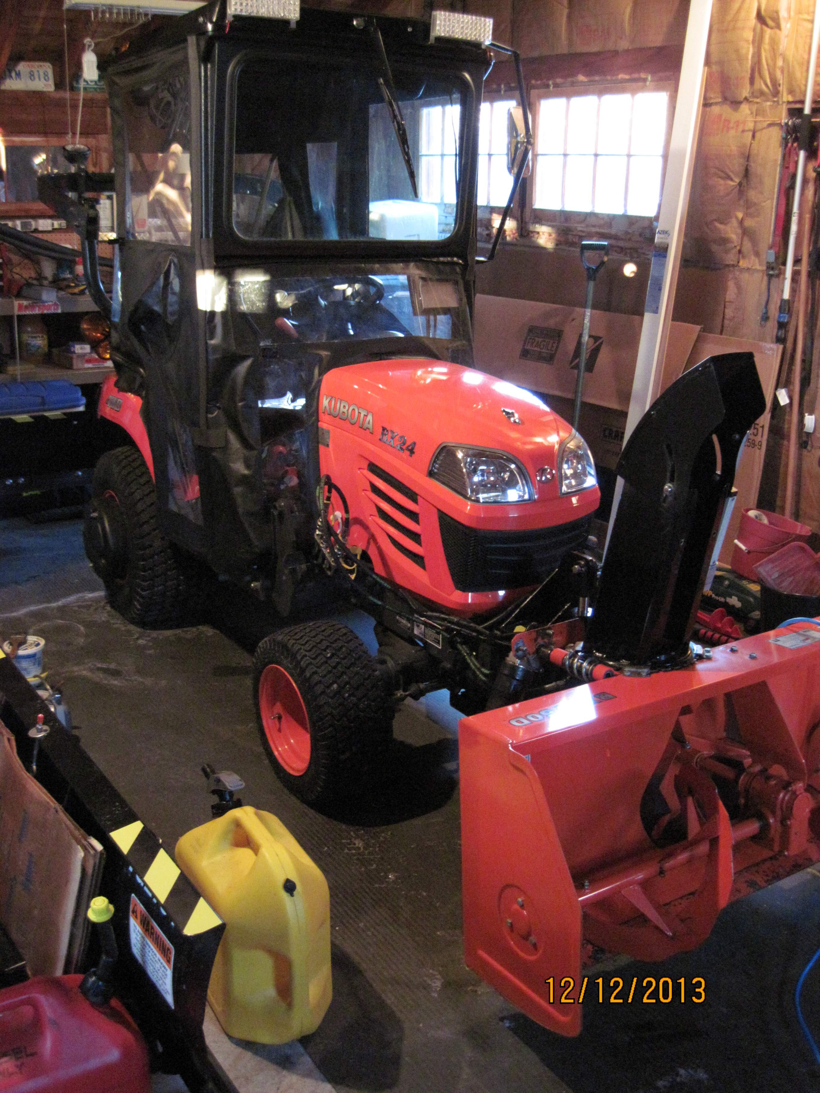

Nice job on the joystick, I'll bet you can't wait to try that baby out.:thumbsup:
