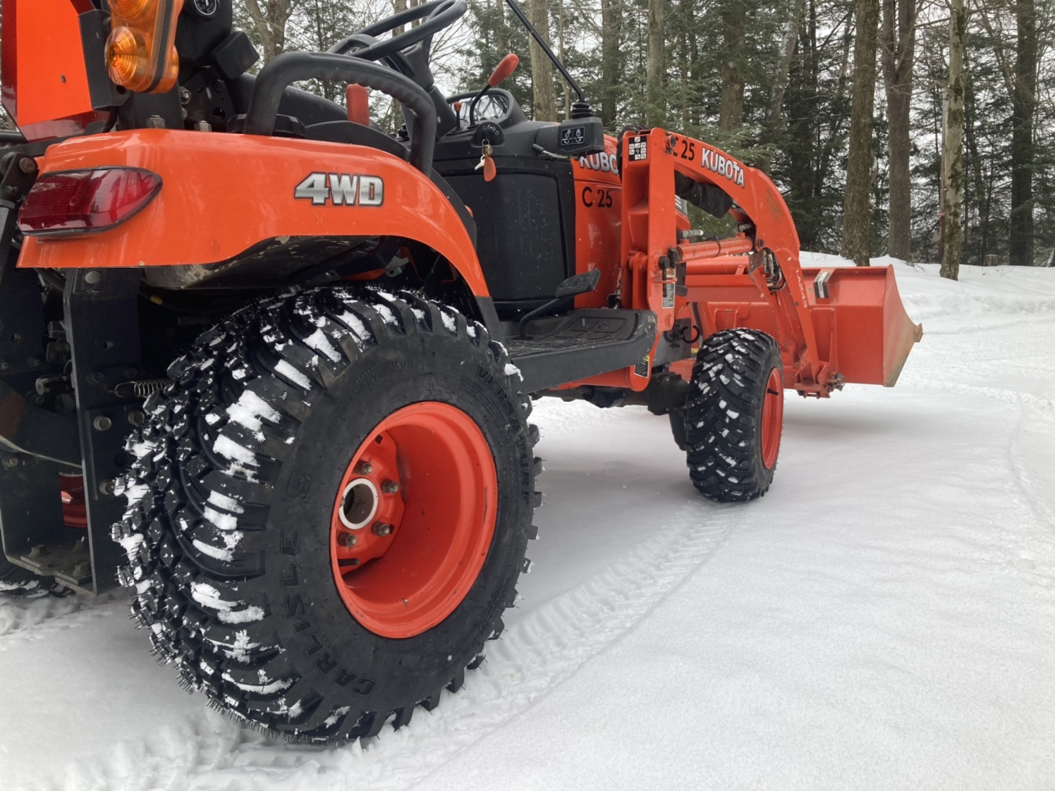

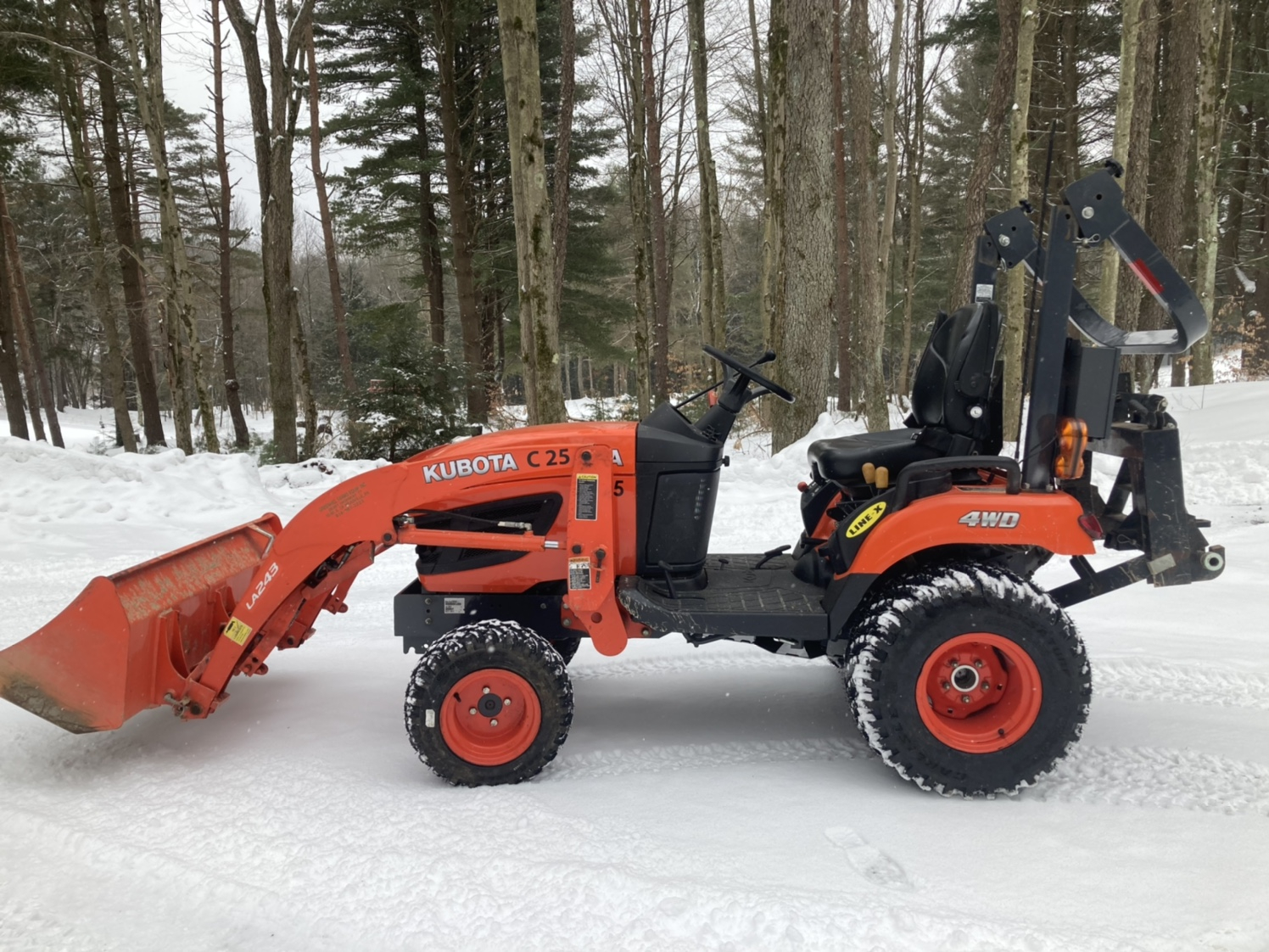

So the outer bead on the front tires sticks out, while the outer bead on the rear tires is no worse than the turfs I replaced.
The R14’s are substantially heavier than the turfs, and on my asphalt driveway, you feel the rumble. It’s not bad, but certainly not like smooth turfs.
I have not noticed any issues tearing up the lawn, and my son drove my nephew around for about an hour.
The fronts and rears hold 10-12 pounds more air than the turfs, so I suspect that they will be much better for loader work.
I’ll keep reporting as I get more seat time. Looking forward (not really) to using in the snow coming Monday.

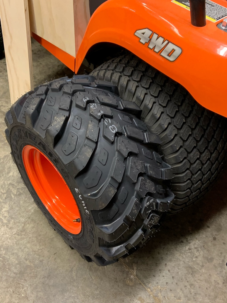

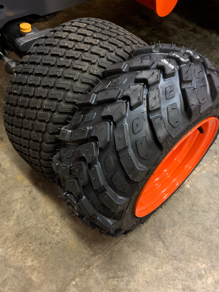

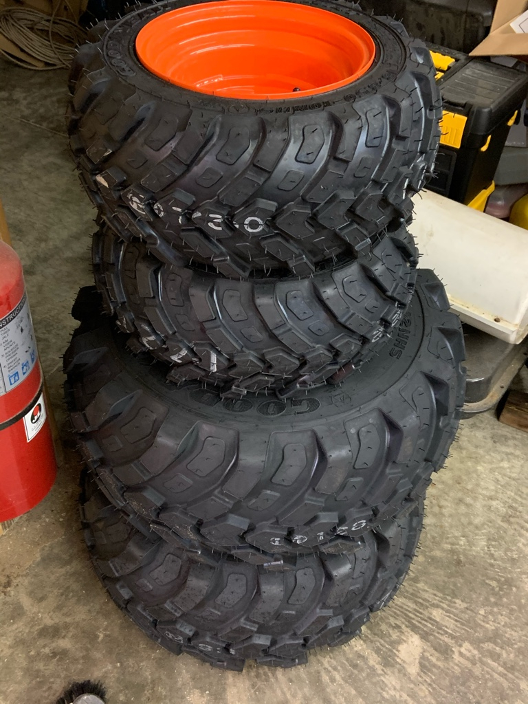

I’ll get them mounted on the BX tomorrow, but I’m surprised at how much taller they are than stock, despite the same size designation. With my last BX2660, I had both turfs and R4’s, and the R4’s were noticeably smaller in diameter than the turfs.
Only thing I’m not happy about with these R14’s is the rim bead sticks out past the face of the tire by 1/4”. And yes, I know the front R14 is on the wrong side...

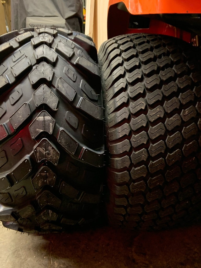

Did the new tires actually increase your ground clearance?
   / Ordered a set of R14’s for the BX
#28
Yes, increased ground clearance. See photos for diameter difference. They do not tear up the grass, but do ride tough at full psi.
