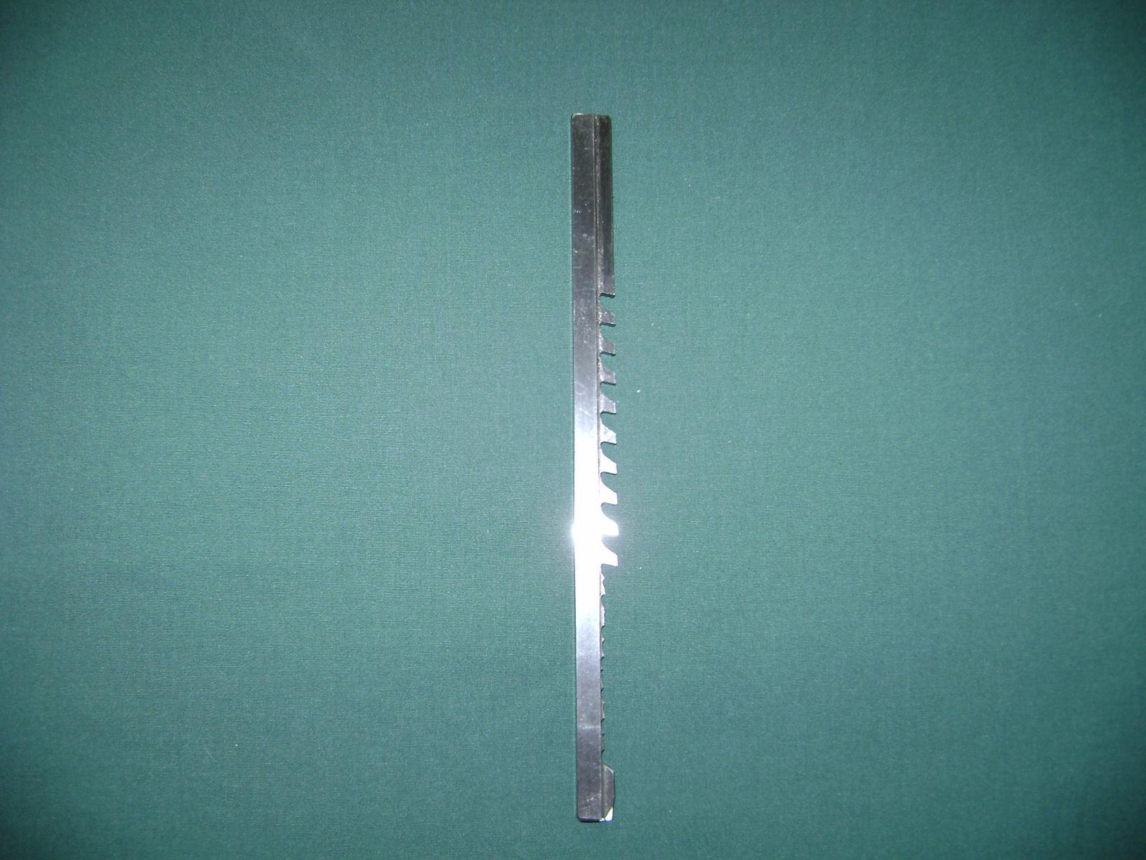

You might get away with dimpling the shaft at each set screw, but that didn't work for me. The round tube dies were soft, but one of the square tube dies was very tough. Luckily that was the last die I had to do, because it killed the broach! I need to use an end mill to precut the key way on that die before running another broach through that die.

What's the 2nd. pic, a broken key? I was thinking it was a home-made ratchet handle for the bender..

Shield Arc - do you have a broaching machine or is there some way to set up the part in a fixture and pull the broach thru "manually"?

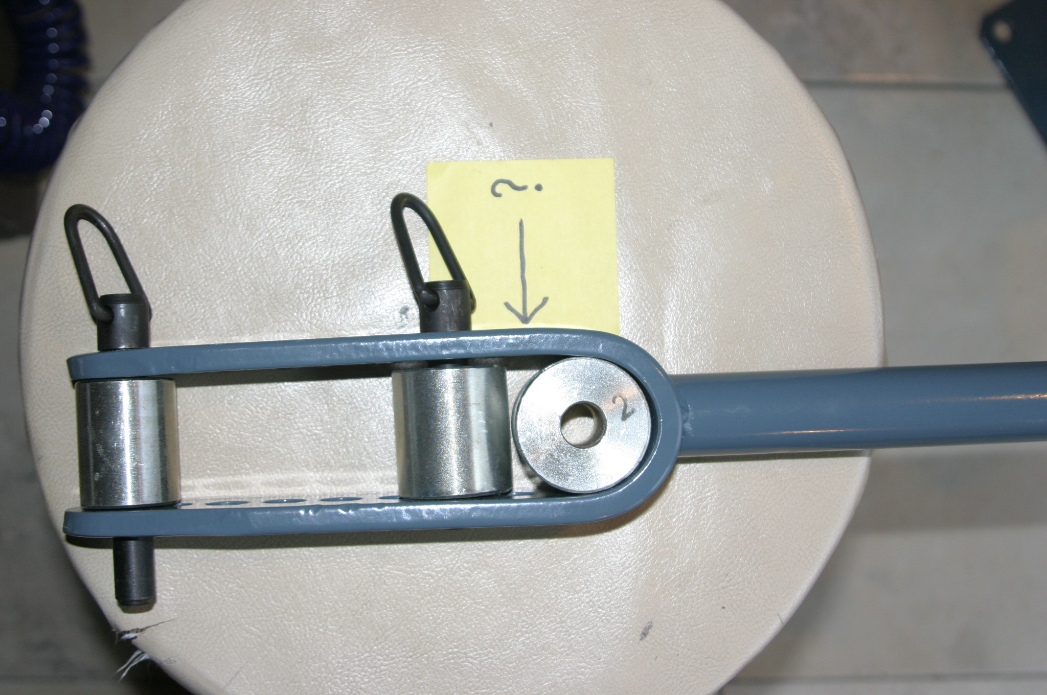

Bender needs a little bending... viscous cycle, I'm not buying a press. :confused2:

Leave the far left die in place, pull the pin and remove the die next to the 2-inch die. Set the fork on the floor and smack it with a BFH right about where your arrow is on the piece of paper. Be sure to leave the 2-inch die where it is.

That's the plan. I was trying to figure how to hold it on the anvil, but you're right, the floor's the place for that one.

So I got the fork/handle nice and straightened out, now I have to cut one of the welds on the ring and weld it back down flat where it binds. Seems like they could'a just welded it on straight when they made it, but what do I know.
