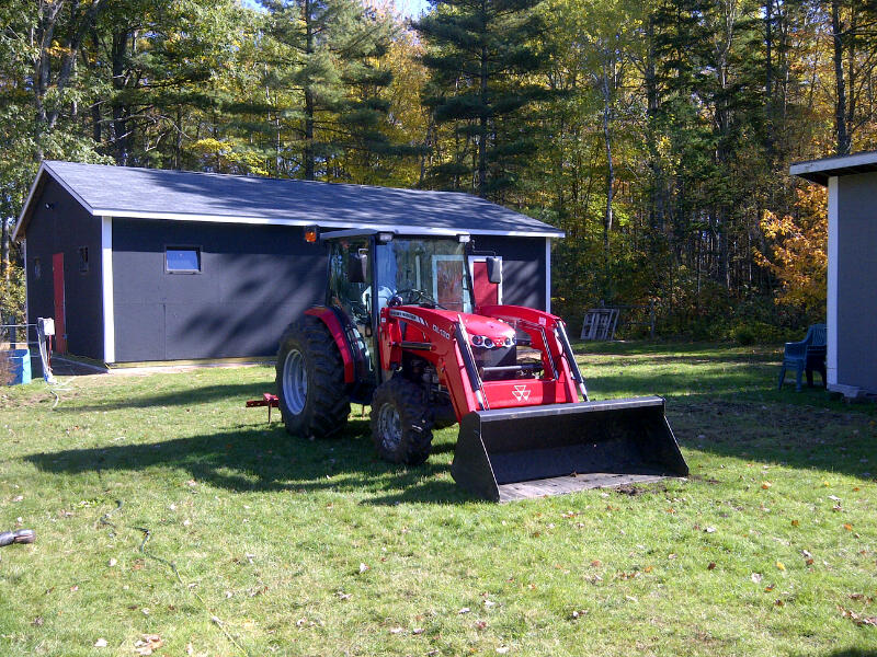

Actually MF does ofer the Dyna in a smaller tractor, my 1660 I just bought last month has one in it. I got the chance to put a few hours on it while home, love it so far.
