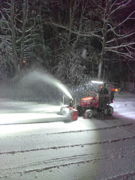

I put UHMW on the back of the chute/deflector yesterday too. Looking forward to seeing how that works. The linear actuator for the deflector made out well in its first event, tonight I also get to check out the real world effectiveness of the light bar on the front and 2 LED work lights on the back.
/ Orange on Red #82
Well I wasn't impressed by the FluidFilm. I wouldn't say it was worse, but not appreciably better.
My lights and the UHMW chute liner, OTOH, were worth the effort.

Nice lights! Another justification for the cab, I'm thinking...:roll eyes: When blowing, they really do need to be up fairly high to be effective.
As far as the paint, I know it'll wear off eventually, but it sure works well for now!

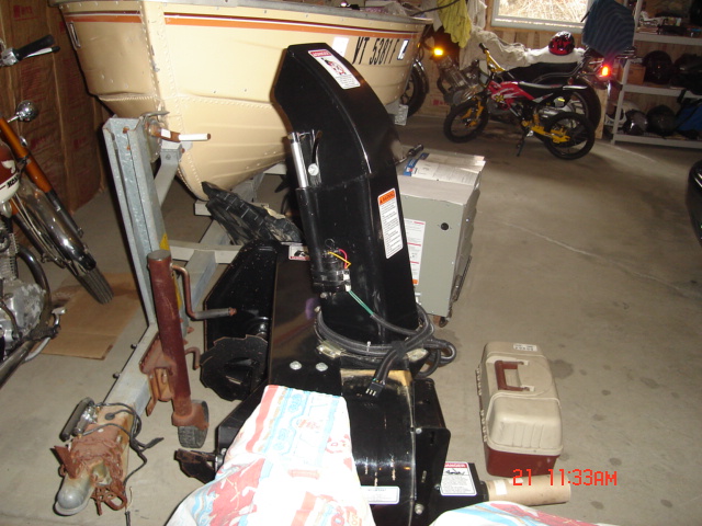

Loving my remote chute deflector too. This was before I oiled the hinge so it's a little jerky. Pretty smooth now.

When I bought my TLB (plus blower) back in 2007, the dealer only sold blowers with the factory electric chute controls mounted. Never regretted it! Not real fast, but definitely nice to have. OEM deflector is similar to your set-up but mounted on the side. (Bet yours works better and cost less!!)

I thought about side mounting, but like the symmetrical aspect of being in the center.
I used a 2" travel actuator and ramped up the geometry to make it faster. If I had used a 4" one it would take twice as long. Speed is just about right.

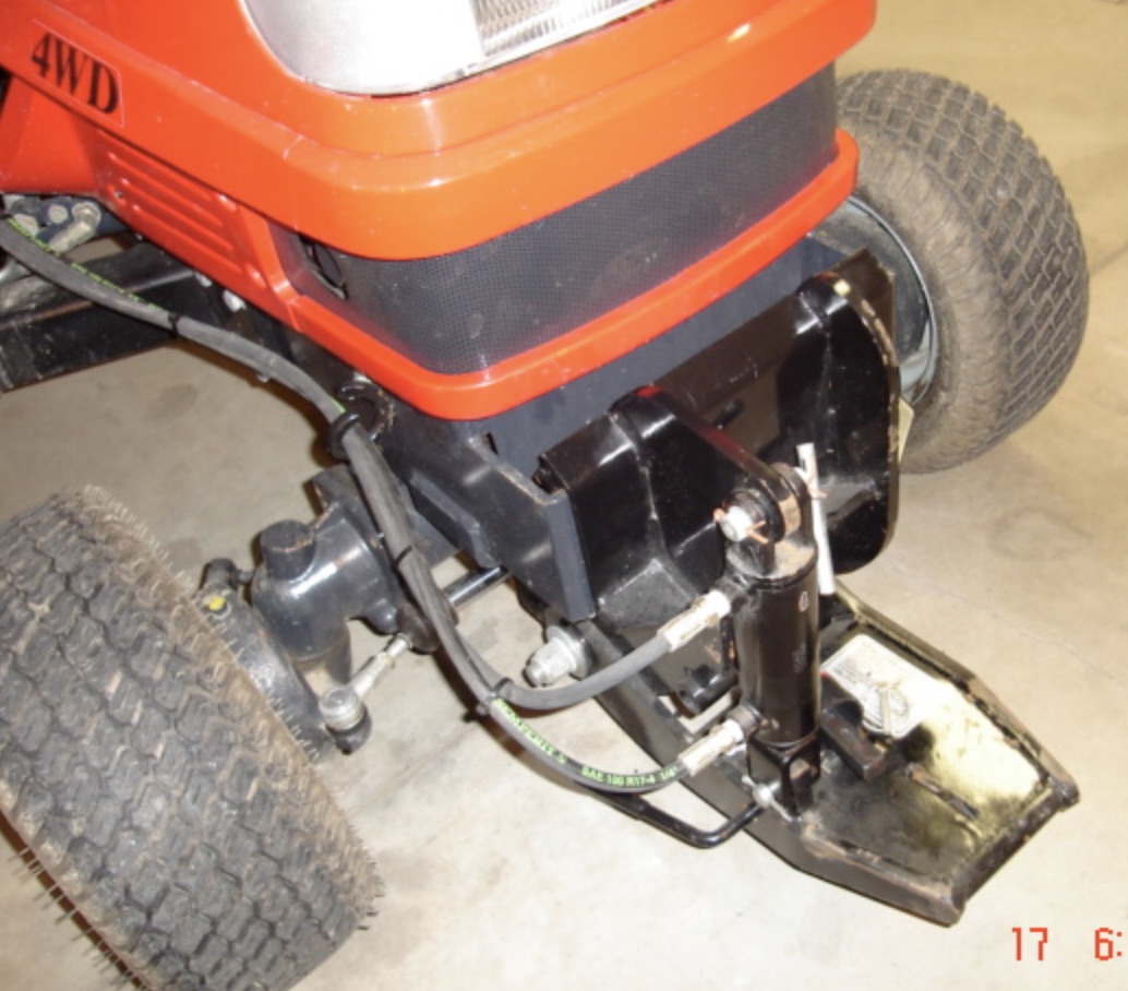

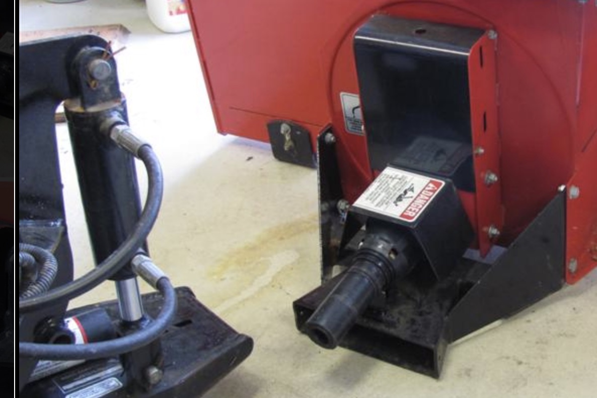

The mount is referred to as the Quick-Hitch subframe. It has a lift cylinder, hoses and a mid PTO shaft.
Looks like this:Q-Hitch.jpg
Front implements, Snow blower, Rotary Broom, Blade all have a female receiver:
I got the sub frame, minus the mid PTO Shaft, when I bought my MF 2330 Rotary Broom
The Mid PTO Shaft was a bit difficult to locate at the time. (I was able to order it from Jack's Small Engines)
The same Canadian company makes the Subframe, Snow Blowers, and Rotary Brooms for Red, Orange, and Blue tractors.

All are 50" snow blowers and are interchangeable tho I've been told there is a slight difference in Mid PTO rpm's and so the gearing of the chain driven augers are slightly different.
