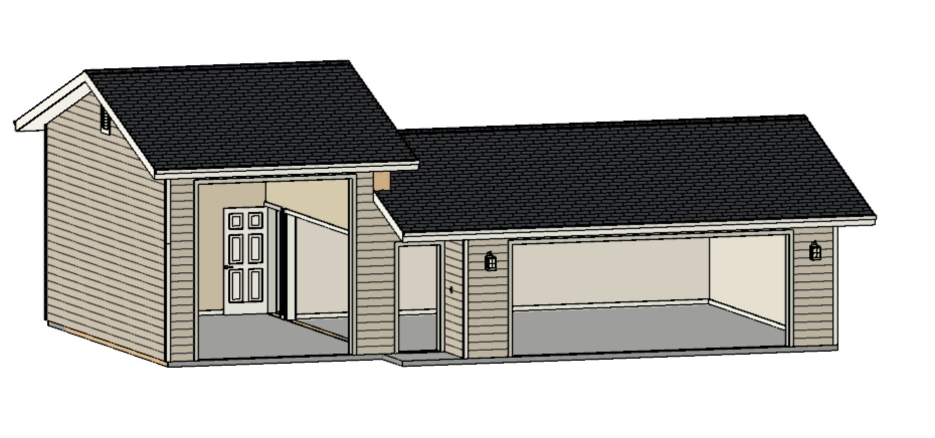

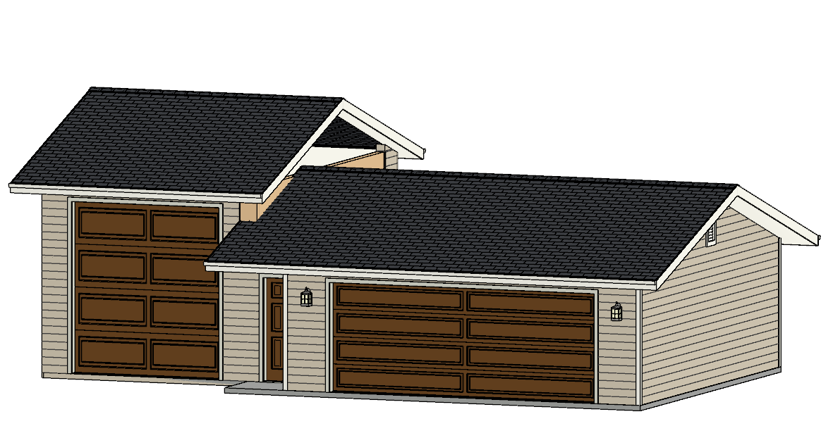

Thanks for your comments Eddie. The primary purpose of the shop is a metal/wood shop. Most of my equipment is on wheels but the hope is I can firm up some locations at least for some. I don't own an RV but thought the design should accommodate, maybe if I ever had to sell the place. Gives the next owner more options. Current new door is sized at 11ft high by 10ft wide.
The gantry is probably not required. Yes, there will be the need for about a four foot foundation/bulkhead on the 'house' side. I didn't think of turning the roof pitch 90deg. I think that is a great idea as it will block less sunlight on the front of the house. I will play around with that. Here are two 3D orthographic views with doors open and closed.

I like that more as it compliments the existing lines.

View attachment 507491 View attachment 507492
