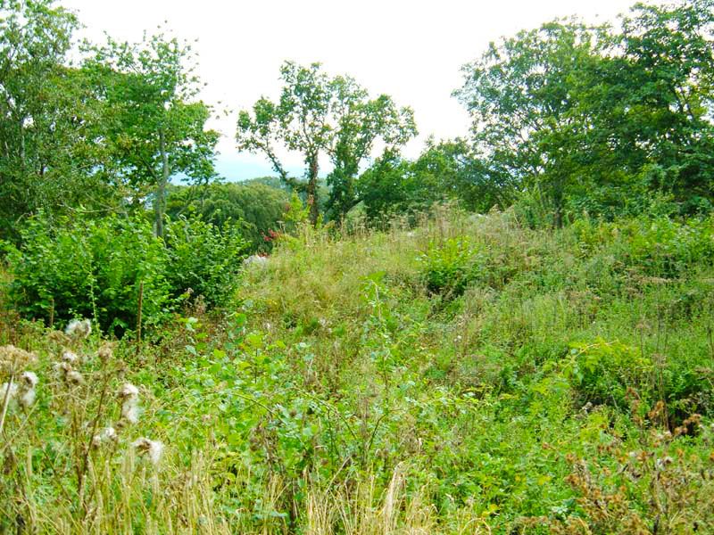

Hello all,
I've been trying to buy a few acres for a home site and pasture or hunting ground recently. I currently have a Kubota B2620
(20hp PTO) and am wondering how much of a chore it's going to be to get this area cleared using this small compact tractor. The picture below is a good indication of what the ground looks like, some areas are fairly clean while others are worse than the picture depicts. I would ideally like to take my time and work with what I have, which would be the tractor above and a 4ft rotary mower. This will be in the neighborhood of 17-20 acres to knock down. After the initial clean up it shouldn't be tough to keep things under control.
I know I can rent a skid steer with a front mounted mower if I need to for the first knockdown.
Let me know your thoughts.

I have a b2920. I would think you could do it. Do you have a front end loader? If so it would help to keep that low and lay the grass over some before mowing it. You will have to keep a very close eye on the temp gauge as the radiator screen plugs up fast on them. Other than that have some fun. I would opt for the skid steer with front mounted bush hog first if it was me. Time is money and that would be way faster.
/ Opinions Wanted - Brush Cutting #3
To me 17-20 acres is not " a few acres" as you opened with. Assuming you will be leaving the trees standing, I think you first need to see how many large rocks and stumps are hidden from view in the tall grass and brush. That could make a huge difference in what it will take.
/ Opinions Wanted - Brush Cutting #4
Around here that are services using skid steers with a heavy duty bushhog on front that will mow ground that grew trees while in the CRP set aside land. I guess they work by the hour. You might consider that option for the first time. It would be important they cut at the ground level so as not to leave stuff that would puncture your tractor tire.

Dillier23,
17-20 acres is a lot of ground to cover with a 4ft rotary cutter. Every acre is 43,000+ square feet. Assuming an average speed of 4MPH, you're looking at about 10 or 11 hours of mowing every time, assuming you don't have obstacles to negotiate that would slow you down. And 4MPH might be overestimating average mowing speed. It would jump to about 14 hours at 3MPH.

I will agree that 17-20 acres is a little more than a few. I'm strongly considering a 50hp compact and a 6' mower, this would drastically cut down my time and give me an excuse to buy a larger tractor with a much stronger loader. The B is a good little tractor, but I'd say 5-10 acres would be it's limit depending on it's usage.
I'll check on the skid steer rentals also, this may change my perspective based on cost to rent vs owning a tractor.

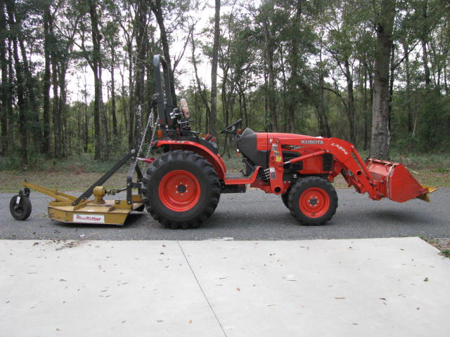

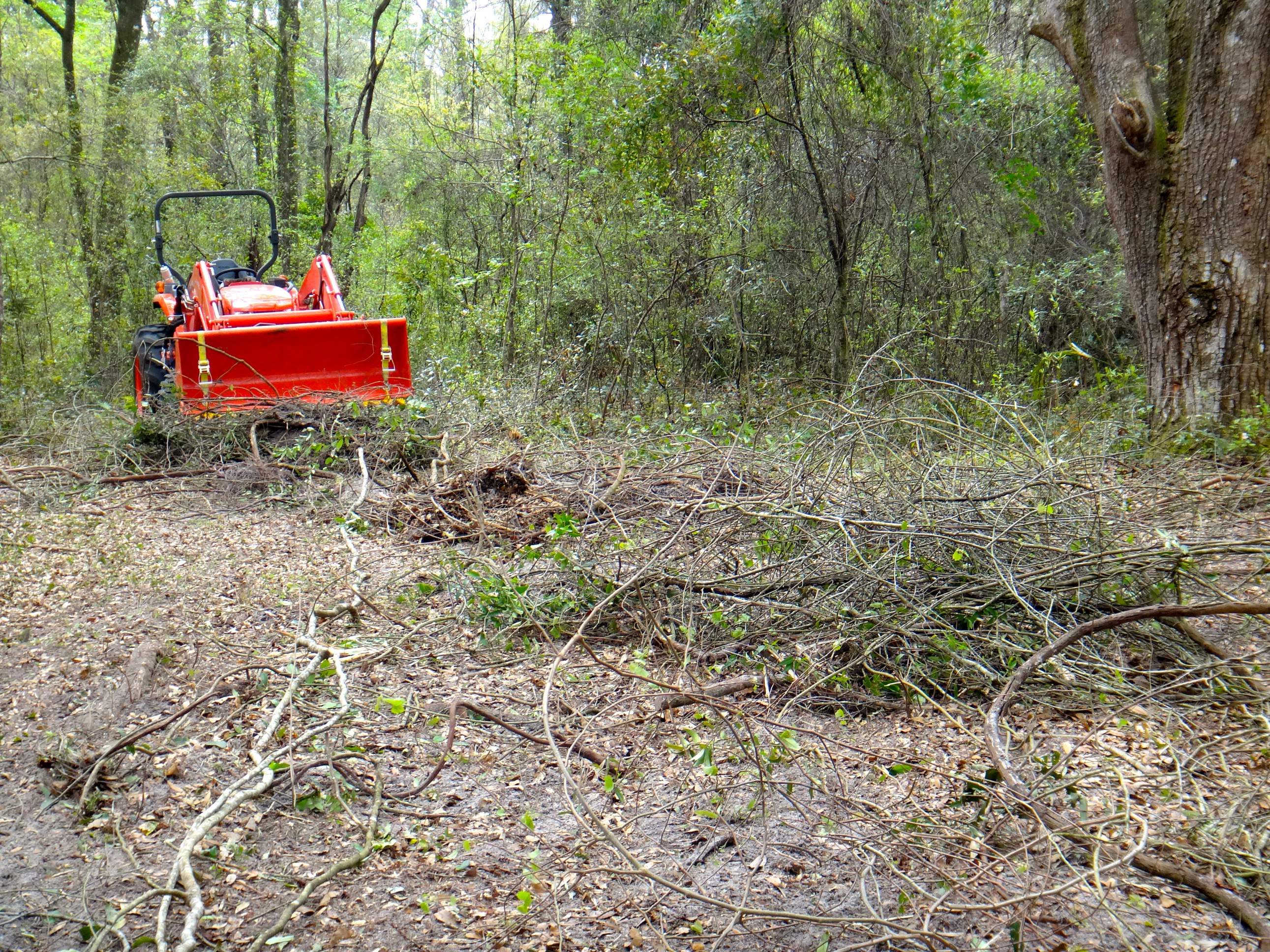

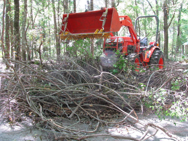

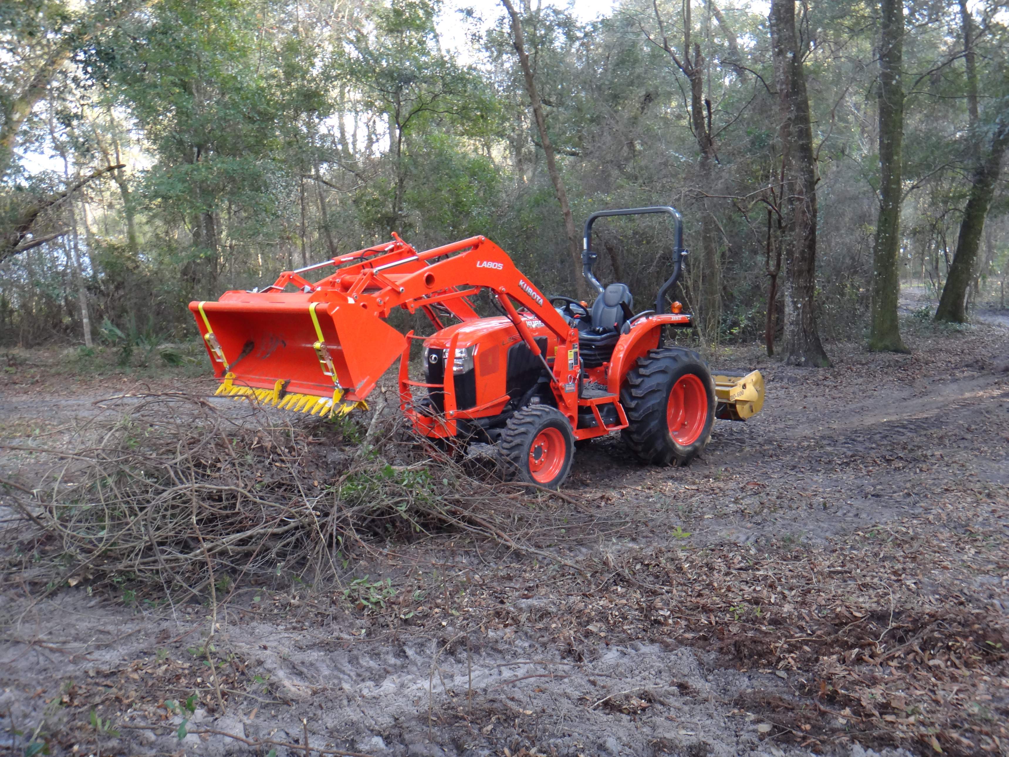

Our(combined property of brother in law and myself) 42 acres was overgrown worse than that when we bought it. He started out hiring a guy to cut about 20 acres of it as we had no tractor or equipment at the time. He ended up buying the mowing guy's 750 JD with 4 foot bush hog. It was slow going with the 750 but it got the job done. Several days of cutting but it was mostly in 1st gear due to the thick foliage and large saplings. The JD had turf tires so none of the low spots got mowed. I later bought a Vietnam rebuild Yanmar 4220 with 6 foot BH and that cut the mowing time down considerably and with the R1 tires and 4 WD I was able to mow all the swamps also. After we got all the trash weeds and swamp grass down, we got cows on it and they keep most of it grazed down. We mow about once a year now to control weeds that cows don't eat.
You should have no problem mowing that down with the Kubota. Just take your time and if there is a possibility of rocks or stumps, lower the FEL to about 4-6" above grade, go slow if you cant see the ground and get it done.
Don't worry about trying to get it all in one day or one weekend. Take several weekends if needed. I sure wouldn't rent any equipment when you have a perfectly capable machine setting there.
