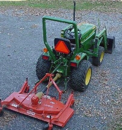

Definitely go with the chains. It would be much less chance of sliding on the drive. Once those tires get impacted with snow, traction is going to lessen dramatically. Not fun on a steep slope. Turfs will load up much faster then ag tires, but a wet snow would give you problems with either type...might just take longer with the ag tire. By the way, if you do go with turfs, look in to getting bar-turf tires. Much more aggressive then regular turfs, but still pretty easy on the lawn. The picture shows the bar turf tires.
