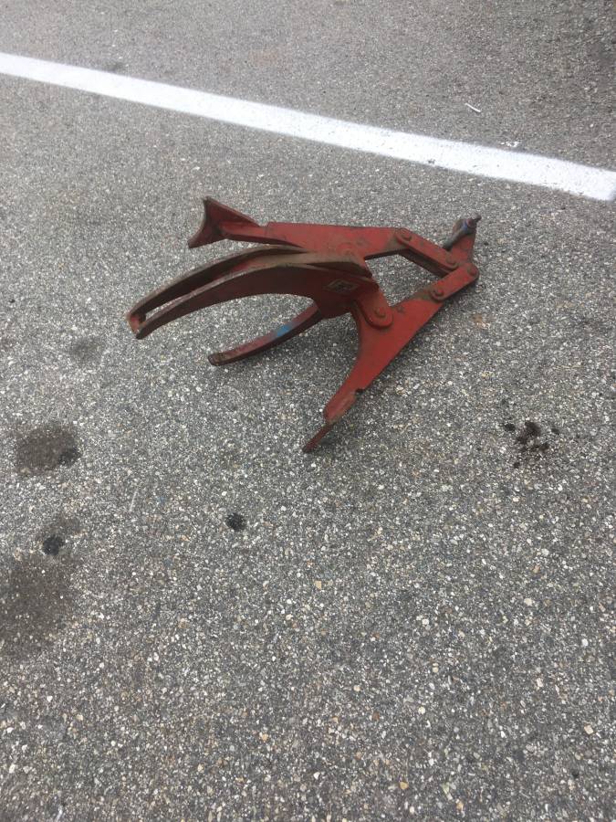

The 1430 has limited lift. For me I move dozens of trees a year. I use my grapple and if needed the log clamp on a chain hanging off my tow quick attach plate. For brush removal I generally start with my grapple. I get in and go throug the area tearing out the mess. Then I follow up with my brush mower.

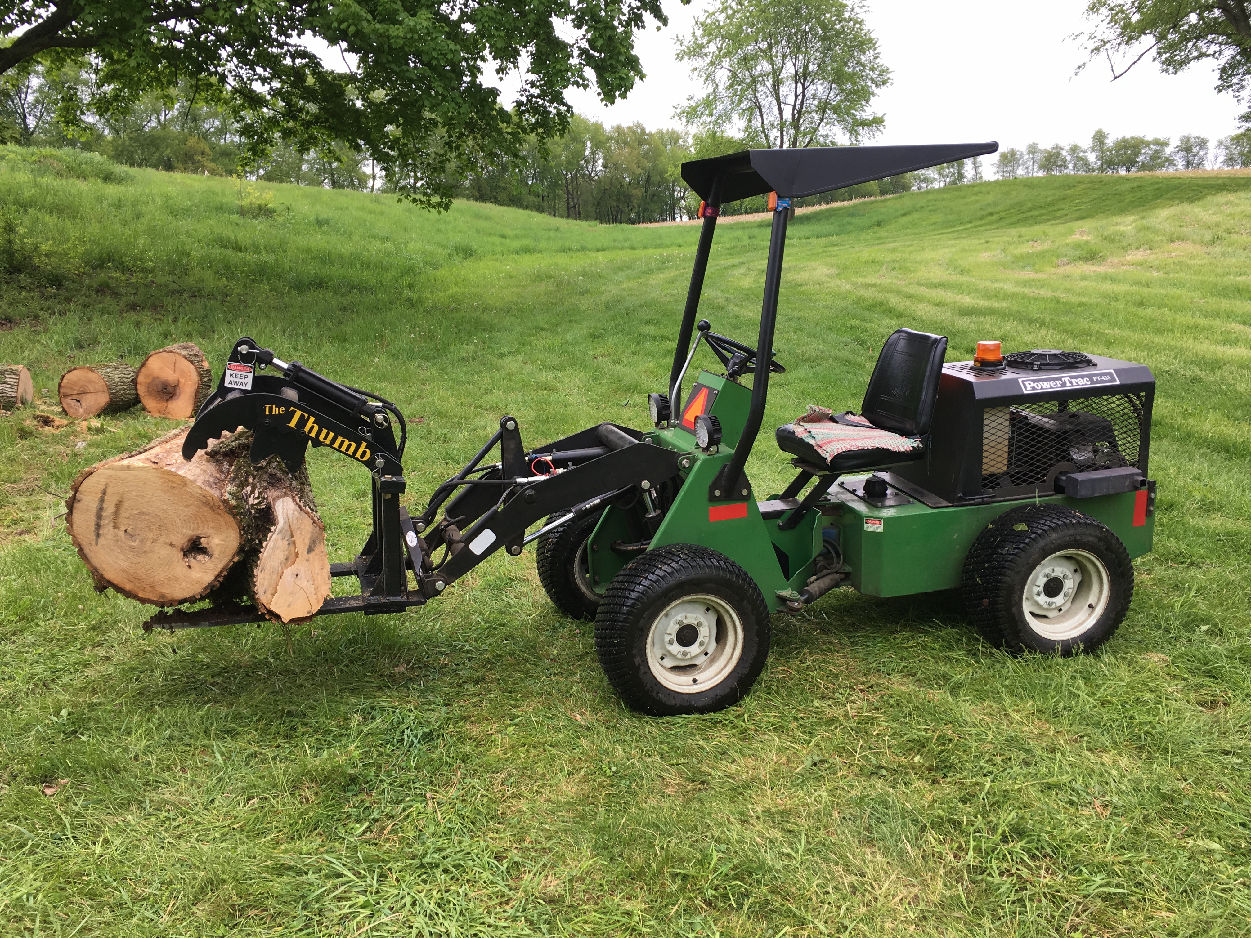

My little tractor lifting a big chunk of maple from this last summer. I like what MossRoad uses, logging tongs.
Over $3,000 for that log grapple you posted pictures of seems like a lot to me.

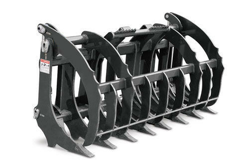

The hydraulic rotation on a log grapple is a very handy function for sure, but is not needed unless you are building boulder walls with it where precise placement is necessary. I have a jimmy rigged hydraulic log grapple on my PT. It is pretty easy to line it up from the driver seat by letting one tooth hit the ground and turning the steering wheel. The grapple will line itself up to the pile or log.
Moving the load further out from the machine naturally reduces the lift capacity, but most of the time your capacity will be limited to the pulling capacity of the machine, NOT the lifting capacity. Most of the load is dragging on the ground. For max capacity, PT 425 can drag an entire 40 foot tall, 12" diameter trunk tree thru the woods.
A key feature to look for in a log grapple is the serrated to portion under the attachment plate. This tooth portion is so you can hook the butt of a log under it then curl the grapple to lift the log completely off the ground. This make cutting up logs easier and allows you to stack brush much higher.
I also have a root grapple adapted to my PT. It is similar to this one: Best Rated 55 Inch Wicked Root Rake Grapple from Everything Attachments
It work quite well for removing brush and small trees in unfrozen ground. You can dig the teeth into the ground and remove the entire bush, roots and all.
