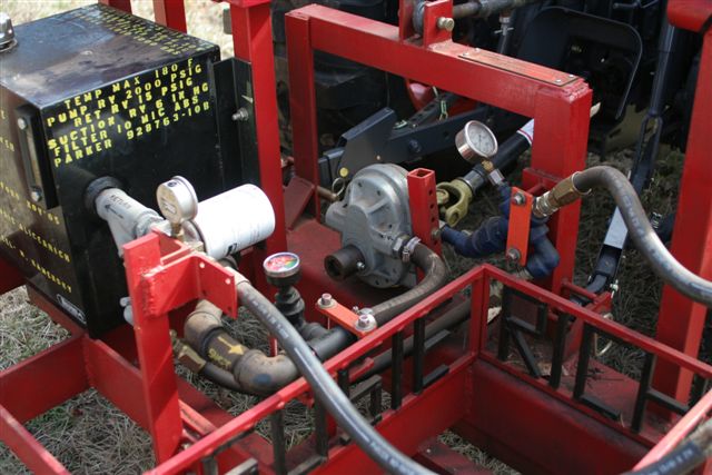

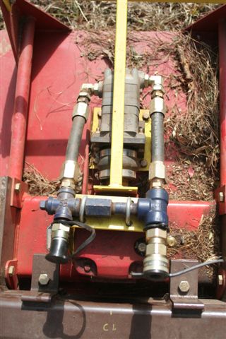

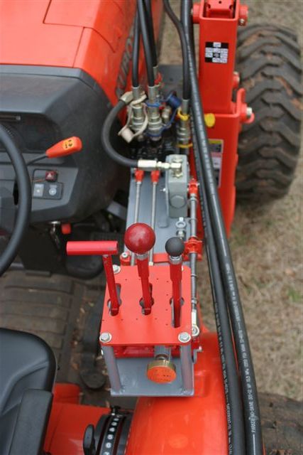

Attached are photos of a rig I built several years ago. It is a Prince 11gpm pto pump powering a Char-Lynn 4.9cu in/rev motor which drives a Bush Hog 48" Squealer rotary cutter mounted to the FEL of a Kubota L4330. I wanted to control the cutter with the pto clutch, just as if it had been connected by a driveshaft to the pto. This saved having to mount a separate motor valve at the operator's station with all the lines, plumbing etc. That spot is already pretty crowded as the third picture shows. So I ran the pump/reservoir lines directly to the motor. To address the overunning problem Kim mentions, I inserted a check valve into the circuit at the motor. The check valve is shown in the second picture. The only disadvantage is that the motor can't be reversed, but neither could the mower when driven directly from the pto.
I like the idea of the check valve. It would work for my project because there is no need to reverse the motor. Thanks
