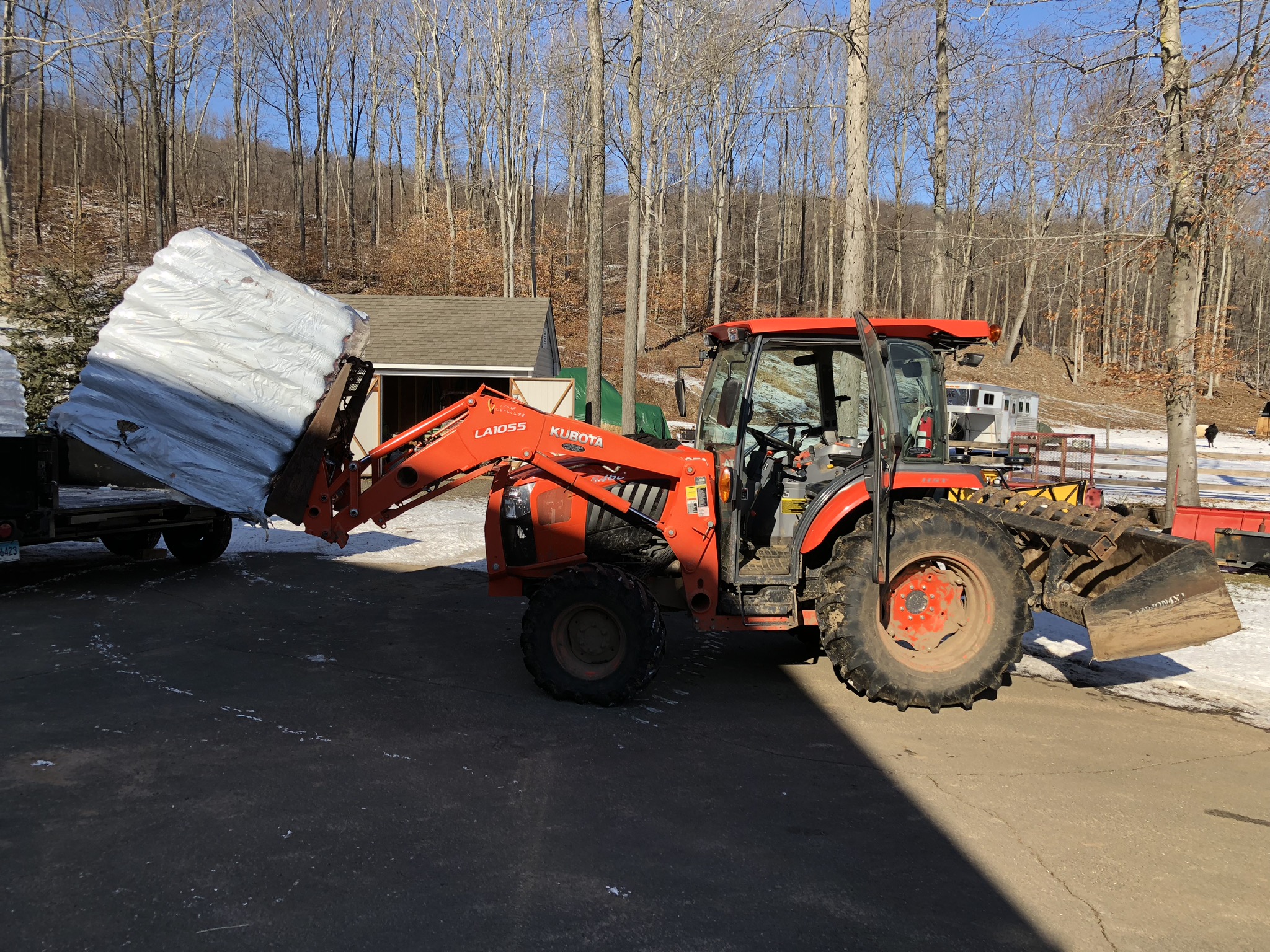

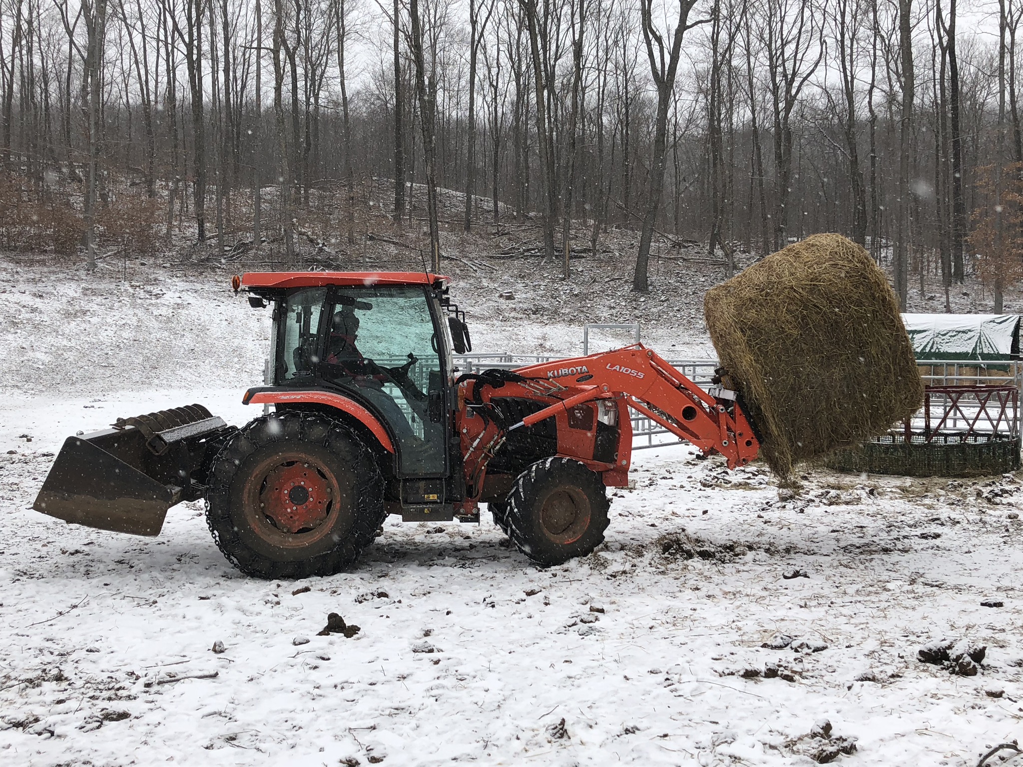

Hi Wobblin. I picked up a low hour used 5460 cab this year from Marshall Machinery in PA. It replaced a Kubota 5240 cab. I speced it with R1s (loaded rears), front and rear hydraulics, work lights, rear defog and wiper and radio. I replaced the front tires with Michelin XM27s for increased front load capacity. The loader is stronger than my 5240. Last week I picked up 2,000 pound pallets of wood pellets + the skid steer forks off a trailer in a straight lift before using any curl. The load was a couple feet high and could have gone higher with no problem. With 800 pounds tire loading and 1100 pounds of box blade on the 3 point the tractor was stable with this load. A few weeks before I unloaded 34 4x5 round bales off a trailer with no problem, although the top ones were right at the max loader height. The 5460 and 1055 loader shouldn't have any problem moving your round bales.
The hydrostatic tranny is fine and the hi/lo feature in each range is really useful. I have used the Deere twin pedal and Kubota treadle. Maybe its practice but I like the treadle better. The gear ratios seem changed as this tractor won't pull hills in high range as well as well as my 5240, no problem in medium or low range though. As others have reported the 60 series machines have some vulnerable hydraulic lines. I am in central CT so if you want to take a look or have any questions feel free to email me. Jim
