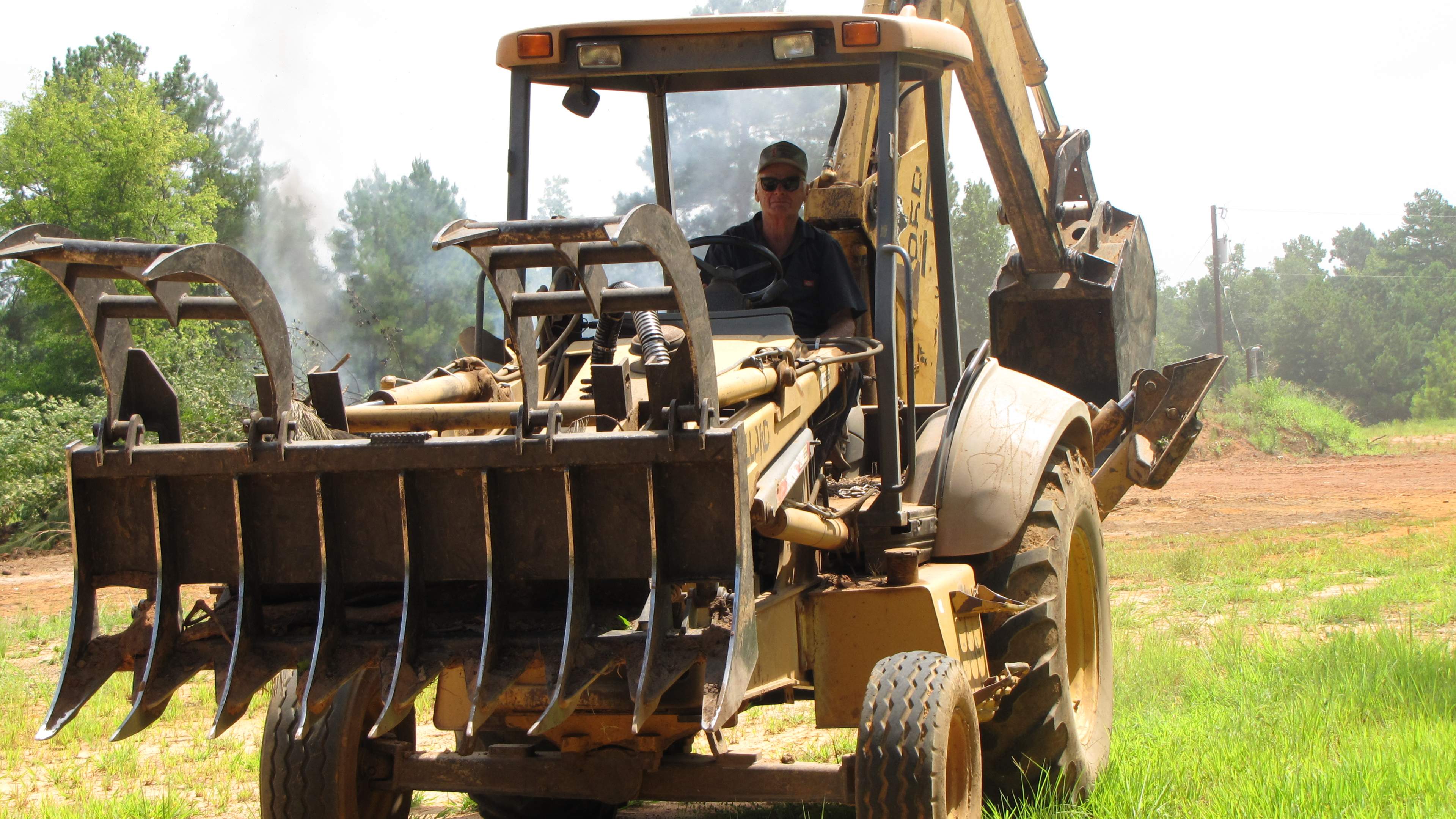

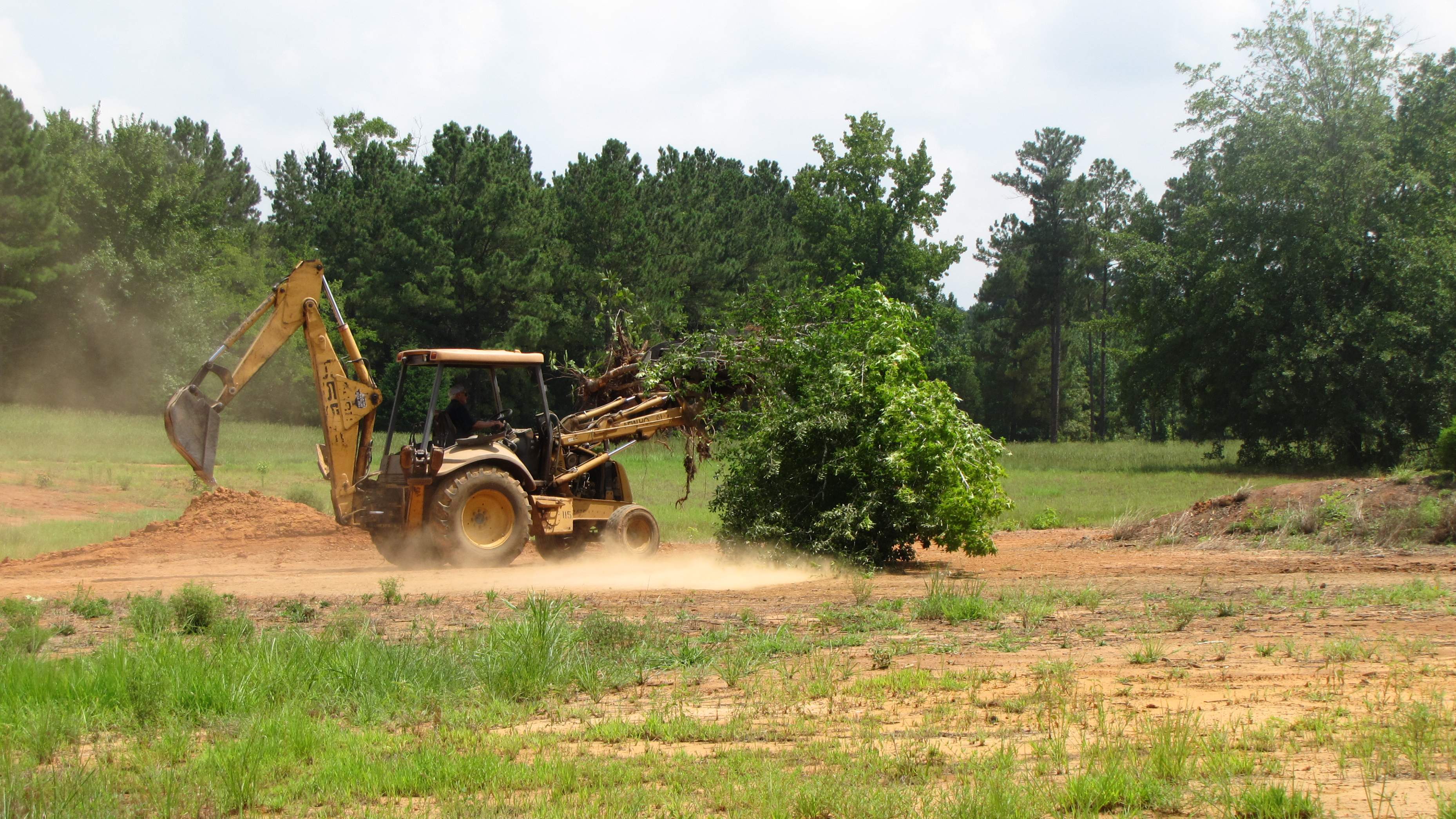

How big are these trees? Have you ever taken out a tree with a skid steer? I don't have a lot of hours on skid steers, but I have enough to know that they would be just about the last thing that I'd use to take out trees with.
The best, do anything tool out there is a full sized loader backhoe with a 4in1 front bucket, or the ablity to put a grapple on the front end. 4x4 is ideal if you can afford it, but I'm getting by with 2 wheel drive.
I can take out any sized tree with mine, then haul it to the burn pile with the grapple, or drag it, or drag parts of it. For the bigger stuff, I still have to use the chain saw to get it down to size, but with 80 hp, I can move some pretty good sized trees without cutting them up.
Getting them out is one thing, then getting them to the burn pile is the other thing. Being able to do both with one machine is why I think the full sized backoe is the best choice.
Good luck,
Eddie
