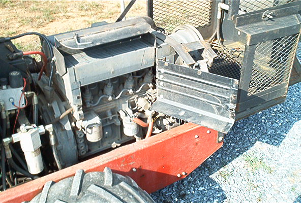

Interesting about the door. I have not done anything to mine yet. Why I find that interesting is that on my PT, there is a gasket around one of the oil lines on the right hand side (facing engine) that does not seal for a hill of beans, and also there are two serious air gaps around the #1 and #4 injectors. Meant to shove some Aluminum foil in there to see if I could block some of that air up...
Intrigued on your exhaust thoughts. I am tired of how loud it is, and am thinking of adding a second muffler (like off a motor bike) heading back then out just up higher...
But, I have to finish tracking my oil leaks. There are so many still...

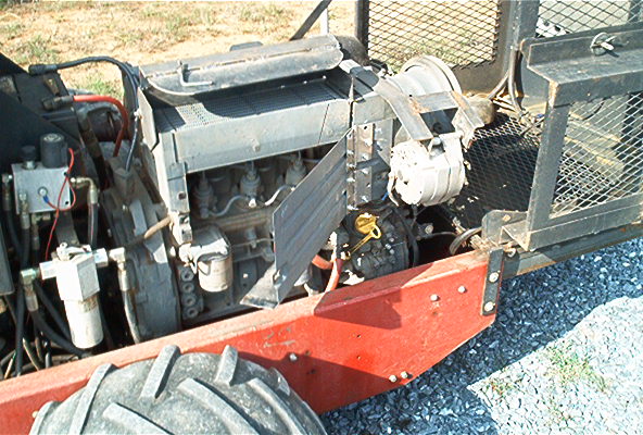

Got too dark tonight to get pics. But I got it hooked up. :D
Heres the parts:
NAPA part numbers.
Adaptor 4730
Filter Base 4764
Oil Cooler 1-4822
clamps (box) 505-1206
Hose H-1937
Fittings 10006B108
Price $150.00
I'll be back.

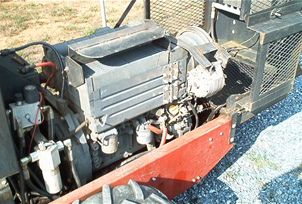

Tim,
The muffler being mounted inside the engine cover has it's advantages. I do a lot of work in brush and woods. An external exhaust would be getting hung up and probably damaged all the time. Also , if you mounted the muffler out side the cover, I think you would want some kind of heat shield for protection from burns caused by coming in contact with it.

Looks like its gonna work. So far, its running 10 degrees cooler, I bought the next siz bigger cooler, to sandwich them together, another 10 degrees, and we're there!.
NAPA pn 1-4823. $37.10
