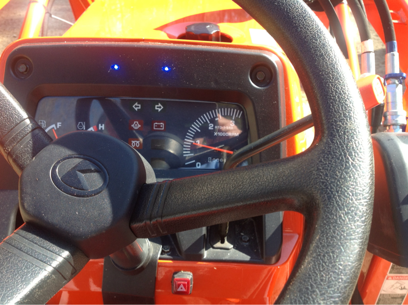

After a few time trying to go with the brakes on I added two blue LEDs, they help.
L2800 w/FEL - 72" Land Pride rake

My Ford 4610 did not have any indicator for P brake. It has a pull and rotate lever used to set brake. Once lever is rotated you step on brake pedal to set the brake. I added a micro switch to the pull lever, placed an automotive light bulb in the pill bottle. Then wired the circuit using a 552 flasher. I have to say it works pretty good.

I don't use my P brake too often. I too had a problem leaving it on while driving the tractor. I finally made a flashing warning light out of a pill bottle. It was to be a test. It works so good I never changed it out. That flashing light gets my attention.
Well I did it today and I even used the pill bottle. Lot better then a buzzer. I did screw up a little, I don't know what I was thinking of. I didn't hook into the key switch system and now it well flash with the engine shut off. Not sure if I well change tomorrow or wait awhile.
