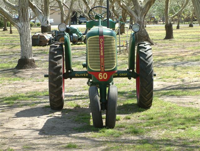

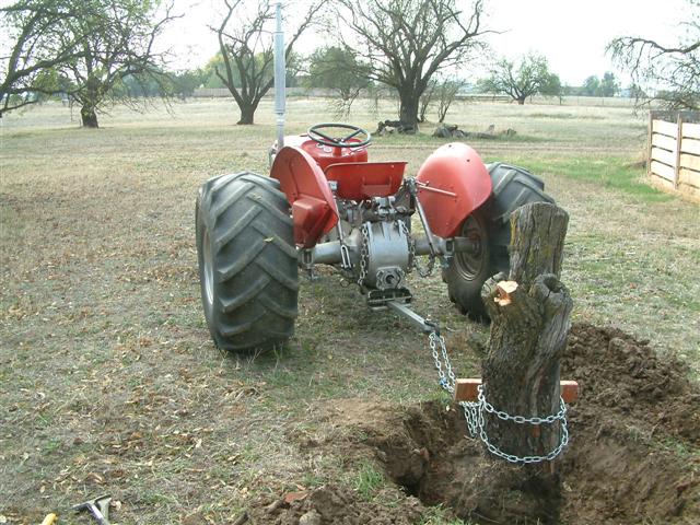

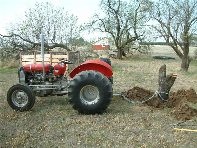

If you're puckered up because of the need to mow steep slopes, then you can make simple modifications to your tractor to help stabilize it. For example, my 1964 MF135 diesel has been modified to squat low for work in the olive orchards around here. The 28" dia rear rims have been replaced by 16" dia rims that are fitted with Goodrich 18.4-16A 6-ply rears that lower the rear axle to 20" above grade. Shortened front axle spindles are added to keep the tractor level. With this arrangement, the squat ratio (wheel track measured to the outside of the tire divided by height above grade of the centerline of the axle) is 4.15 (83" track, 20" axle height). By comparison, my 2008 Mahindra 5525 is set up like a typical field tractor and has 28" rear rims and a 2.84 squat ratio (71" track, 25" axle height).
If you have an older tractor like my 1945 Oliver 60 Row Crop, you have extra long rear axles and can widen the track quite a bit by moving the rear wheels to the ends of the axles. I've seen Ollies with axles at least a foot longer than the ones on mine.
Of course, another way to stabilize is rear duallies.
