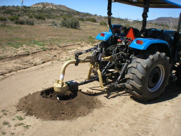

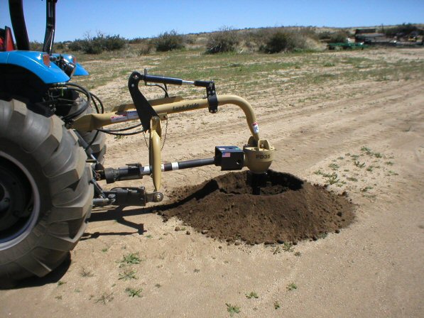

I don't have a cab on any of my tractors, :( but can't think of any good reasons that a cab would interfere with using a PHD.
As far as things to get, I would order the tractor with all 3 rear remotes, al least one of them with the float mode and the 3rd function remote for the grapple. Yes these cost a lot of money, but well worth it in the long run IMO.
Highly recommend Top and Tilt hydraulics for the 3pt hitch. You can make good use of the side Tilt cylinder when using the PHD to help make the auger plumb. I also highly recommend a down pressure kit for you PHD. This will pretty much take care of any difficult digging situations having to do with hard ground. ;)
