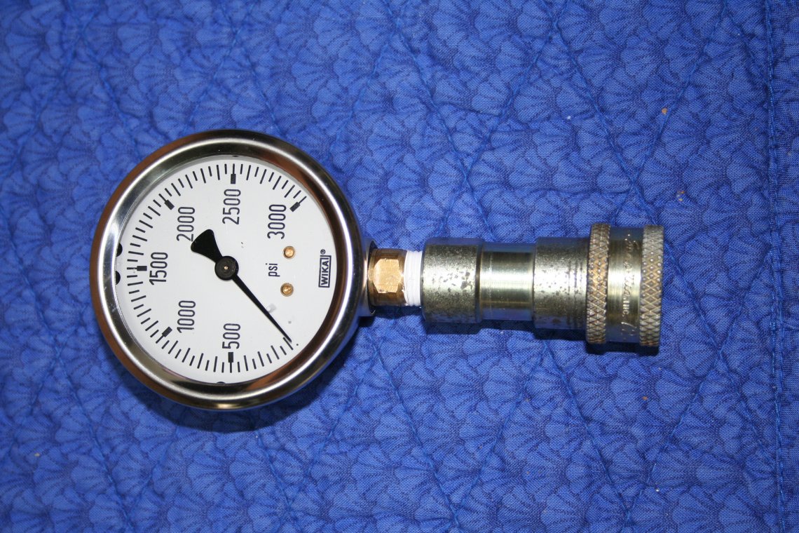

   / Open center deere 2040, leaked fluid out... #4
Make one of these and plug into one of your QD's or install a hyd opresssure in the IN port of the FEL valve.
Thanks JJ, unfortunately I have neither QDs or FEL. Hopefully running it low didn't damage anything else like the pump. I don't know if the pump is rebuildable but hopefully i wont need to do that. I guess I'll just put the new line on top it off and see if its as strong as before.
