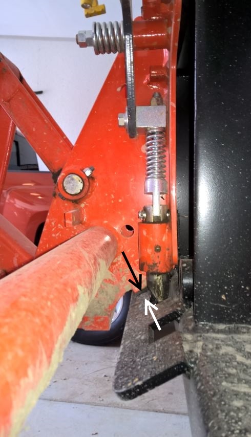

Using my front hoe on my L3901 and sometimes when pressure is applied to the digging bucket to pick up a rock using the bucket and thumb or digging a hole with bucket and the left side top attachment plate comes out of the slot. I'm considering having someone weld a piece of metal to make the slot "longer" to keep the attachment plate from coming off the SSQA plate but before doing so want to know if anyone else has actually experienced this themselves or know someone that has and has fixed it.

Seems like the top engagement couldn’t dislocate unless there is too much gap between the bottom angle faces. Did you try other attachments?

An extension can be added to the top bracket on the hoe. Another possibility is a shim added at the bottom. Both to close the gap.
Other attachments stay on

My tree grapple did disconnect last year and before I noticed it the rod between SSQA plates was bent which dealer fixed and all was well until I got another front hoe that doesn't pivot from side to side. I believe your right on track for my fix and this hoe may be a stretch for a tractor.

Pictures of too much gap at the bottom:

Good pics X!!!

Thanks, makes it easier for newbies and guys with no SSQA experience to understand the problem.
