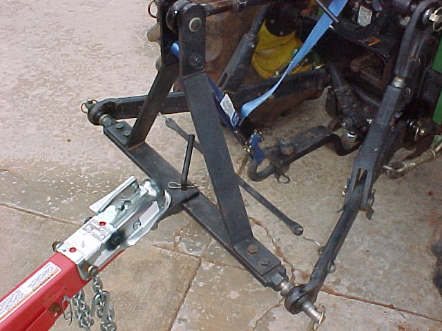

rmonio,
My drawbar is bolted, not pinned, so it doesn't swivel. That should not matter re: a safety chain....or strap. Today, I tried a nylon ratchet strap as a safety "chain" (picture attached). It worked just fine. A chain would probably be better if I raised the 3ph by mistake...maybe less likely to break than a nylon strap. But, for keeping the nose of a trailer down, the strap is plenty strong.

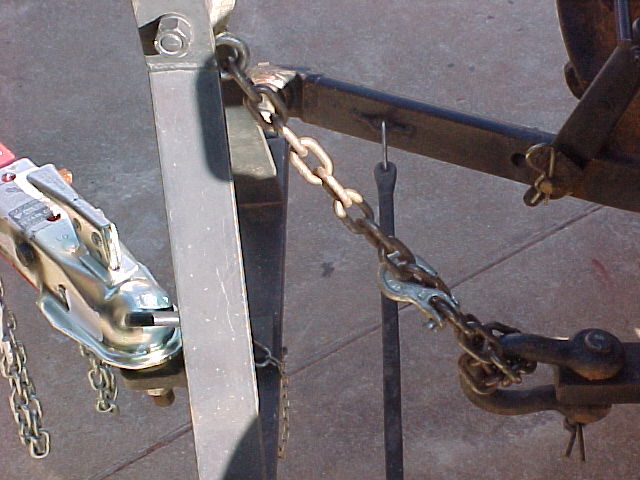

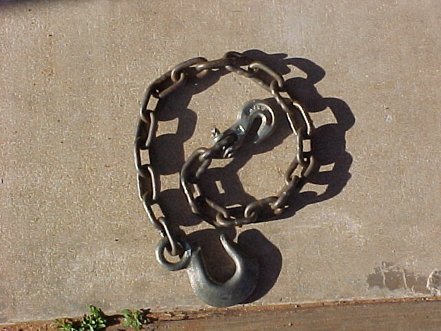

   / One More Time... 3-Pt Receiver Hitch Manufacturer #15
A short piece of chain with a hook at each end works as a real safety chain. One slip hook hooked on the 3ph hitch frame and a grab hook wrapped around the draw bar to adjust the chain to the desired length.

   / One More Time... 3-Pt Receiver Hitch Manufacturer #16
With the chain in place, the towed item can't raise up it's front end and cause trouble. This is my version of the Bad River safety chain. No longer will my pesky garden trailer rear up when full of dirt. Everything else I tow will be behavin' better now, too. Thanks for the Bad River lead!!!
